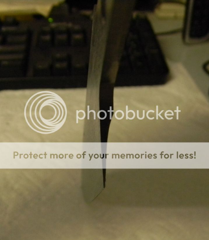

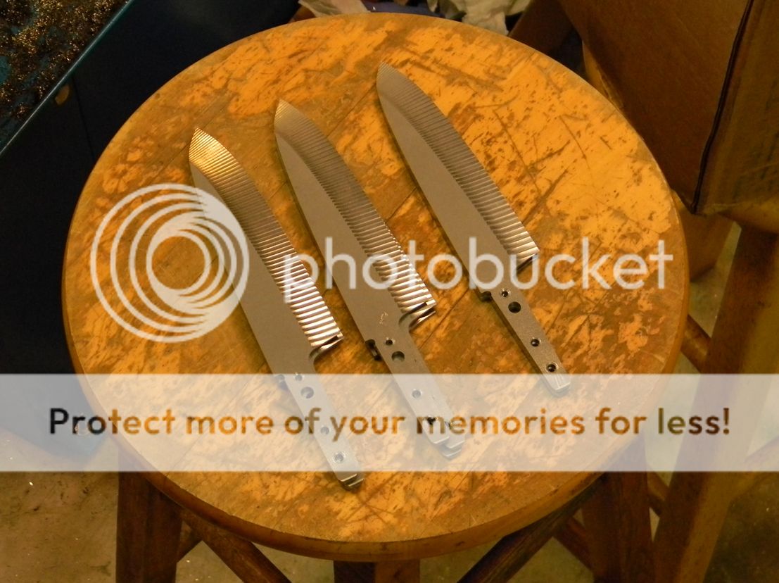

Okay, so here's what I figured out. A short bevel and steep hollow grind like I was talking about does indeed pop the potato off pretty well, but it cuts with too much binding and drag. I made a couple prototypes and settled on a parabolic grind that is fairly flat towards the edge and ends a little higher than I originally planned with the curvature ending around that of a 6" grind. I ended up varying the grind height and curvature a little so it was more conventional at the tip where you make most of your slicing cuts and more abrupt toward the heel.
potato.jpg~original
I laid the blade over on its side to mill the parabola which leaves a scallop from the cut. For the first prototype (which I didn't even harden) I just left them in there and I think the scallops helped the food release so I decided to leave them in there as a design element, but reduce the step over towards the tip to reduce problems in slicing cuts.
Per you guys suggestion I left it a little tip heavy. I put the center of balance at the point between your index finger and thumb when held in a pinch grip (once the handle is installed). I dropped the edge a bit for clearance to a cutting board.
So, anyway, that's what I came up with. We've been using the prototype in the kitchen a lot this week and I felt it was ready for a short run of a few to get some out there.

Overall I think for sticky stuff like taters and cheese, a short single-beveled blade makes a great deal of sense. Probably thicker than normal, simply for stiffness. "Fancy" grind or not... there's simply less surface area for sticky stuff to get stuck to.
Here's a better shot of the actual parabolic grind

It's less drastic than where I started
The idea is the short bevel and pronounced hollow at the top of it kicks the food off without the poor cutting characteristics of a short hollow grind.
