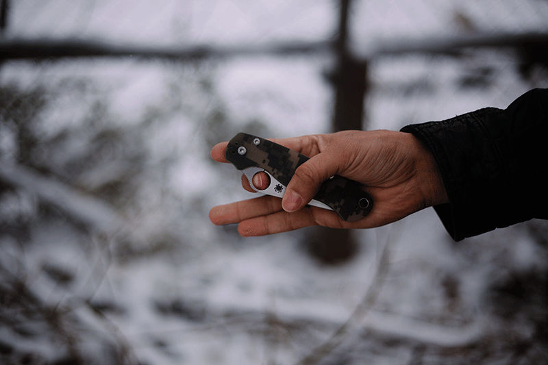

I picked up my first PM2 yesterday, and I'm extremely pleased with it.
It's actually kind of funny, I was disappointed yesterday when I was unable to flick it open. I figured it was because the pivot was too tight, and it wasn't possible to have a flick-able PM2 with no blade play (mine is absolutely rock solid). I picked the knife up just now to take the pic below, and try flicking it one more time. Flicked it open 3 times in a row, no problem at all. I guess I wasn't using the right technique previously, as this is only my 2nd Spyderco (Gayle Bradley was my first).
At any rate, I absolutely love this knife. Build quality is exceptional (whoever said the G-10 feels cheap is wildly mistaken).
Yeah, the Spyderco flick is different than opening with a thumb stud or flipper. You gotta use your fingernail instead of the pad of your finger.
Now you've got to try to see how many different ways you can open it. I can do ten. ;D
