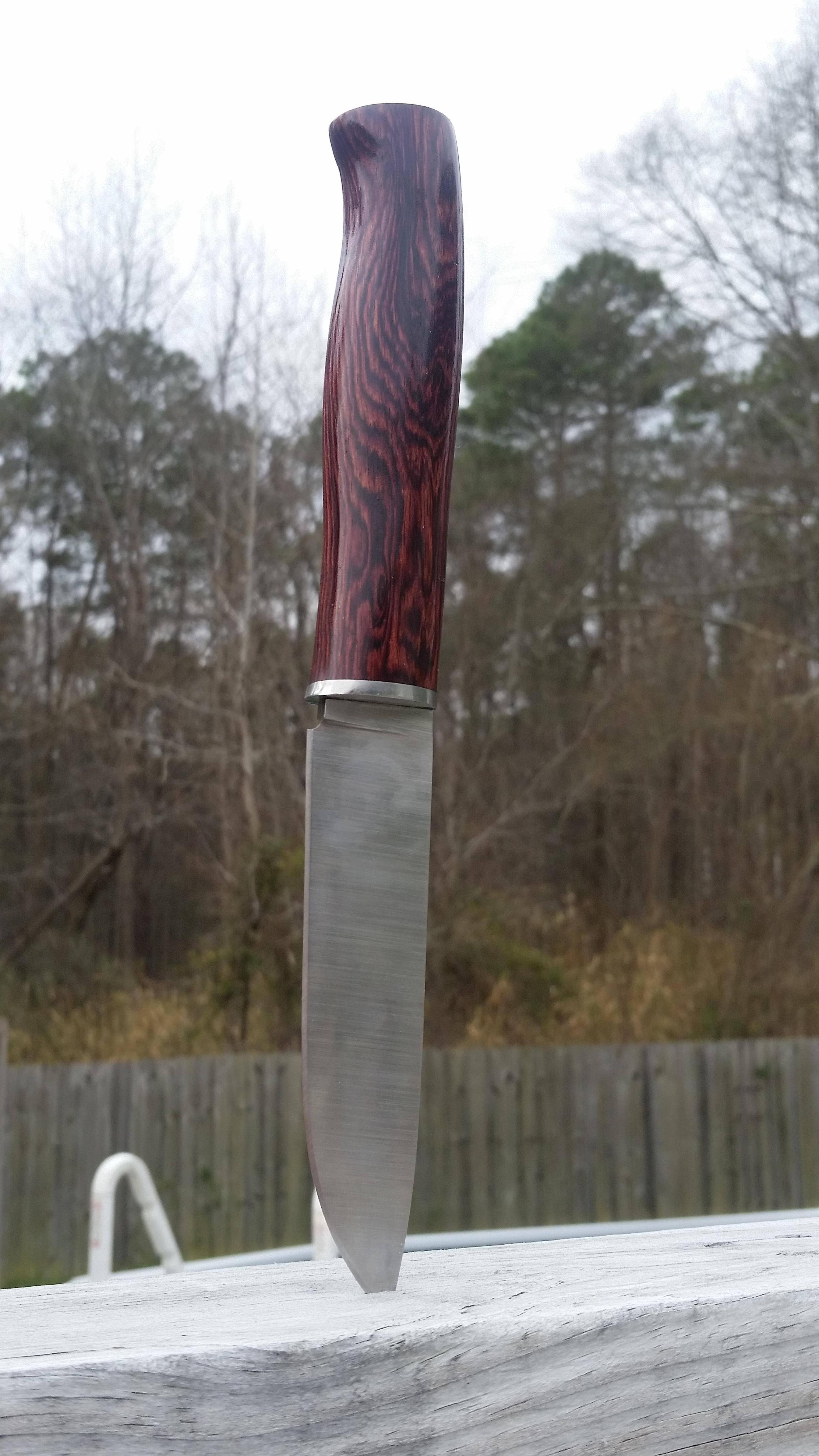

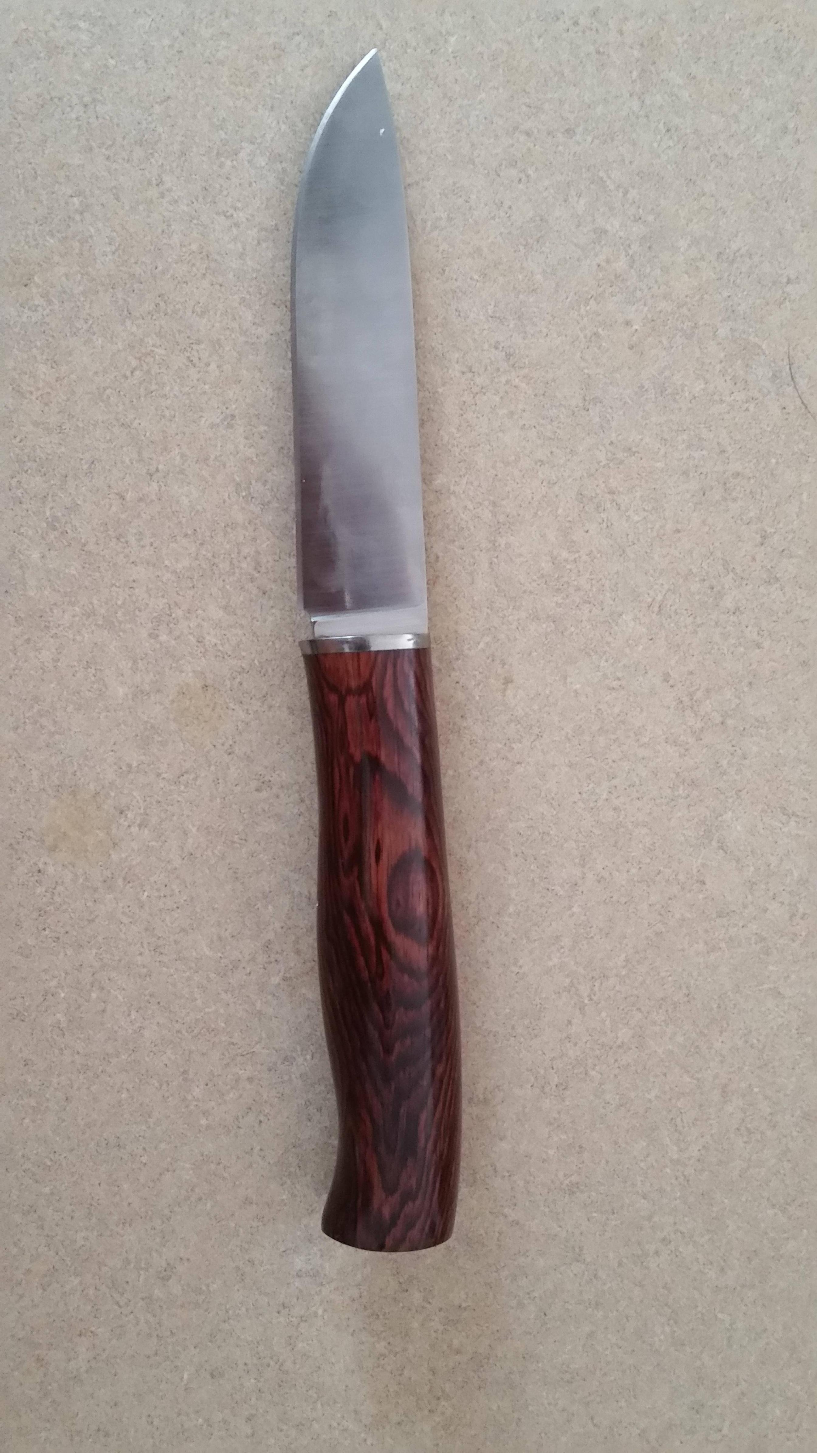

Here the one that had the end grain blackwood. Now it has a piece of beautiful kingwood on it.

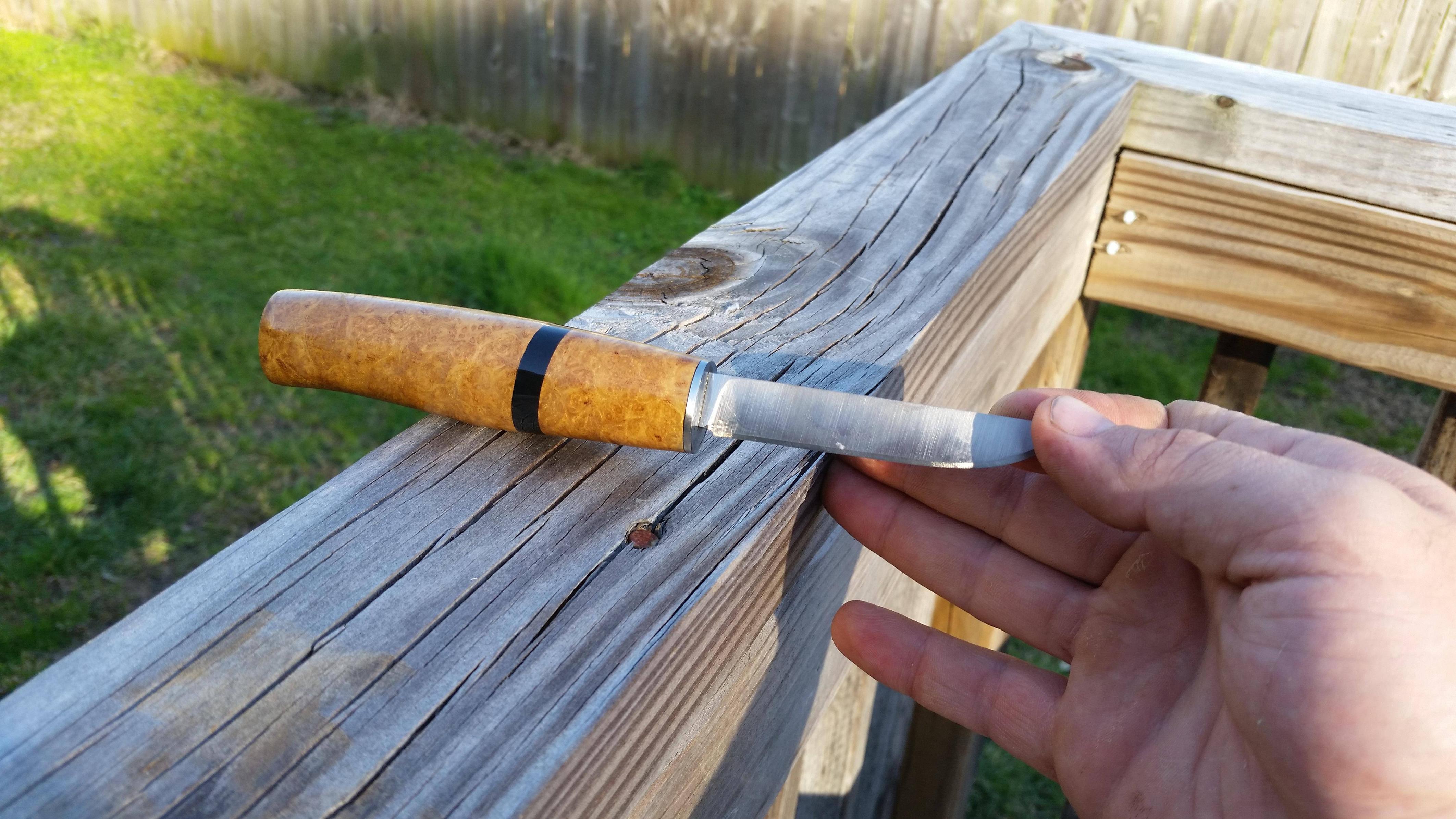

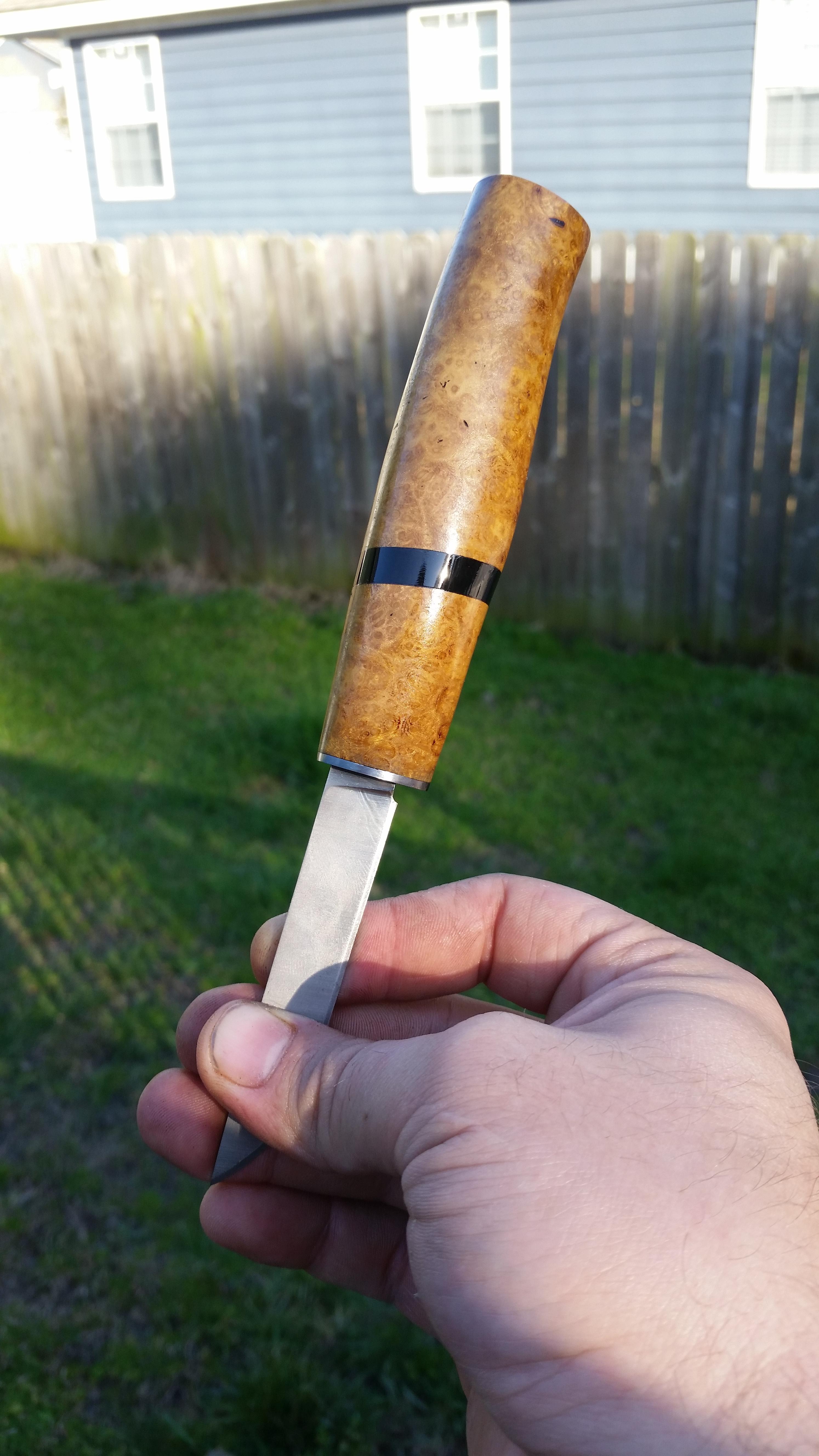

And the one that had the oak crotch with all the cracks in it now has a nice piece of maple burl on it and a shorter blade. I turned it into a little slicer puuko.

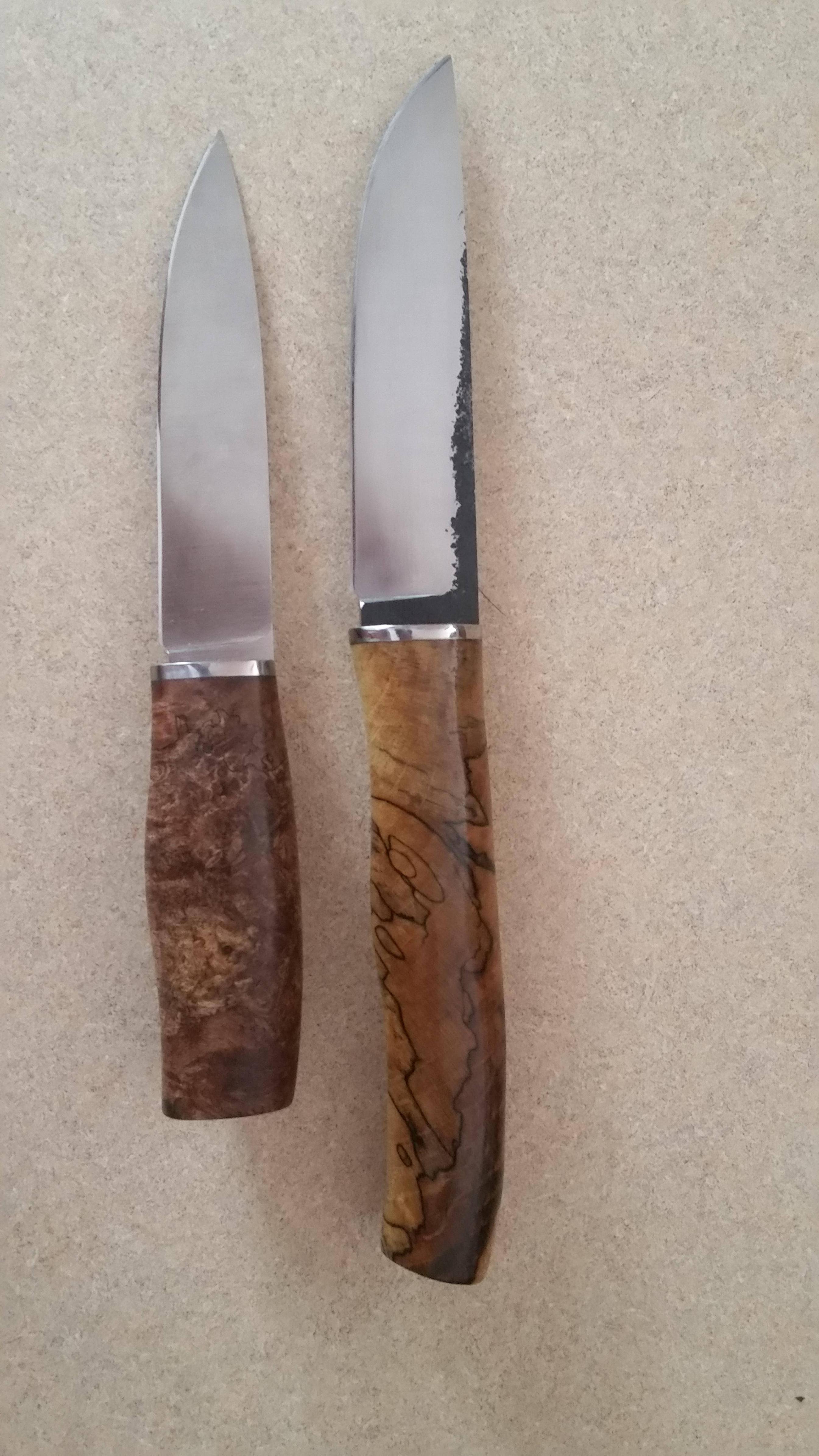

Here's the rex 121 blade that had the piece of spalted maple on it. It has a black locust burl handle with a black G10 spacer and two hidden 3/16" carbon fiber rods on both sides of the tang running from just behind the guard, through the G10, and into the handle for almost 1.5 inches. I left the handle thicker all the way around to keep the strength up. The tang itself runs into the G10 spacer and has system three structural epoxy holding it together.
I'm contemplating running a 3/16" stainless rod through the butt and peening it into a nickel silver butt cap. It might be more than necessary. What do you guys think?
It's pretty hard to figure out what to do with a really small blade like this and keep it aesthetically pleasing and strong at the same time. It fits my hand really well and cuts nicely but the blade looks a little disproportionate to the handle. And since I reused the guard it doesn't fit quite as nicely as what it did before. The spacer came out nicer than I was expecting, though.
Oh. And don't mind the oil on the blade. It's curing and I haven't cleaned the excess off yet.
How far past the G-10 does the tang go?
If it doesn't go at least 1/2-3/4" past, the G-10/burl joint may fail.
Just past the spacer. Maybe 1/6 of an inch or so. Not much. I knew it might be a problem and that's why I ran the two carbon fiber rods through the spacer on both sides of the tang and firmly into the meat of the handle. The rods run about 1" to 1.5" into the handle past the spacer (about where the black spots are in the photos). I also notched the rods and made sure the epoxy was settled nicely into the notches with no air bubbles prior to setting them. It was a really good fit, very little, and i mean very little, wiggle room when dry fitting it all together.
I have no worries about the joint failing considering what we talked about. It's probably stronger than the wood itself with the tang and two 3/16" carbon fiber rods running through it with some really good epoxy holding it together. I'm more worried about the unsupported wood behind the spacer failing based on the crap I just learned a lesson from. Hence the cautionary step of running the rod from the butt to the tang. I made the handle significantly thicker than the last and the wood isn't obviously cross grained. I'm just not quite sure of my skills in doing the work on the butt cap and reverse rod accurately without screwing it up. Rex 121 is fairly uncommon and don't want to bone it to hell.
