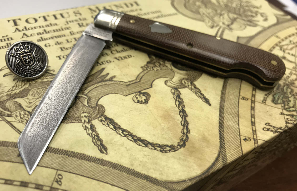

So what have you got to show? Here's my favorite: a Navy knife modified into a lambsfoot by @traumkommode

I’ve got a Navy knife inbound. What’s the best way to remove the bail? Does the original pin stay in place or is that added? Thanks for your help.

I've got another navy knife lambsfoot modified by @traumkommode:
As far as I know, you can just cut the bail and peen the leftover metal. That's what Andrew did to mine, I'm pretty sure.
I grind the end of the pin of on either side, because it's already peened. Then I grind it cut through the nail and pull rich side of. Then grind down the pin ends a little until they're nice and flat, then peen gently, then a Little more grinding and a hand sand to finish.
