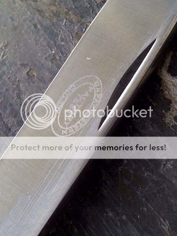

Anyhow, here is my newest carbon steel user after food prep work.
If you don't have the blade completely clean of oils and don't leave the food on the blade long its going to stay pretty clean. Mineral oil was the only thing on this blade.

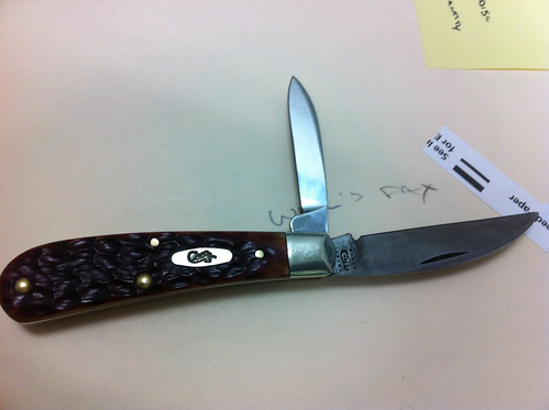

On the other hand here is a picture of my user Genuine Stag 73
This one was all 'natural'
Lots of food prep and always keeping the blade clean and dry.

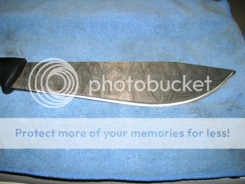

Its an older cell phone pic and I used a cheap phone app effect so its not really blue, but dark grays. I can't undo the effect or I would have.
I forced a patina on an Old Timer one time by leaving it in an onion overnight. Looks zebra striped. The bands of the onion are very visible. Generally, I would agree with what everyone has said. Use your knife for food and it will happen. Or stick it in an apple, potato, etc overnight and it will happen. If you don't WANT it to happen, then you gotta do something. Otherwise let nature take it's course. Or if you want to experiment with something fancy, go for it. I don't generally force patina, but I like the onioned Old Timer (it's pretty subtle and cool looking). I also did an Opinel with mustard and catsup in a pattern one time. Turned out well. Like Carl, I don't buy into the 'you gotta earn your patina' camp. I tend to agree with it nowadays because I like to be surprised, but I've done it both ways. Bottom line, it's your knife and you can always start over.
