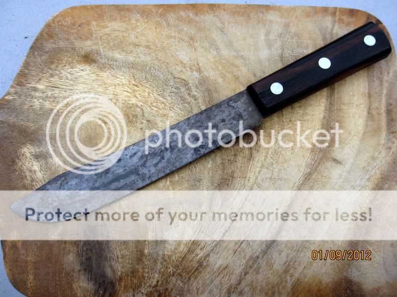

How does one force a patina on the "inside" of the backspring? That's the only part of the knife I am concerned about rusting, because I can't readily wipe it down...
