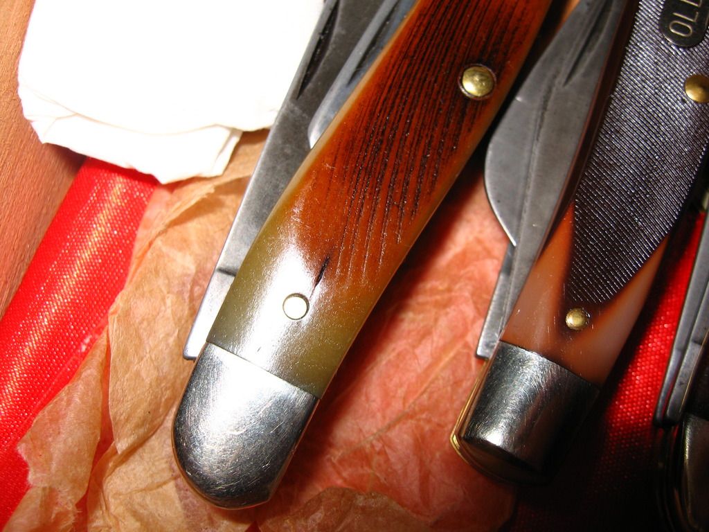

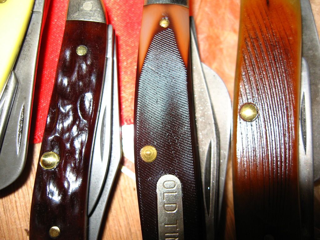

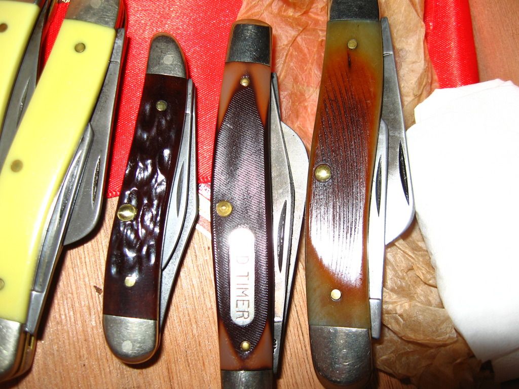

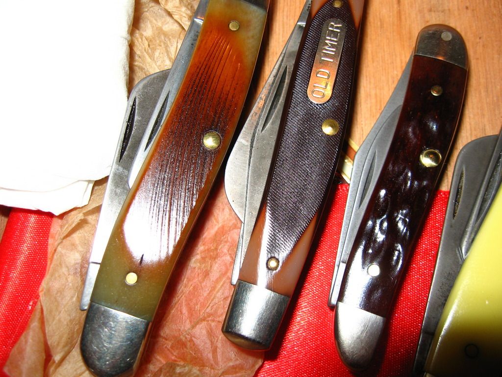

This one is a Delrin 1977 side by side with a 64-69 bone minitrapper
Hope it helps
So a way that I've been able to always tell if a case is SS or CV is by looking at the letter S in Case on the tang stamp. If the S is shaped like a lightning bolt, with straight lines, it means that it's stainless. If the S is normal, CV.
A bone is very different from delrin, pores will show up, and can be seen easily, or with a magnifying glass.
middle one is delrin
