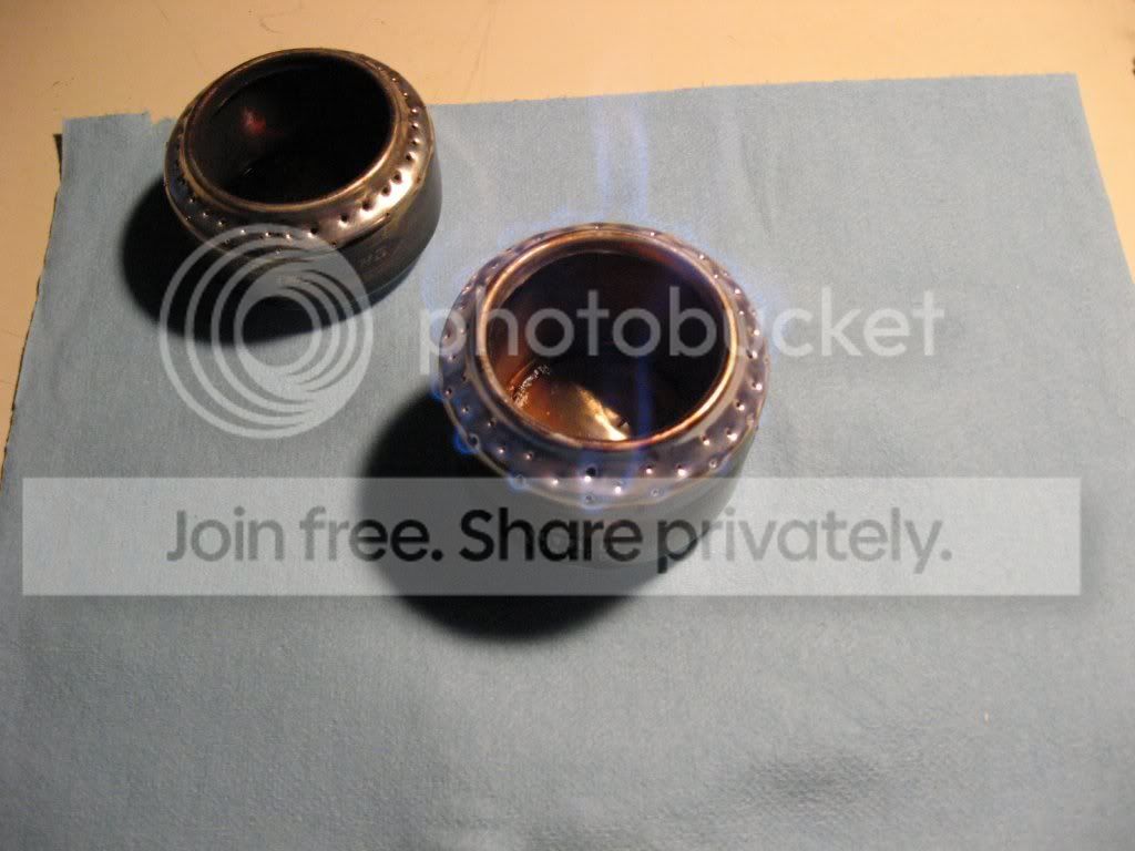

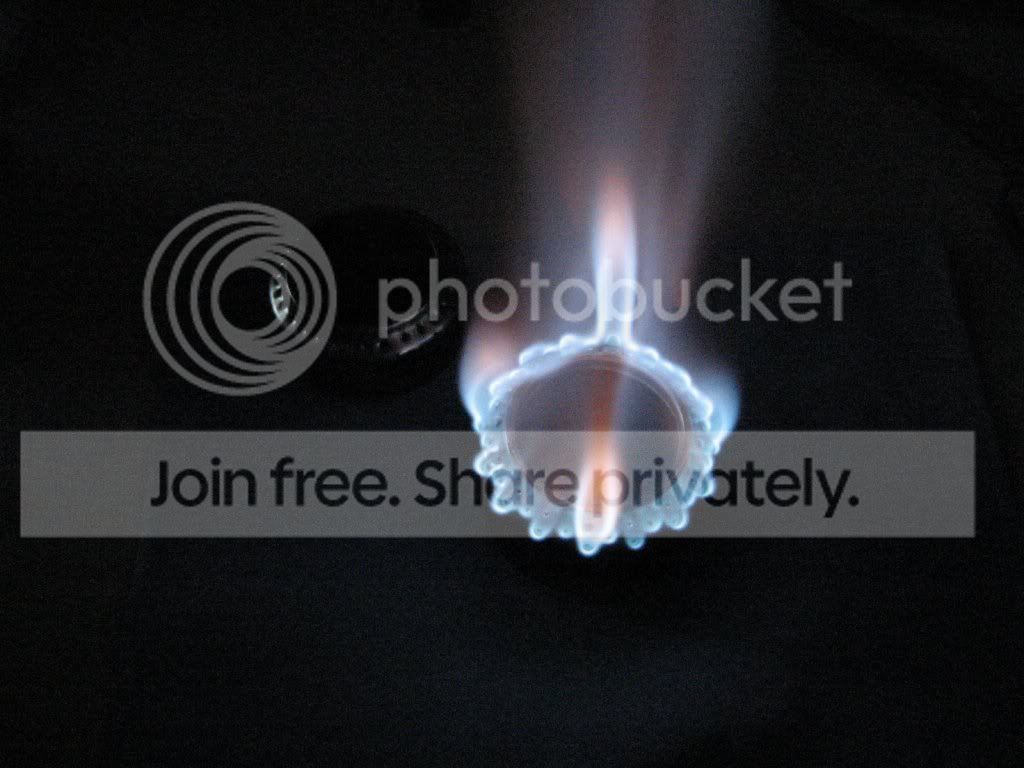

I did a test for a thread in another forum. THe question was: "What do you use for a base under an alcohol stove? Does there need to be a non-flammable, heat-resistant substrate?"
My tests were that nothing needs to be used. You can actually burn the stove in the palm of your hand right down until it goes out. Of course, this would be a silly thing to do - the slightest error could leave your hand or arm afire, causing a fire when you dropped the can - but I say only to illustrate how the acohol and manner of burn leaves the bottom of the can unaffected.
Here are two pics of the stove burning on a blue shop towel. No heat is transferred to the towel.
This is how I pre-heat: If you can, set a small, low-rimmed, metal dish under your stove. Pour in just a dab of alcohol - enough to over the bottom. Then set your loaded but unlit stove on top. Light the fuel in the lower tray. As it burns, it will pre-heat the stove and fuel, and will usually light the stove for you, too. The stove and fuel gets hot and the fuel turns to vapors which begin escaping through the holes around the rim. The flames from the tray below will usually light these.
