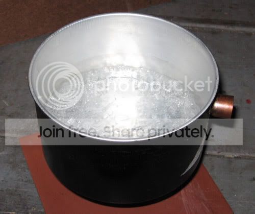

Got home and tested out the little stove with one of the wife's smallest pots and about two cups of water. Poured about three tablespoons of HEET in and lit the stove. Not long after lighting it heated up and lit the outside rim burners. Placed the pot on top and realized the wind was blowing more than I realized. found some pieces of a broken cinder block and priveded the stove with a little protection from the wind. Before the fuel gave out I had boiling water.

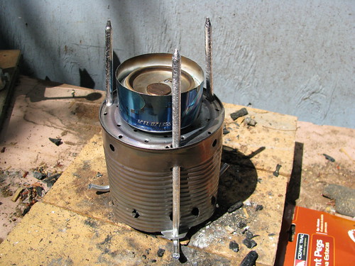

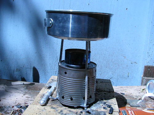

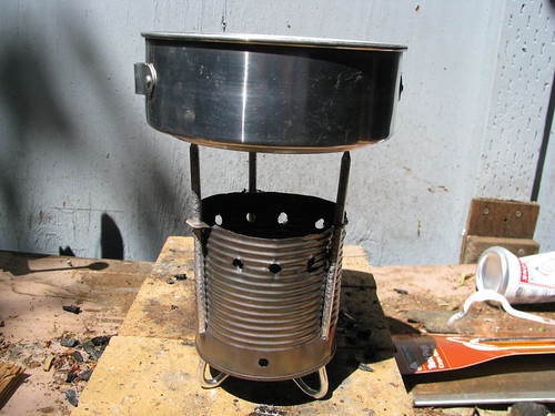

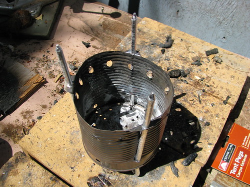

Alright, I finally finished mine. I built the penny stove and the hobo stove as outlined on this site http://www.csun.edu/~mjurey/pennywood.html .
I still need to get a proper 2qt. pot, which everything will nestle in.
The hobo stove also acts as a stand for the penny alcohol stove. Both work quite well I might add, made some smores with my wife over the hobo stove.
