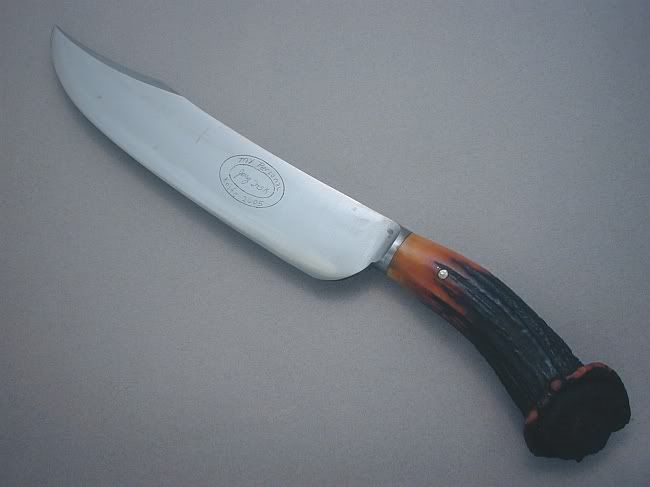

We did some cutting at Jerry's Micro Show last year using cutters from Lin Rhea, JR Cook and the Fisk beast below. As soon as I picked this one up there was no doubt what so ever what it had been made for. :eek:
Here's a cutter Jerry offered at the Show. Again quite a cutter.
Seems like those cutters would be highly effective and those are some nice ones shown. I especially like that Farr with the carved handle.

Always cool to see that beautiful Farr beast. :thumbup:

Thanks for the pictures guys! Roger that Farr knife and its fuller is really cool!
