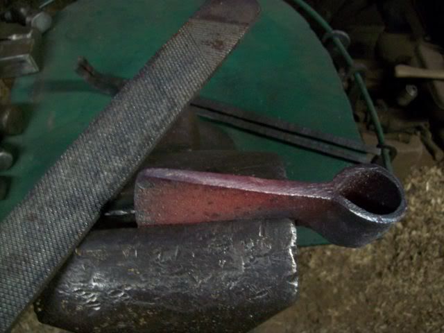

We do a lot of hawks for reenactors..Wrap and weld..This is how Phillip taught me to make period correct pieces..Use period correct tools :grumpy:..As you can guess, I dont make may of them..
