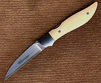

on this vintage Whitewing folder you'll notice there isn't a notch before the
edge

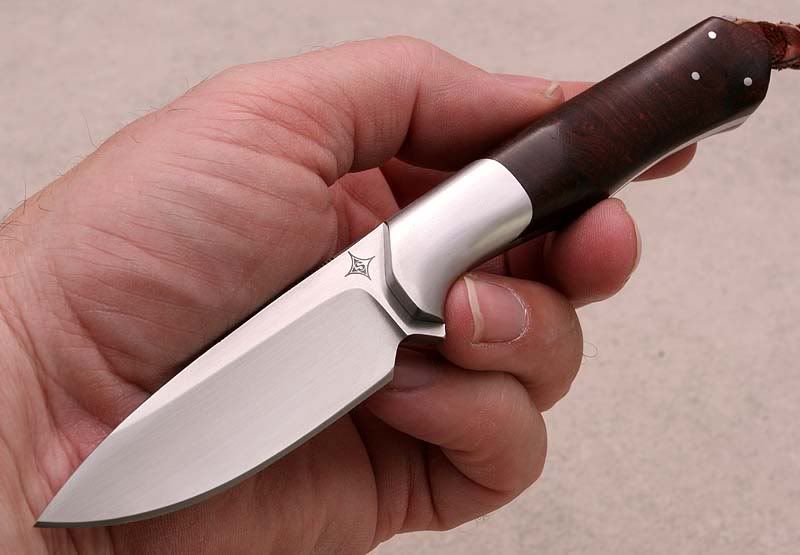

Scott Cook also puts in an angle before the edge, he use to work with CRK before
branching off on his own

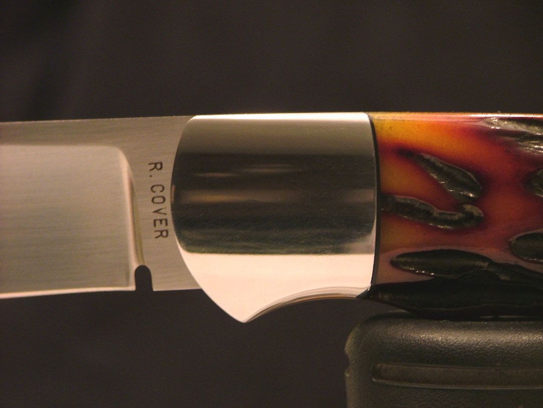

while a Ray Cover usually does have a pronouced ending;

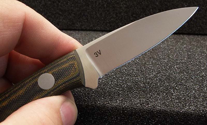

Here is an Ultimate Caper from our own Tom Krein, he usually has a notch there
before the edge, I asked if you would please not do so and he obliged no problem
AND he also is one of the few guys I know that grinds the blades down nice and
thin, if you want a sharp thin edged knife, check out Tom's stuff, great!!!

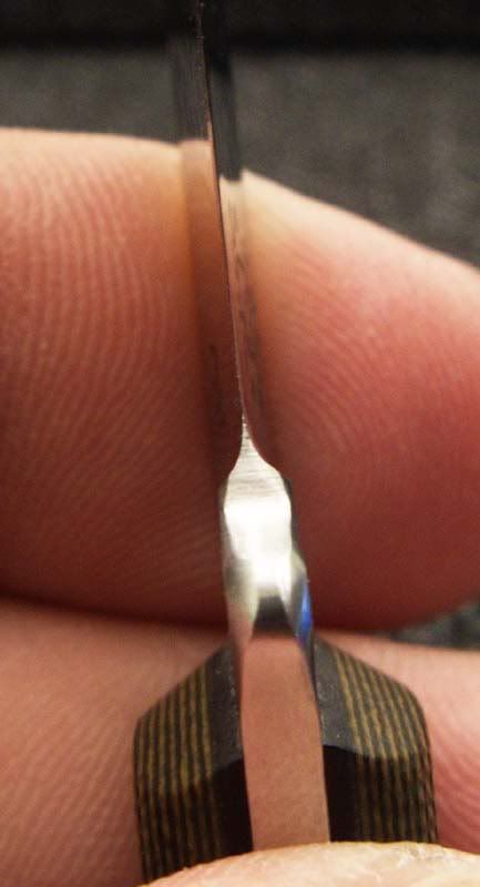

and as I say, ground down pretty thin, but then, this is CPM 3v so it can go fairly thin!

I agree on the logo side of things, the first knife pictured up there
the logo Whitewing while fancy script was way too large for the blade
I had a different style and hand sanded that off as best I could, looked
a lot better after that!

Well, that little Whitewing script is NOT disturbing... not to my eye anyway. It has some refrain to it, which is classy in it's own way. Alot of it has to fo with what the script says too. Now if that little Whitewing had written below it, on the blade, "Rhino Killer", well now............
Aye that would be more offensive :) and yes on that blade it wasn't overly
disturbing, but the other knife seemed more so, I guess that's why I didn't
sand that one down as I did the other one.

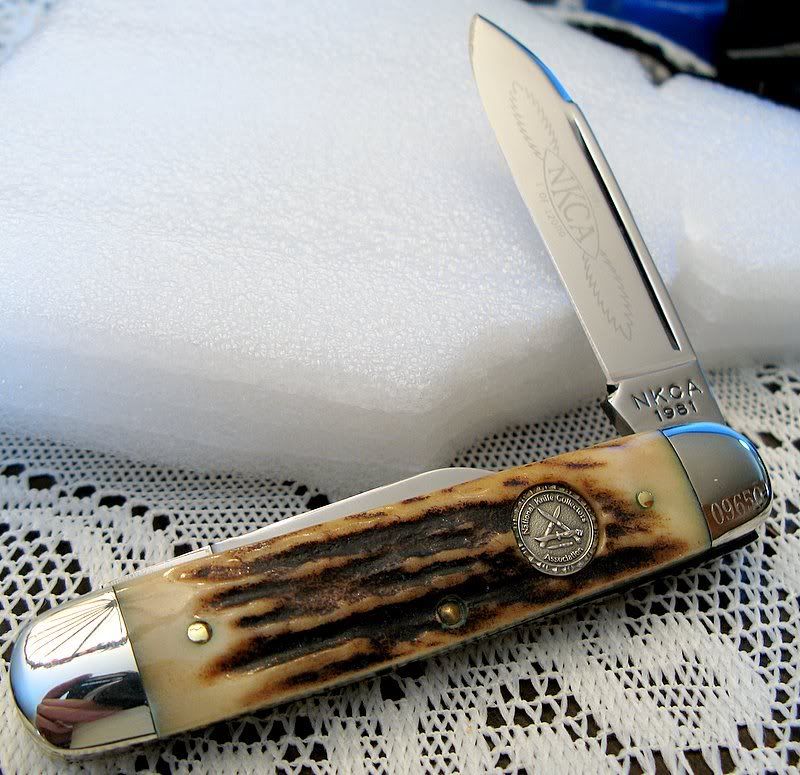

So-Lo, not having a guard is another smaller pet peeve but not a deal breaker, here's
my main edc lately, a 1981 slipjoint that was made for the National Knife Collectors Association, minimal notch on either blade, not a problem!

I actually prefer that choil notch. My pet peeve is not being able to get the knife sharp in that area when a notch is not there, so I prefer to have the notch there and that takes care of it. Nearly all knives have a small radius there, so sharpening right up to the plunge grind is not possible. Also, it does save the corners of my stone. I've not really noticed a problem with hanging up during cutting either. I prefer a notch that is not completely on the edge, but one that splits the grind and the edge, like in Gary's first notch pic. The Scott Cook model has a notch, its just huge and angled. The lack of this notch is not a deal breaker, so its not as much a pet peeve as a preference, and if the lack of a notch becomes an issue when sharpening, which my Buck, Spyderco, and Boye never did, I'll make one with a Dremel.
