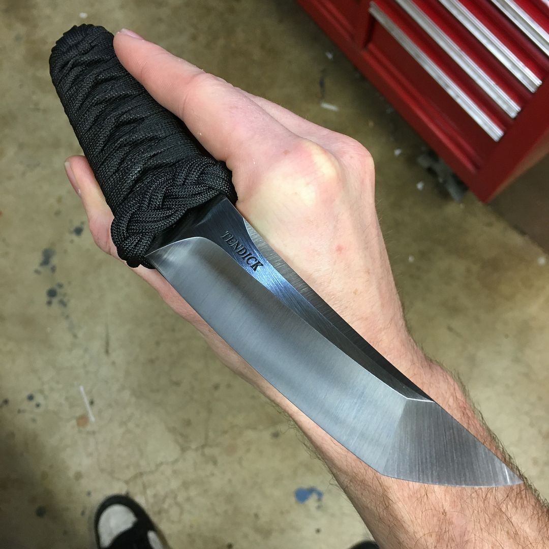

Nice work, everybody. You all have inspired me to try one of these myself. I haven't got the sheath done yet, but here are a few pics of the knife:
Steel is O1, about 59.5 RC. Blade is 6-1/4", total length is about 11". 5/32" thick and chisel ground. The flats are hand rubbed, but the bevels are belt finished.
Thanks for the video, Joe, and for starting this thread.
P.S. Please pardon the dust on the handle wrap...
BTW, the handle is paracord over black stingray.
