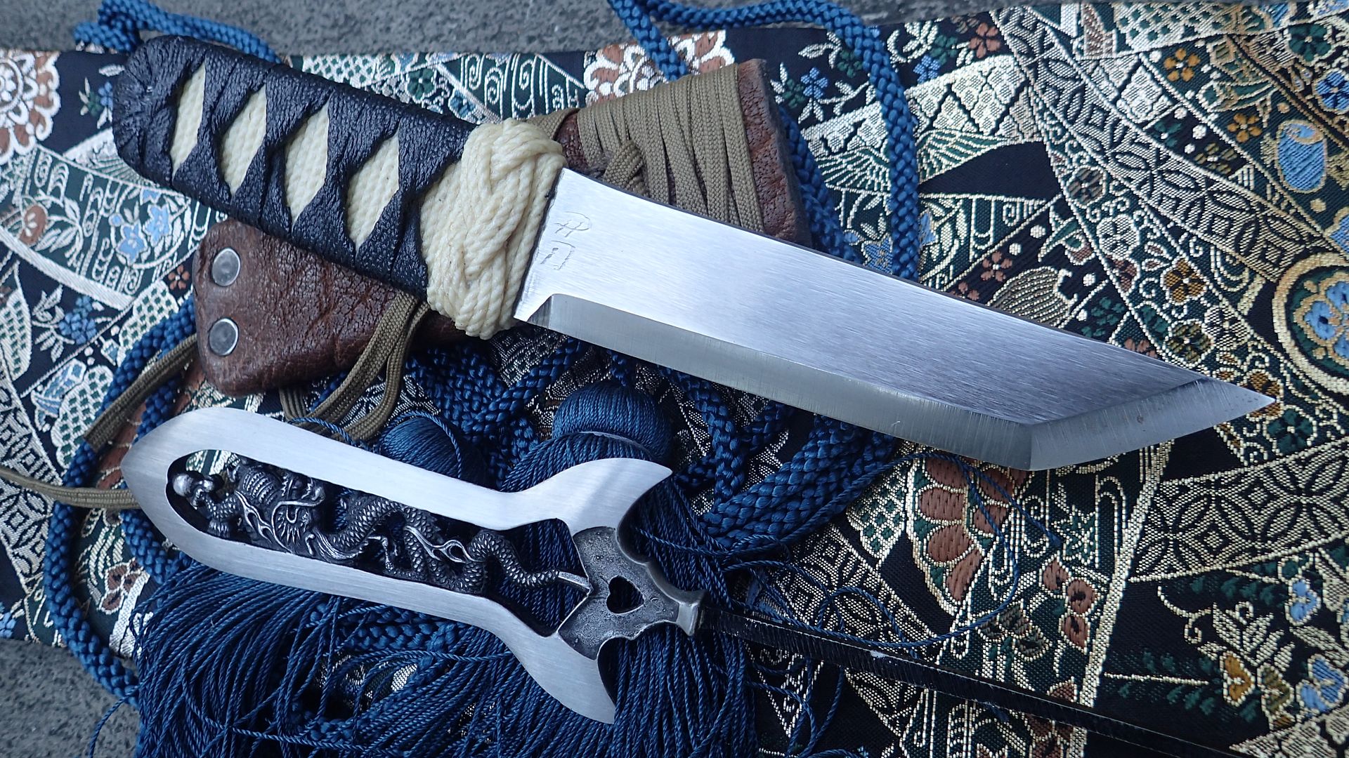

Well along came Adams variant
ATS 34 steel blade which is a lot more resistant to rust than A2
No lining in sheath .... Harder to contaminate and flushable
A rubber coated sheath ......... A lot better to clean out and rinse than leather
So now thanks to Adam Vigel I am back in the field with my favorite style of Utility knife
Thanks Adam
Now I can fish with my KWAIKEN
Now I can boat with my KWAIKEN and not worry about falling in :)
I do a lot of Salt fishing and even when I was in South America it was so hot the sweat alone would wreck a Carbon steel leather KWAIKEN
Now I can hunt with my KWAIKEN again
In reality as much as I love all of these variants since I'm a hard use guy Adams piece will probable get the most hard use of all

The Hartsfields are heavily treated with Epoxy
So is My RJ Martin
Much more than these
It makes the handle not as pretty looking but they are impervious almost to anything and you can scrub them with a tooth brush and they get clean
Adams seems to have a good amount of epoxy on it so we should be good to go
My handle is soaked to the core with System 3 marine epoxy. It is UV resistent and 100% water proof. System 3 is even more expensive then West Epoxy per oz.
It is so tough you literally can not cut it off or pull it off. It has to be ground off. While it looks like cloth, it is no longer cloth. It is solid and hard. (just like Joe :)
I have had mine covered in blood, body fluids, dirt, mud, sand etc. and all I do is rise it off with water and it is good to go. To make it bright and shiny and bring it back to new some soap and water, or even windex will return it to looking new.
It is far stronger then woods and totally water proof. Plus when your hands are covered in blood and cold the texture of the grip keeps you in control of the knife.

I use System 3, as well, for my cord wrapped handles. Takes a lot longer to cure, but it's bulletproof. RJ left his on this for the reasons Joey outlined, but I prefer the additional texture and grippiness when it's wiped off a bit. Looks cleaner, too.
Double ground biggie is coming along. Going to have to be a machine finish, as the wear resistance of this stuff is off the charts. My best sandpaper won't even touch it.:eek:
