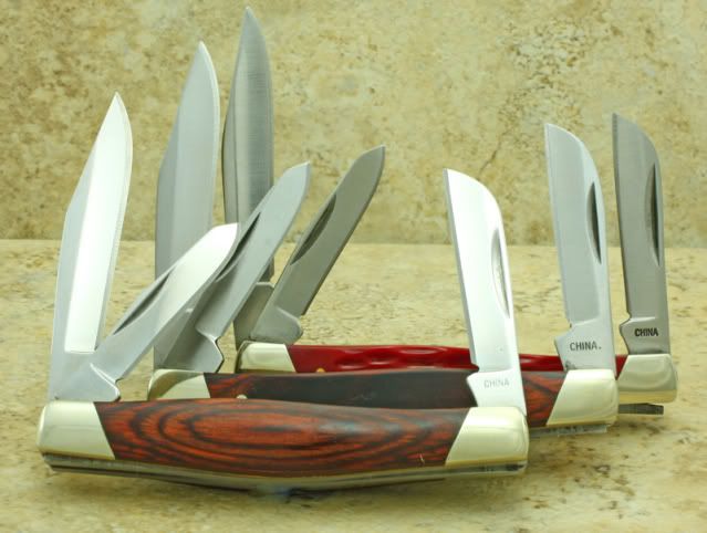

Here is a blow up of Stumps photo, using your GOOD EYE as the camera, see the reflections in the bolsters and rivets. Is that you or something in your shop showing.......

Ahhh....I didn't really pay attention to that before. That is either the camera/tripod or maybe something in the garage. I'll try fixing that. I am busy today, but will keep working on this. Thanks!

I did notice on the last pictures I posted in the SPS that I still have to get a couple reflections out of the bolsters. I'm a gonna keep tryin'!!! :)
