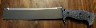

I may have shown this some time ago, but really like the image - though the knife now resides elsewhere....
