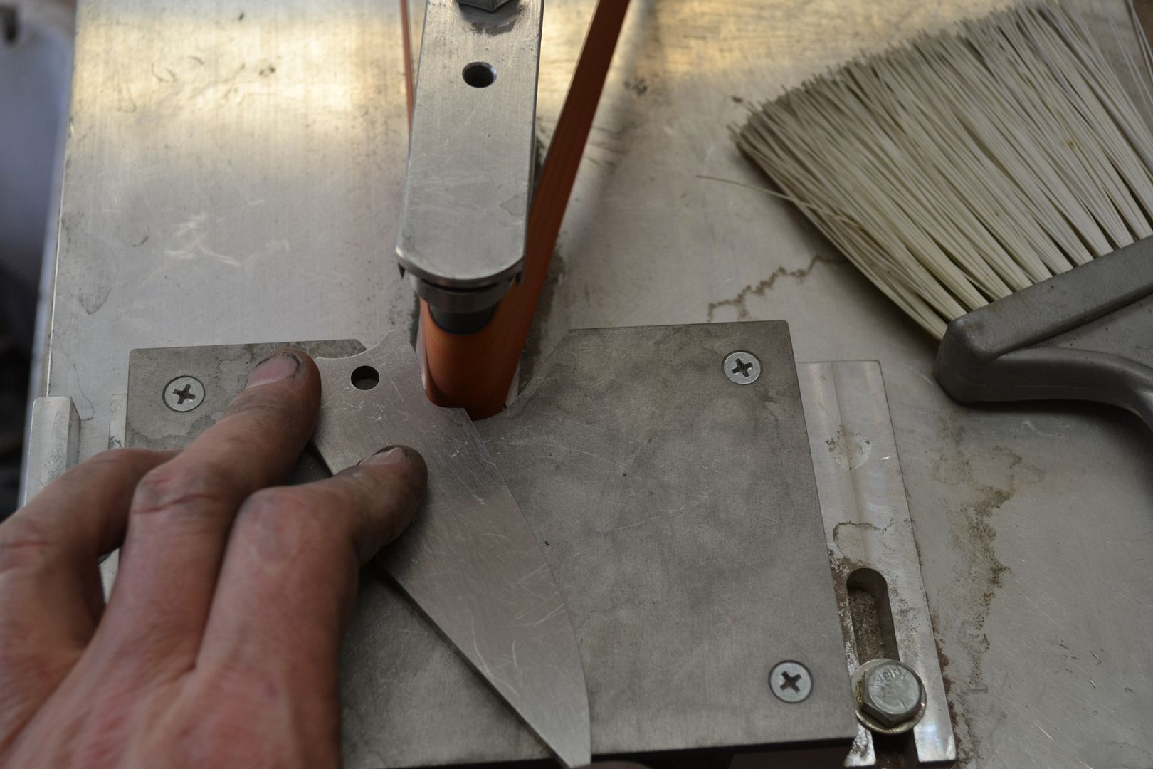

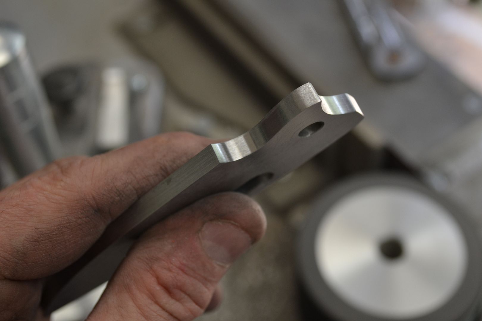

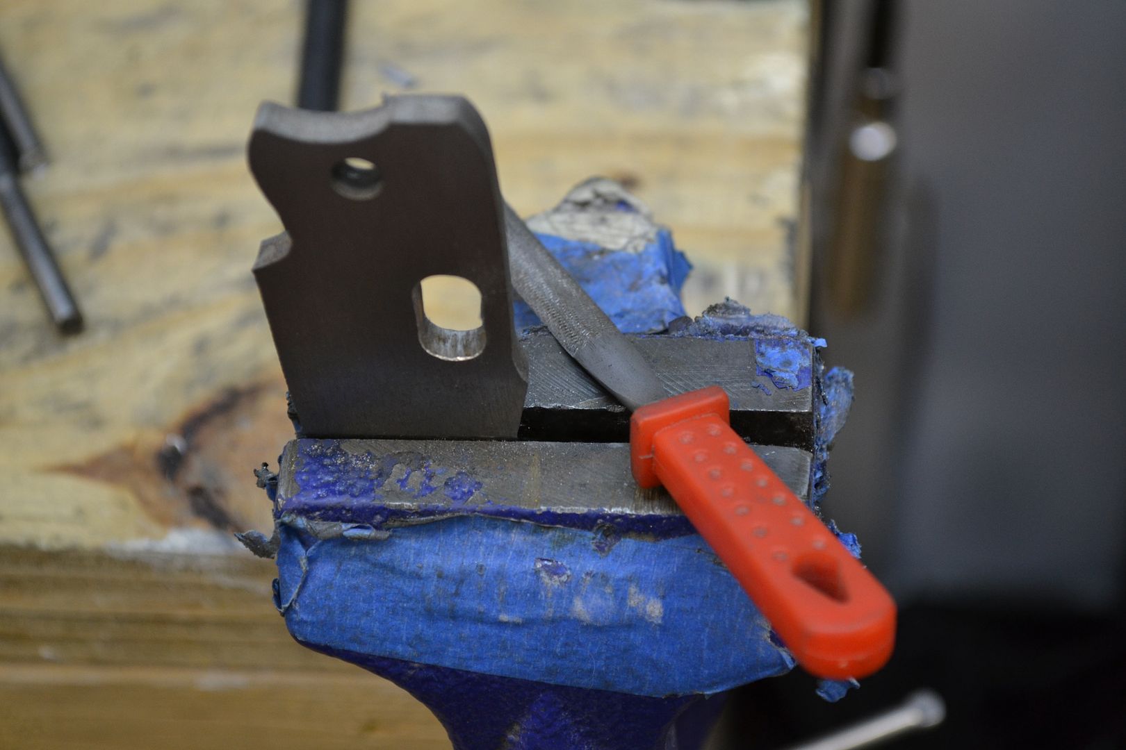

Filing the thumb slot... everything is chamfered or rounded for comfort. This one has a ways to go...

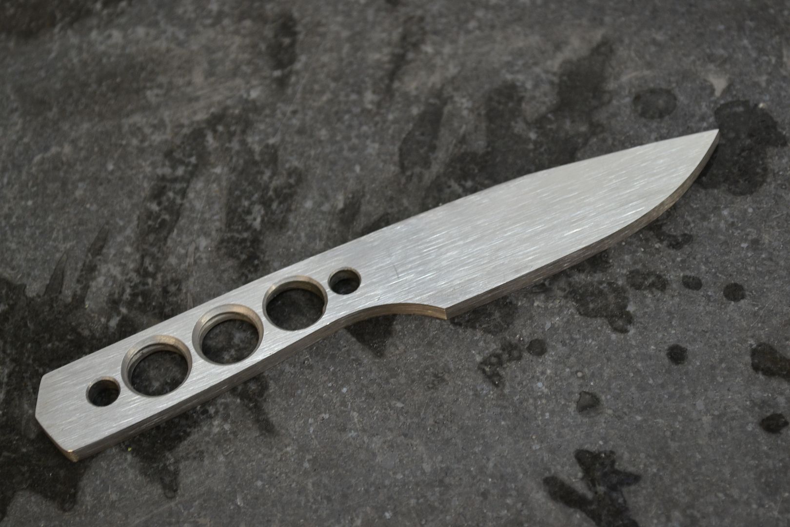

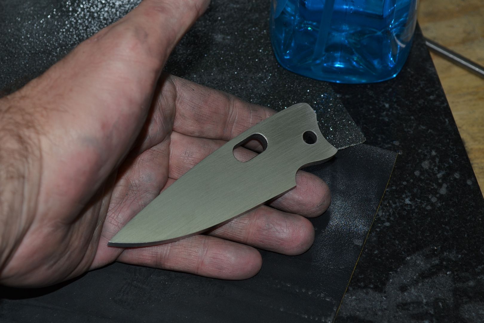

Wet sanding the flats - this is done many times on the blade and scales to ensure flatness. I'm using a granite surface plate for accuracy and windex to help the paper cut cleanly.
Looking better...
Drop Point Blade!

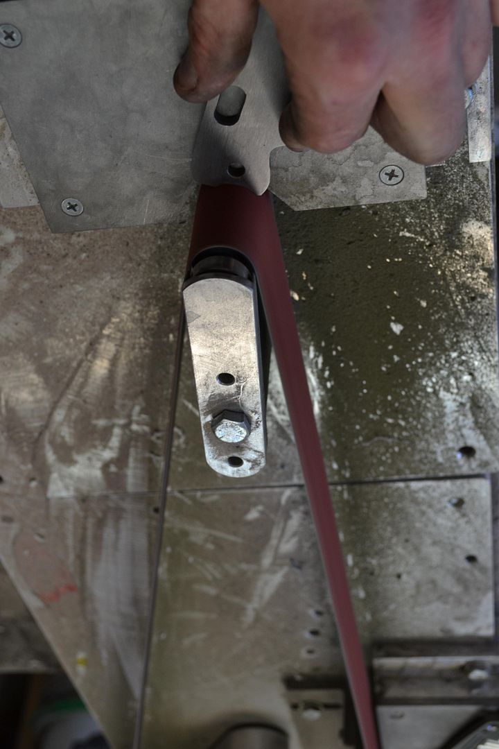

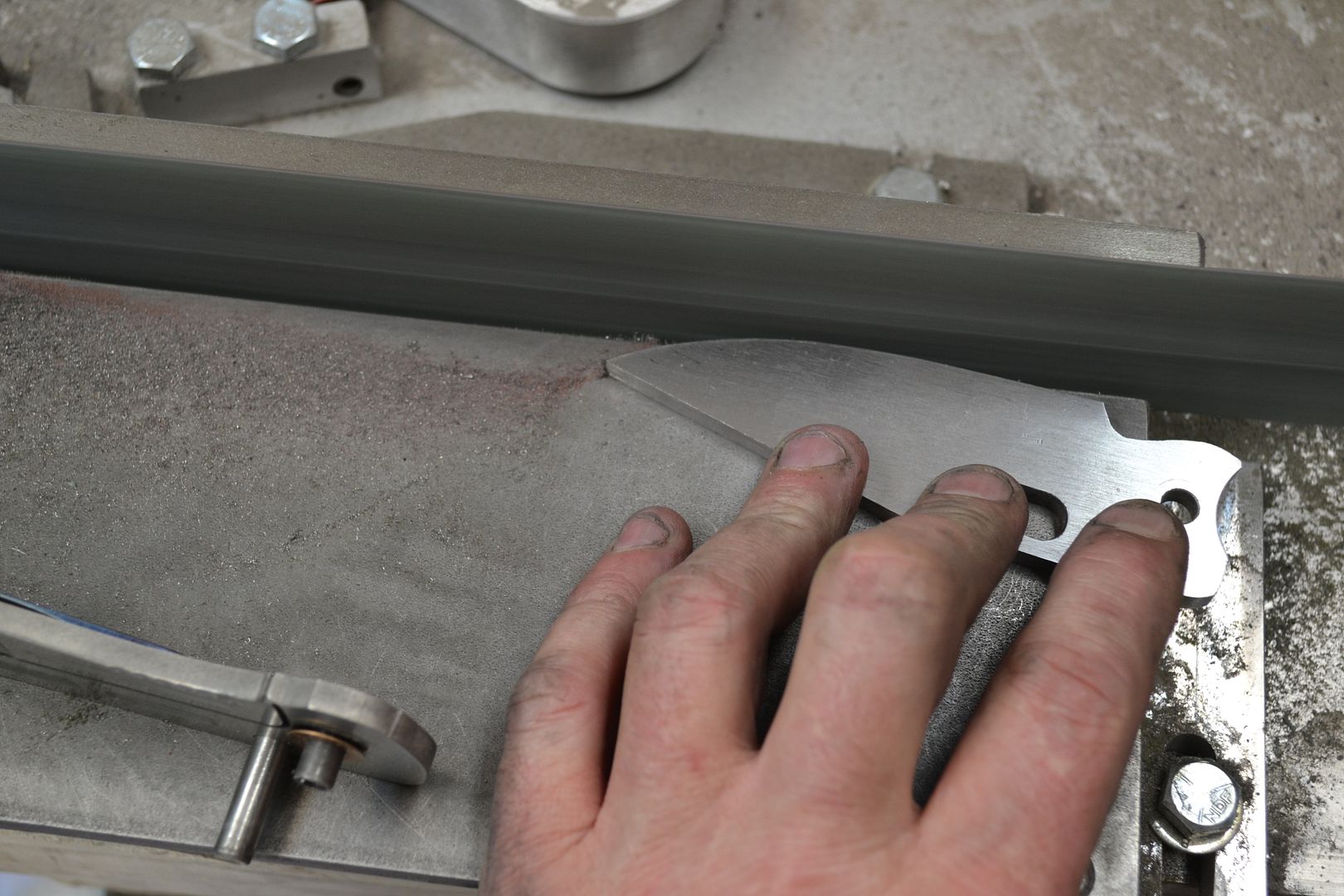

I'm using a horizontal grinder to polish and keep my edges "square"
I just worked on some od green micarta before this, the stench of phenolic is awful! lol that is the green dust everywhere
More cleanup... 600 grit at this point

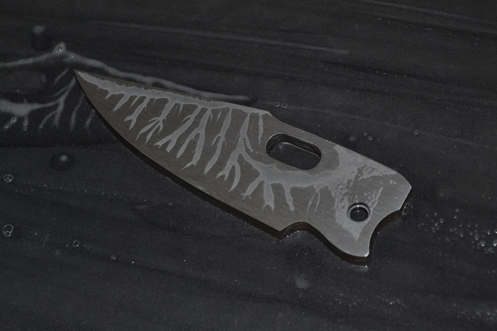

I remember from one of your previous posts about the folders that you were thinking about some kind of pimped or Ano options for the folders. Any hints?
I'm cleaning up and fitting the choil area to the stop pin.
A slip up at this point will ruin the blade so I am constantly grinding and assembling to test. The brush is used at just about every pass to keep my workrest clean.
Clean at 600 grit!
Inside out ano :D

This would make for a sick pattern if etched onto the finished product :D
