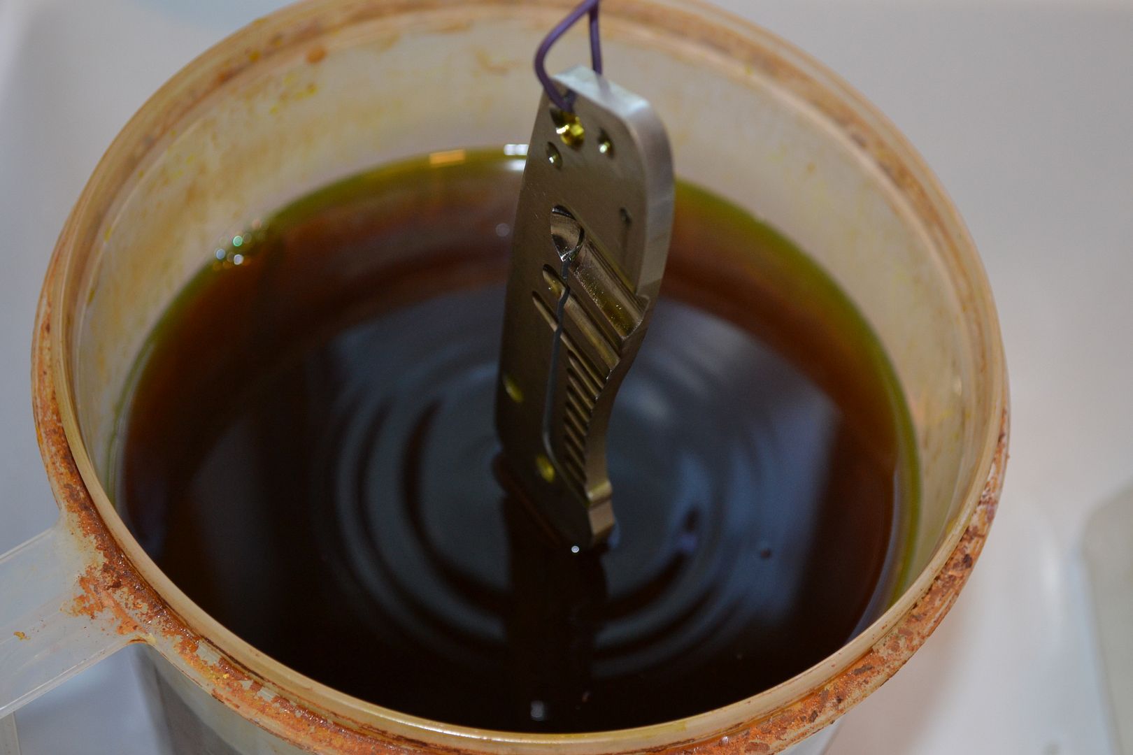

I have been giving my ferric chloride container a workout... it will eat a broken tap away and leave the Titanium untouched.

OK back to tapping! I had to soak that one overnight to remove the broken tap.

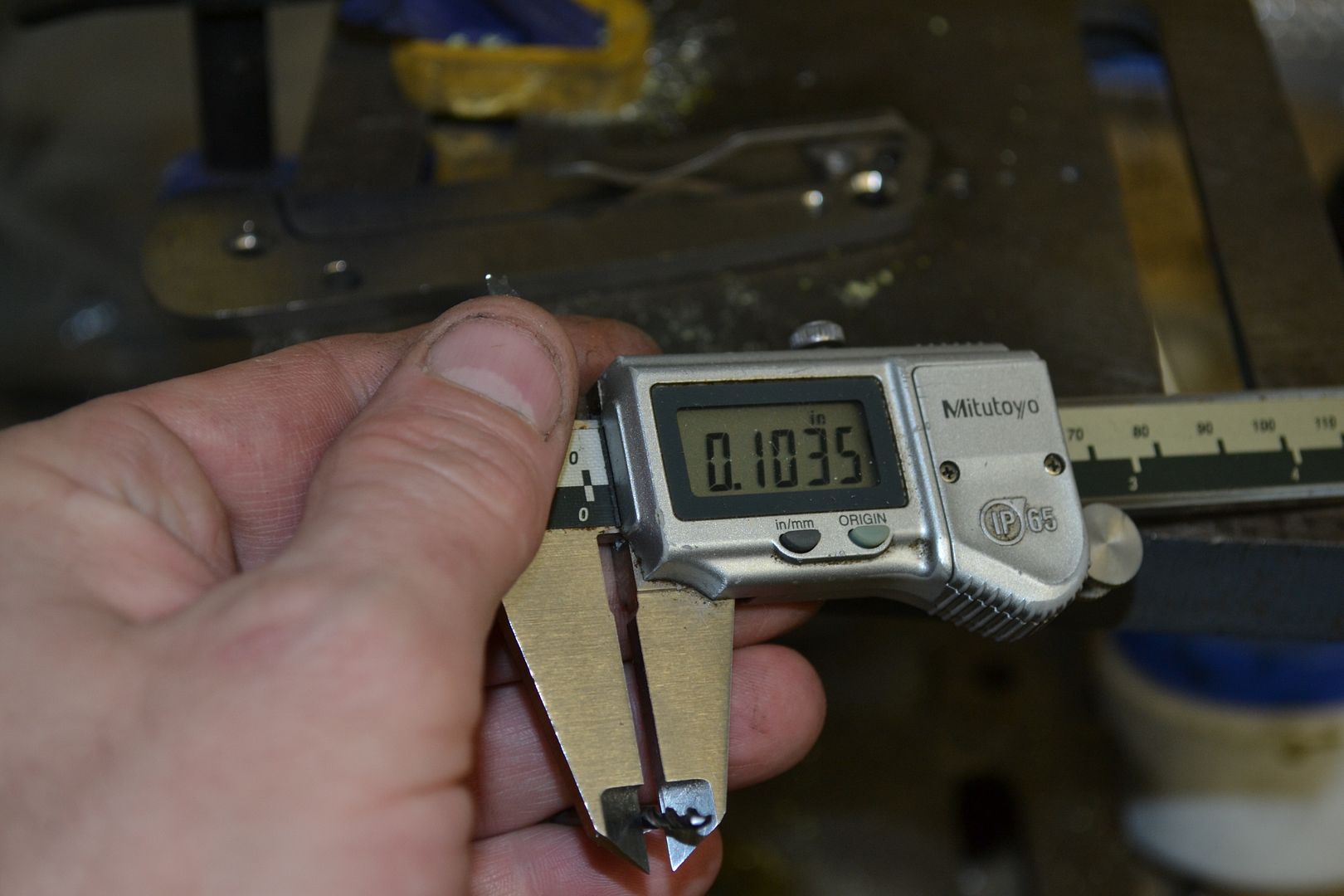

Here I'm checking my drill bit size. This is my bit for a 4-40 thread forming tap.

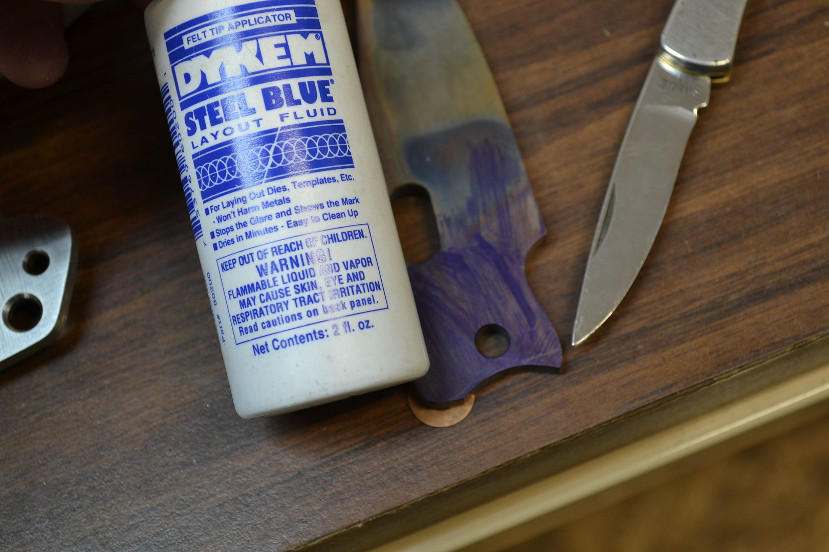

Layout Fluid was applied and I have scribed in my lock "grind to" area(with another knife, the tip is pointing to my line)... I can't see my line while grinding the lock but it helps me keep the grinding of the lock face aligned, I just flip it occasionally to check. I will fit the lock to the frame many times as well... getting this right is critical!

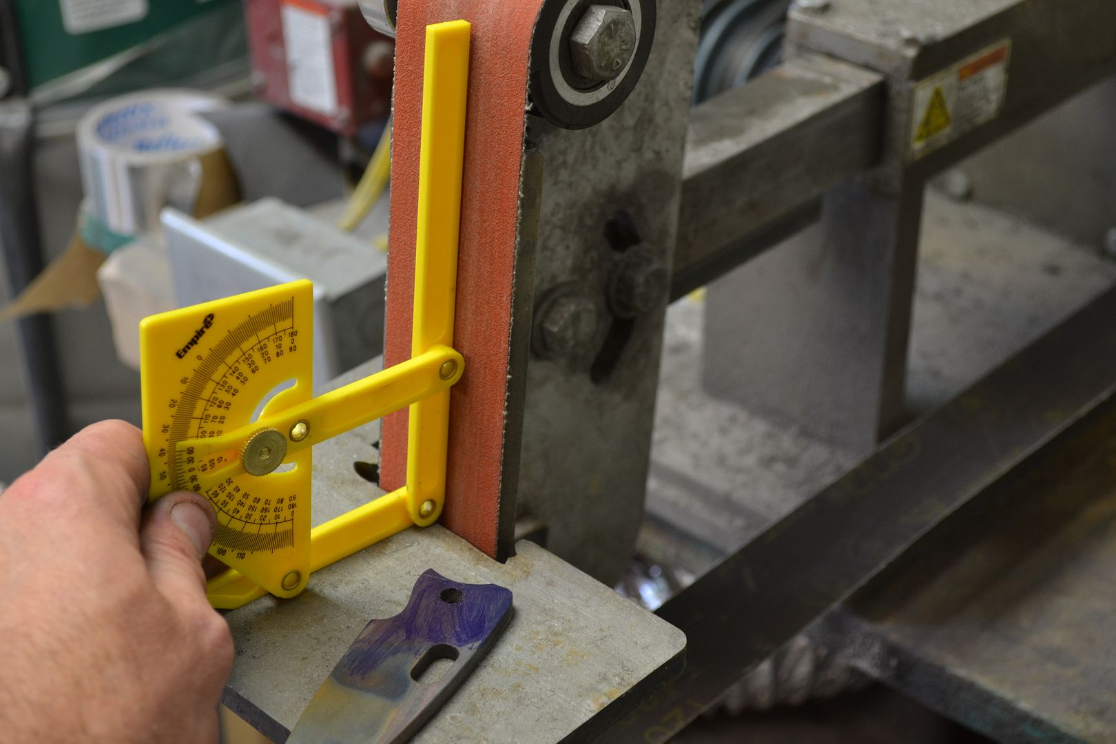

I'm using this angle guide to set my grinder to the proper angle for the lock.

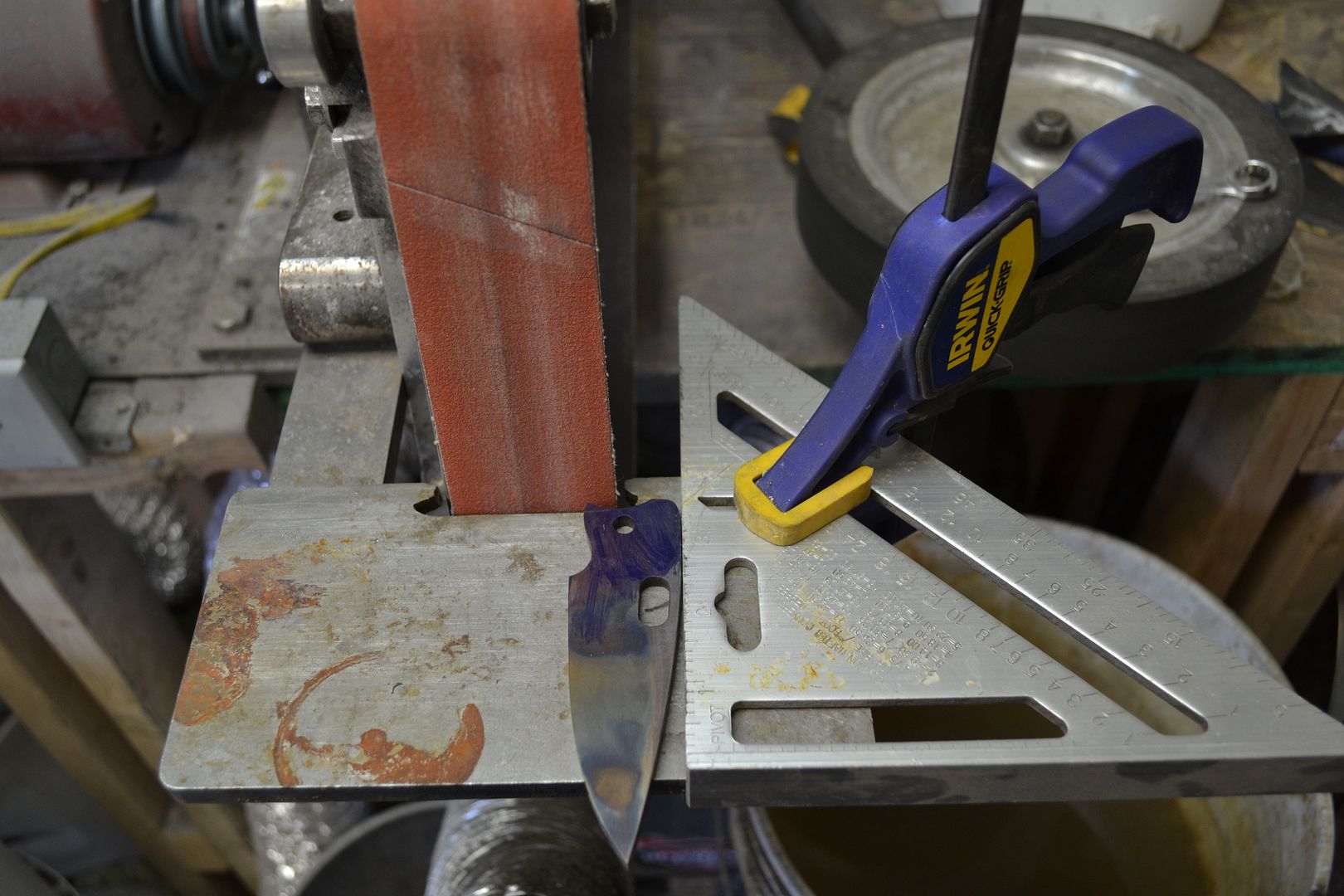

Here's my "jig" to help keep the knife aligned... set up backwards in this pic! The square goes on the left for a right handed folder. :D

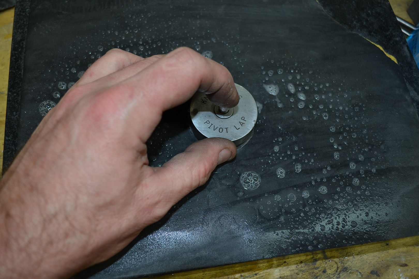

Later in the day... I'm hand lapping (precision grinding) a standoff. The standoff sits in the puck and is pushed with a "plunger" as I drag it across the surface plate. I'll match every standoff to .0005" or so, they are critical to get right. One light pass at 800 grit can often be too far! :D

".0005" or so" .......or so..lol that's friggin tight tolerances...
I'm trying to nail them but as you know that's tough even for the Mitutoyo's!
.001" is fine, I'm just aiming for closer. I have a pile of standoffs ready for knives with slightly thinner blades now too! :D
