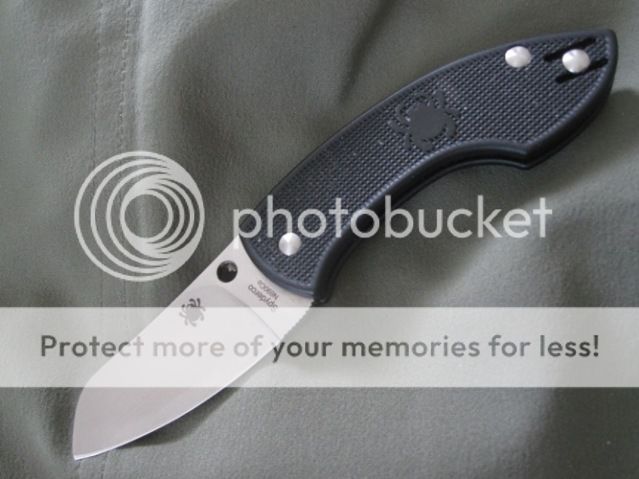

Though it doesn’t seem so or maybe isn’t transmitting through pics (always better to handle a knifeand draw ones own conclusions), the fit and assembly of the knife is very good.
Though it certainly does not seem so in this pic, the smooth transition between the spring and blade is excellent. As is the fit of both parts in relation to the handle.
Too big a curve to the handle and too much of the blade exposed (for DK Legal EDC), was my immediate thoughts when looking at the overall lines..
The curvy handle makes the handle not very ergonomic and too much blade exposed making it much easier to grab hold of the blade and opening it with one hand. Further more, the backspring on my example of the knife was not tight enough. It is very easy – too easy – to open the knife with one hand. In fact, it came natural to most people who handled the knife.
Biggest complaint from the test panel of knifemakers, knife geeks, hunters and outdoorsmen, was the very exposed blade and the shape of it.

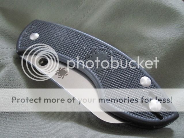

Initially, I did not care for the handle shape, though it has since grown some what on me.
The very pronounced ‘bulge’ (circled in red on pic below) on the underside of the aft part of the handle is not very comfortable, but of course serves to ‘hide’ a (too small) part of the blade….after a fashion.
I used the knife to open a lot of envelopes and cardboard boxes, which amongst other things, is the chief tasks for which I utilize an EDC knife.
I found, that when one grabs the handle of the knife with the index finger on the jimping, the middle finger and ring finger on the handle, the handle works to keep the knife in a straight line when aiming at a cardboard box ‘target.’
But when one adds the pinky to further grab hold of the handle, the little finger inevitably lands on the bulge on the underside of the handle and the knife dips a little as a result – something one has to keep correcting for. A detail, but still worth mentioning IMO.
Ironically, I found that the best way, that the hand fit the handle in the best ergonomic fashion, was with a reverse hand hold. Considering the limited use which ‘civilians’ have for a reverse grip, Im fairly certain, that this hold on the knife, was NOT what the designers intended, when they put their collective minds to designing this knife.
As previously mentioned, the handle curve does hide some of the blade, but still leaves too much blade exposed to grab hold of and open with one hand. Again, a problem further compounded by the fact, that the spring makes the blade open easily and smoothly.

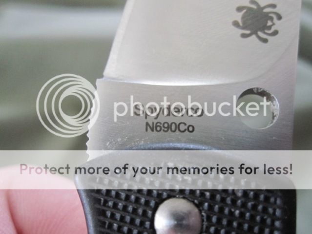

What, jimping and no choil!?
Okay, so you guessed it, Im a big fan of choils and would have liked to have seen a choil on this Spyderco also (on most knives of this type actually). No, I don’t care what length the blade has (or don’t have as the case might be).
The blade has jimping on the underside of the blade but none topside.
I would have preferred a choil instead of the jimping. A choil is also nice in a small slipjoint, as it goes some way towards preventing the knife blades from slamming back on your fingers, should the knife inadvertently close half way.

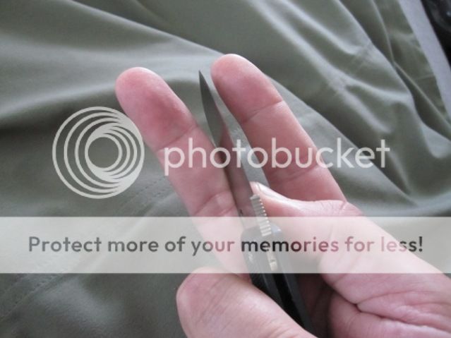

As mentioned above, I found a use for the Spyderco DK EDC Legal which most likely was not on the agenda of the designers nor Spyderco, Im sure.
You can hold and work with the Spyderco in several ways. You can use it with a normal hand hold or you can choke up on the blade:
Some hunters will already now be able to see, where Im going with this.
I found that the Spyderco is a very good small folding skinner. With the above hold, its perfect for caping and other fine work.
Using this hand hold.....
……………the curve of the blade and the ability to use two fingers as a guide so as not to poke into the guts, makes it great for ‘opening the zipper’ on a deer (I’ll spare you the gory pics).
The blade point not being too pointy was an advantage in this respect.
You would usually use the two fingers of your other hand when skinning, but please bear in mind, that I had to take the pic and had no hand to spare.
Further more, I will add, that the pic is NOT meant to be a rude gesture (as the two-finger salute is in some countries)!
