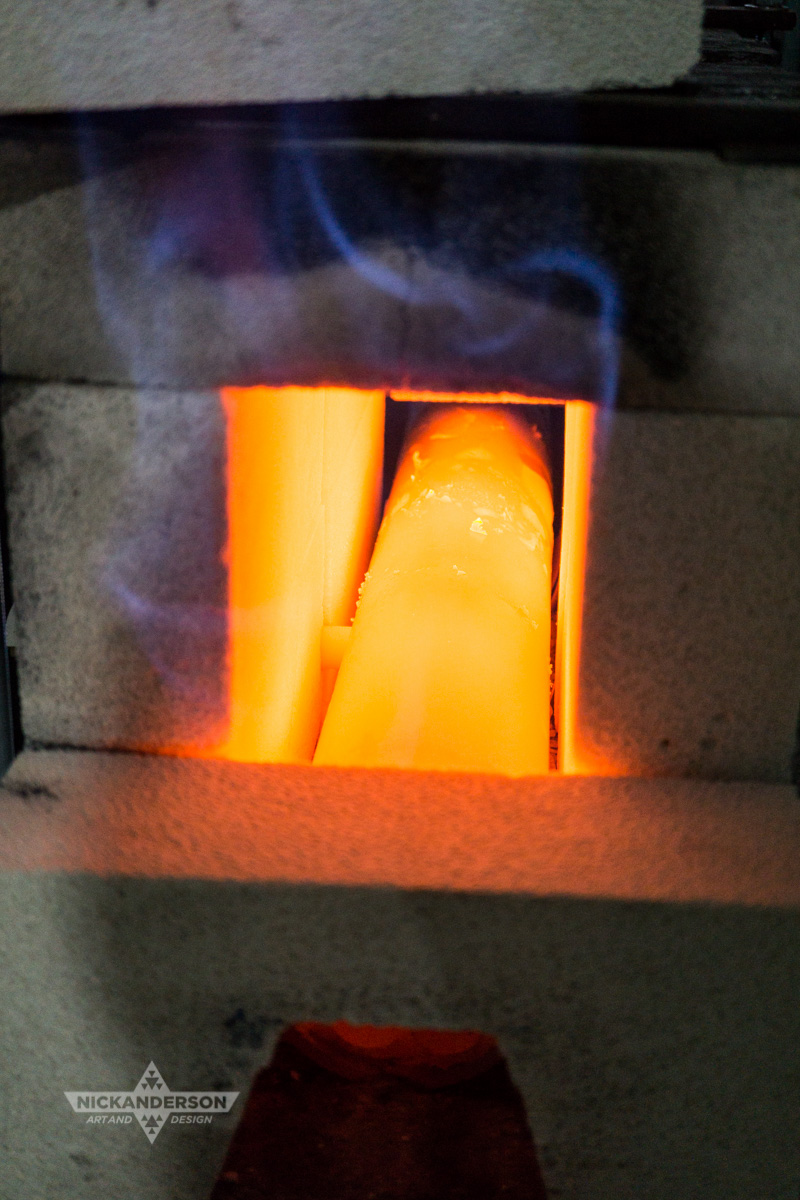

Hey everyone, so here are some photos of what I have going right now with the PID controller hooked up to a venturi forge. I still haven't build the blown forge yet, BUT, the controller worked so, so well with the venturi forge that I at least wanted to share that too for those that are working with a venturi and just want to add some extra control to it.
For anyone wanting to set this up, I also highly recommend the muffle. It helps so much to get that even heating.
I also added another level of bricks to my venturi forge which, while using a bit more gas to heat, does make for a really nice even heat when doing HT. I'm considering having a removeable floor that goes on top of the muffle for when I just want to do forging (thus again reducing the amount of interior space that needs to be heated). I would also then create a second inlet for the TC that I could place on the top floor when doing forging. Would be sort of a 2-use venturi forge then, forging on the top, HT on the bottom. If that all sounds confusing maybe the pics below will help

Until I build the blown forge, I have the PID controller hooked up to my 2-burner venturi forge. I extended the height for more even heating of the interior, and put a muffle inside along the bottom for heat treating. The TC comes into the side of the forge, and into the muffle as well

Here's the muffle for heat treating along the bottom of the forge, where you can see the ceramic TC sheath going into the tube. The muffle is approximately 1/4" (~6mm) steel, 24" (61cm) long
Another shot of the forge interior with front door brick partially in place
A shot of the inside of the muffle where you can clearly see the TC inside. I also have placed two long 1" bars of steel which serve two purposes - acting as a heat sink and keeping temperature even across the length of the blade (great for longer blades), as well as acting as a means to hold the blade upright in the muffle while doing HT.
