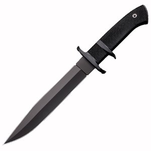

I guess this is more what I had in mind,hell it's even called a Boar hunter !
http://www.coldsteel.com/39lsp.html
I think I can recall a really neat one that Dan Koster had made once as well !!!
While I approve of the handle, I don't think this blade shape is any better than the original OSS blade shape...
I have a clax and love it, but wouldn't use it to stick a pig without a guard.

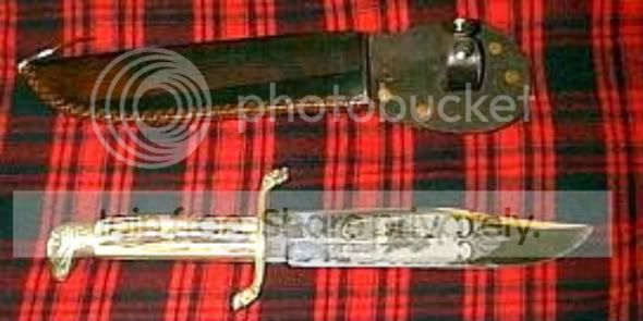

The knife I have carried for years when hog hunting is a Mulea Ursus. Mine is like the one in the group picture with the crown stag grip. I finished off a few that were still kicking but so far I have not tried one still on his feet.
Jerry Van Cook used one of these on a boar hunt. the guide said he has never seen a more efficient design:cool:

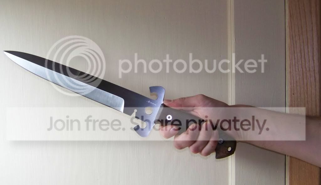

This was a knife I made I call the Boarhunter just for this insane activity. :D
Scott
What steel did you use on that one?
That is my favorite of your designs. One day I sure hope to own one.
With diesel as expensive as it is it may take a while though.
That is the first I made about 2 years ago. It's S7 steel. The second blade I made in S7, laminated (split) at the pommel end when I was drilling the tang hole. It ended up as a test blade. It's the one I shot with a 41 magnum. I think I've only made 4 of these knives. I don't get too many requests for the double guard knives. Doing a double guard is tricky especially on a full tang. Milling the slot has to be just right. Not alot of request for S7 steel either. It's a damn tough steel but doesn't harden very high. About 57 RC to maintain the shock resistance.
Scott
Scott
Thanks Scott, when I do get to order a knife these facts will be very helpful in making decisions.:thumbup:
