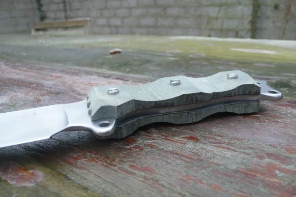

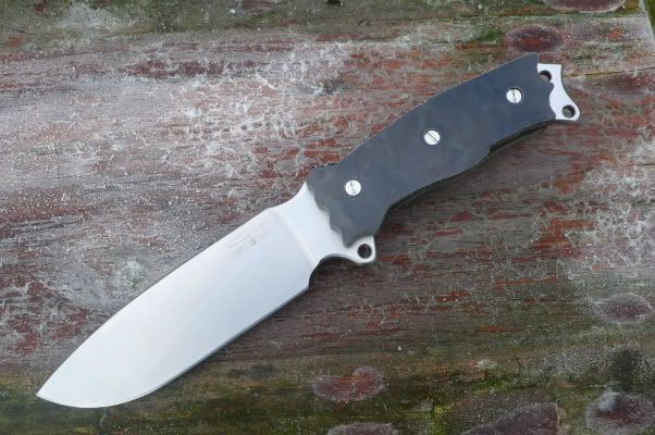

I bought a Busse SFNO recently, and I'm quite content with it, but there are some aspects that can be improved i.m.o..
So I decided to pimp it.

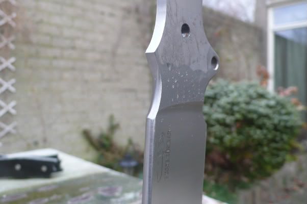

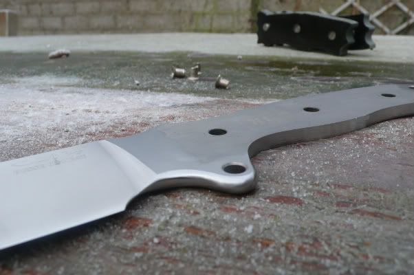

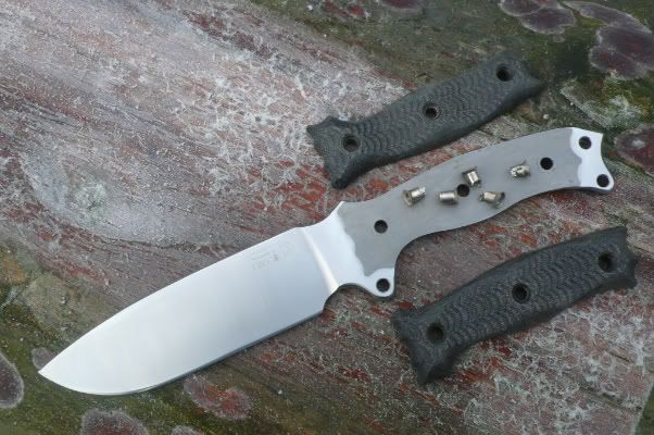

First: change the coarse factory edge into a 2500 grit polished one: scary sharp! Then, remove the magnum grips (too thick) and the alloy handle bushings (the weakest point of this knife).
After that I decided to round off the sharp edges around the handle. Busse calls this the "Nuclear Meltdown treatment", but I can do that too. Added bonus is that this knife is now pretty special, because Busse has never treated a 7" SFNO this way (at least not as far as I know).

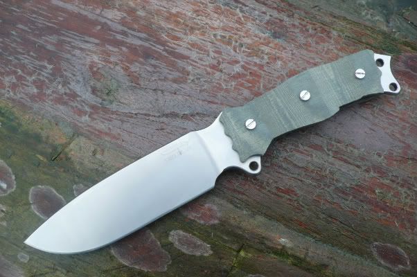

Next step: rough fit the new black/green linen Micarta handleslabs with three stainless Corby blind bolts (very strong).
Next step: Rough shape the handle slabs. The texture of the Micarta becomes visible. Now we are getting somewhere!

Outstanding job edge-maker! Your Nuclear Meldown treatment looks excellent! Can't wait to see the knife finished! Is the blade satin finished or double cut?

TreeherderV, the blade is double cut. I,m going to give it a light beadblast overall when it's finished.
