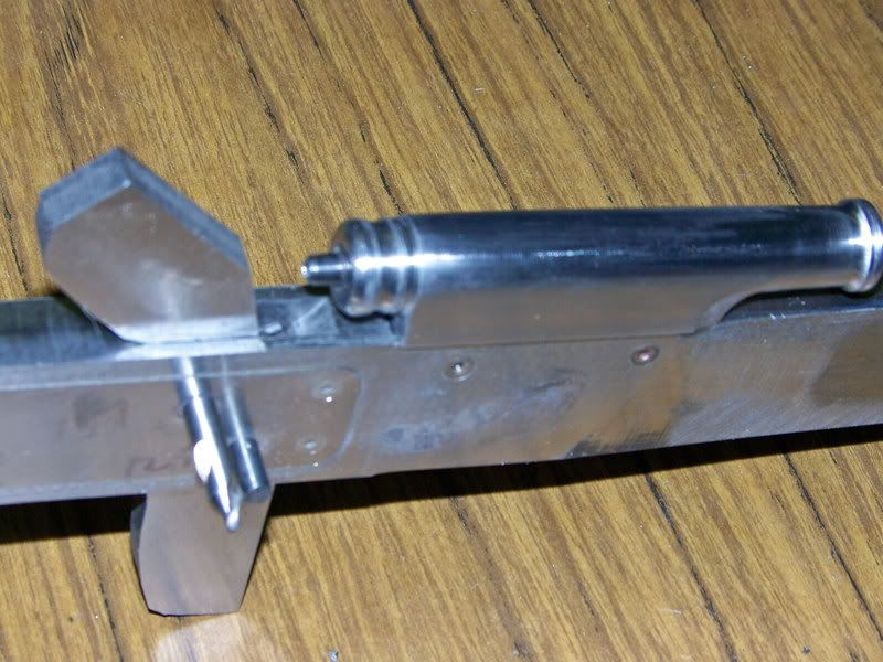

I got to spend most all day in the shop so I made some more progress.

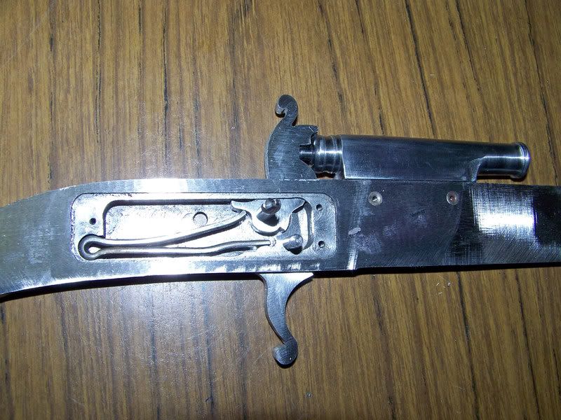

I drill and reamed the hammer and trigger and cut and ground them to shape.
I also roughed out the liners and refined the barrel some more. Its all beginning to take some shape.

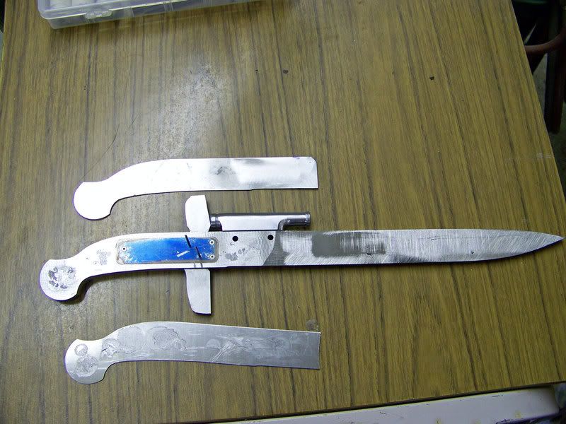

I super glued the liner material to the frame and ground it very close to the finished size. I need to figure out where the hold down screws need to go. That small cover plate is titanium (because it happed to be the correct thickness) and helps support the pivots for the hammer and trigger.

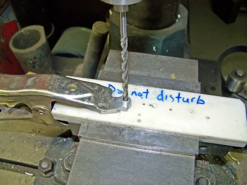

I clamped a piece of corian in the milling vice and used a fly cutter to surface it. Now the quill is perfectly perpendicular to the table and will give me a better chance of drilling and reaming the pivot holes.

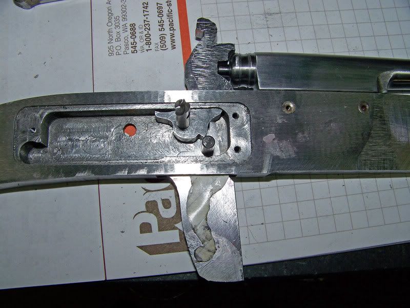

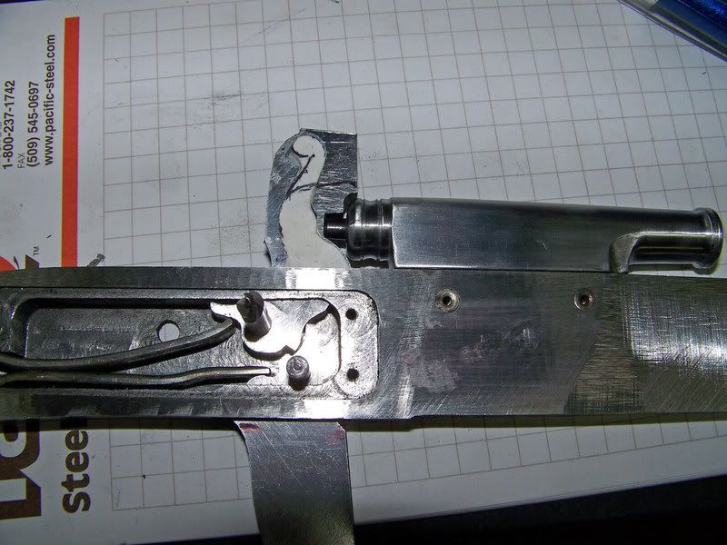

A slighly blurry shot of the nipple and the back of the barrel.

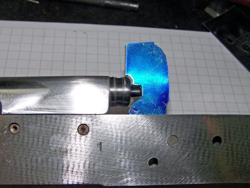

Here Im cutting the hammer to match the nipple and back of the barrel. The lower portion had to be trimmed way back so it didnt contact the nipple as it cocks back.
A paper pattern is glued on so I can bandsaw around it.

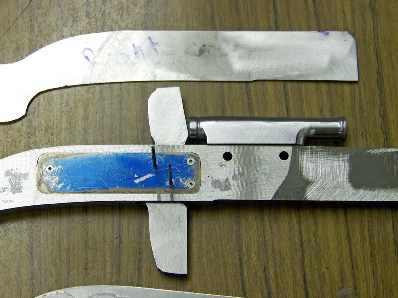

The same pattern on the trigger.

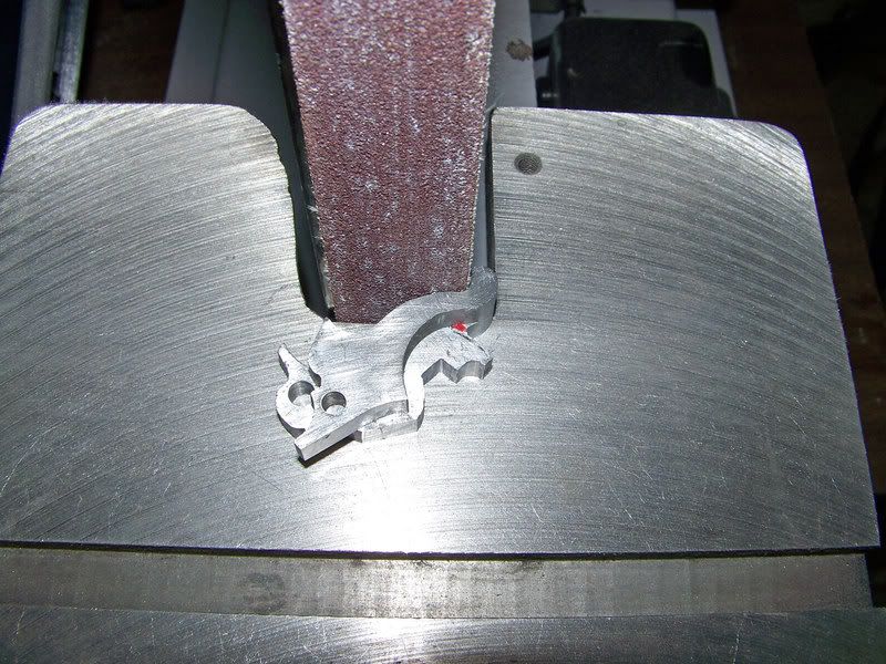

Here the hammer and trigger are superglued together and contoured at the same time so they will match at least on the ends. I have a 1" strip sander that works good for this. I have a oscillating spindle sander that will do most of the inside radious's. The Dremel will contour the tight ones.
I popped a cap already to test my spring tension. It took 3 times but I think after the plates are in position and it has some lubrication on the pivots it should fire every time. If not I can shorten the main spring so it has more leverage on the hammer.
