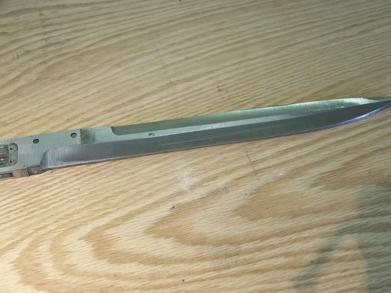

Here it is after the initial belvels. I left it thick enough to regrind just in case (heaven forbid) it warps a little bit.

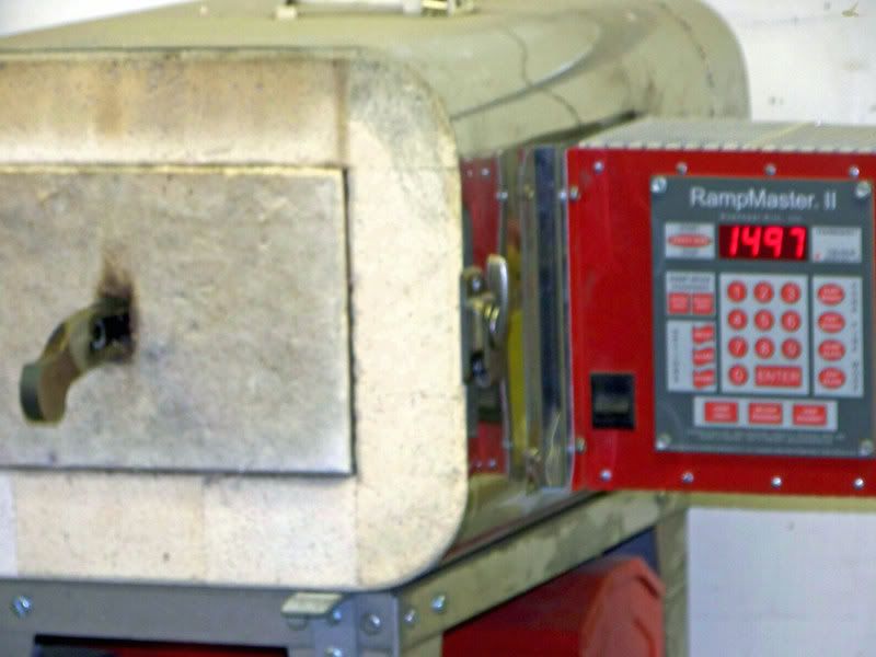

I am going to try something Ive never done before but I cant see any reason why it wont work. I am making a "Insul board" door for my Even Heat oven and have cut a slot in it for the blade to poke through. This way the handle will not get hot. Im going to use PBC anti scale for everything that is exposed to heat.

Bruce the only thing I'd be afraid of is, will so far a way from your thermocouple will the heat be right on there next to the door ?
can I ask
if you are going to PBC coat it anyway why not just quench the part you want hardened? leaving the tang soft , I know you do this routinely anyway but just asking why on this one?
saving some mess maybe? or to long for your E/H ? ;)
also going through the door you'll have to worry some about where the cold line will be if you know what I'm thinking..
I dont even want the handle heated back up again beause of the machine work and thin walls created there. The thin barrel mounting walls will be in the heat. I should bolt a spacer in there to keep it from warping. I'm counting on the entire oven space being hot enough to austinize the blade. With that said I am also thinking it wouldnt hurt to have the ricasso just below critical temp where the door slot maybe letting the temp drop somewhat. There will (hopefully) be a tapering of hardness there as long as the cutting edge is hard

Its pretty long and has two edges to heat with a torch. I have thought about heating it in the forge and assisting with a torch but I want the whole blade hard not just the edges, and the oven method is safest I think. Ive spazed out before and dropped blades on the way to the quench also bumped the tip on the tank and bend them. Lately the oven is proving the most reliable method for me.

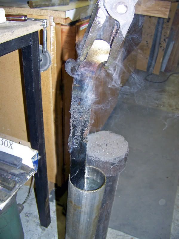

OK it is resting in the slot and at temp. I didnt get a shot of it coming out red hot because Im alone but heres one with it still smoking coming out of the "tough quench". It looks good and straight too.

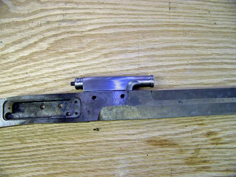

I like the PBC. I filled the entire pocket where the barrel fits with it and it didnt warp in the slightest. Maybe I just got lucky but Im tickled.
After a long rinse in hot water all the PBC is gone and the barrel fits like a glove.
A file skates off the edges but bites on the handle area. Yippee
