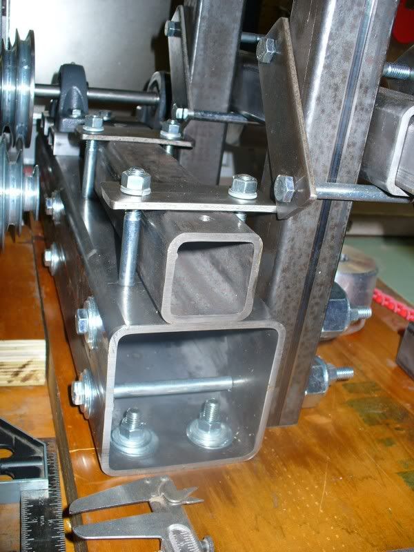

ok here are the pictures of my head for my grinder. i had taped the thick steel plate and just bolted the wheels to the plate but the taped holes where not perfectley strate so the wheels where off a little. so i drilled out the taped hole and bolted the wheels and spaced the plate away for the tool arm so it could rotate without hitting the bolt heads. let me know what you think.
Jarod, you and I have talked about your design before but I'll say it here. I think it's a great idea. It's clever all the way. I plan to build one of those myself to see if I can learn something...:thumbup:
want me to send you the drawing its to scale and has all the mesurements and where to drill the holes. you could try it out and put it in the plans

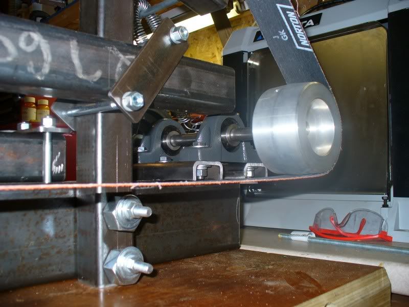

whats the best way to line up the pillow blocks. which way do thay face it seams that thay have a cirtin way thay need to face or it does not sit flat. i got it as close as i could bu when i tighten down the last bolt the shaft gets a little harder to turn. is this ok. could post a picture of how yours are. are the zirk fittings sapost to be on the same side facing the back.
either way is fine. i put mine in so with the zirc forward so I could grease easier. if the shaft tightens up a little, that is normal, if it tightens up a lot, the two bearings aren't plumb to each other and the pipe probably is a bit out of square. use a BFH (big hammer) and tap the pipe if you need to square it up. you should be able to spin the shaft by hand easily. the bearings float a bit inside the bearing block so you don't need to line them up exactly.

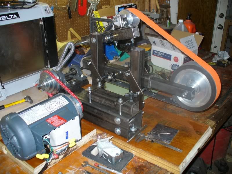

I agree with JT. This Grinder went together very easily, with the instructions. It is well thought out, I spent a total of 20 hours to get to the point you see in these pics. This was the first fire up, I could not wait. I had to fine tune the wheels and wire in a switch after this. I've since made the tool rest, and the platen is next. I did use a thicker box for the main frame and modified the pillow block mounts for a wider stance.
If you are serious about building a grinder, get a set of these plans, they are also chocked full of information you are going to need concerning where to get everything and all your options.
