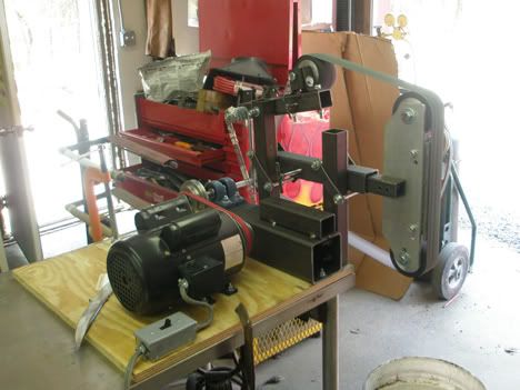

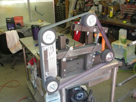

Just wanted to say I just got My NWGS running and it works GREAT!!!:thumbup: Here are a few pics, it's infinitely unpretty but I build My tools to do the job. The knives I try to make good lookin':D
I want to thank Tracey for designing this beast and for all the help getting it together.
Matt
I bought all my wheels from Sunray Polyurethane. Three 4" idler wheels, one 4" drive wheel with a 5/8" arbor and keyway (I forgot to get the setscrew option) and a 8" contact wheel all for $228.00 shipped! All work great except the drive wheel seems a touch out of round at the highest speed, it's not bad and I can use it but I might try to true it up.
Matt
That's a good looking build Matt. I only see a few extra holes. I'm on my 5th one and I still have extra holes! I'm testing sunray wheels on this build myself to see how they hold up.
