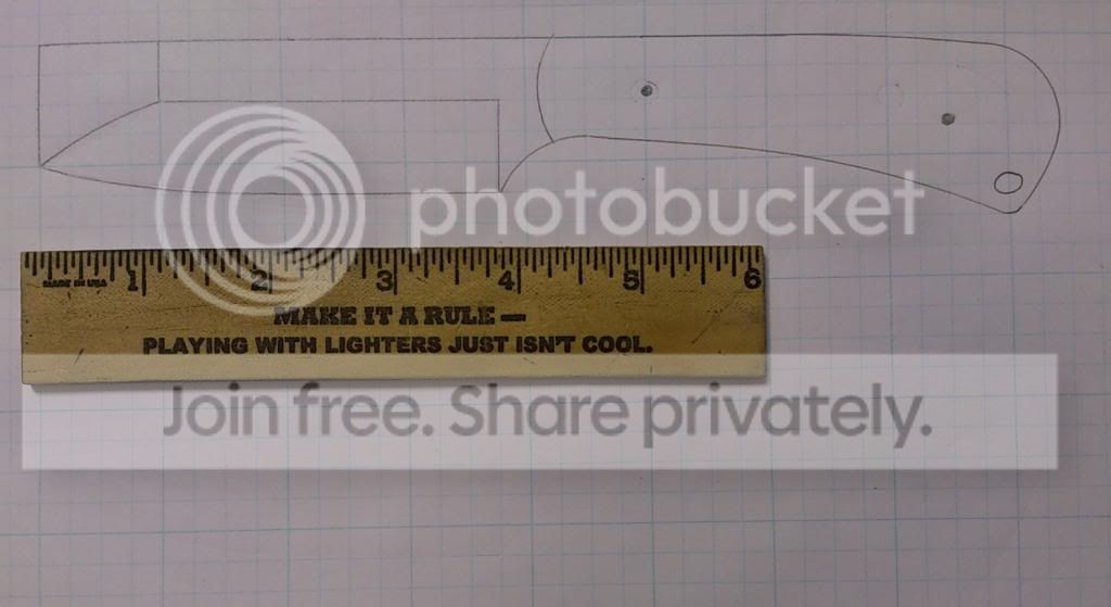

Hi all,
I have a hand sketch of of a knife that I potentially want to have made. However, I'd like to refine the design by getting some input from the experienced individuals here.
The goal of this design is to be as lightweight as possible while having at least a 3 inch blade, and to maximize its "utility" aspect.
The blade shape is influenced by Jon Graham's Razel, and the handle shape is influenced by the ESEE Izula. The proposed features are a 3.25" blade, a 3" handle (I have small hands), 1/8" spine thickness, and about an inch of jimping for the thumb. The pommel serves to be a glass breaker, but that feature is optional.
The plan is to cord-wrap the handle. However, given the current proportions, the design appears blade-heavy. If that is the case, would mounting handle scales balance it?
I will most likely have to obtain permission from Jon Graham and ESEE to incorporate their designs; does anyone have experience doing this? Do I just send them an email?
All comments, especially suggestions for form and function, are welcome.
The sketch is 1:1 scale with a ruler for reference.
Handle scales are only going to balance it so much, depending on what they're made out of. I suspect this one will be balanced quite a bit forward. Maybe not have the handle skeletonized? Looks like a fun design though.
-edit- Another thought; maybe use thicker stock, and surface grind the blade portion down, so the thickness in the handle is broader than the blade? That should help with a more neutral balance. Sort of like an integral.

I would like to have some form of a cutout in the handle so that it can be more versatile when it comes to cord-wrap techniques; that's one of the reasons why I referenced the Izula design.
However, given your comment about balancing, the thing I'm trying to work out now is how much material I should remove (if any at all). Or maybe lighten the blade side somehow.

Hmmm. You've asked for a critique, so I hope I don't heart your feelings. It looks like a mini, chisel- ground meat cleaver to me. I think a more traditional blade shape, with a high flat grind, would be more useful as a "utility" knife. Not my cup of tea at all, but to each his own.

Full flat grind might help with balance too. I don't think you need permission from Esee unless you plan to sell these. If you're just making it for your own use or to give to a friend I don't think you need to bother.
Will you be cutting this out with a water jet or similar or using hand tools? If hand tools, you can cut out the profile, maybe drill the large hole at the butt, and then do all your blade grinding. Once you're done you can see how the balance feels and and proceed from there. You could get away with a much narrower cut out in the middle and still be able to weave a paracord wrap.
Another thought, and more experienced guys might be able to comment on this, maybe try making a wood template complete with bevels and cut-outs. It would be fairly quick and easy and should give at least some idea. It seems logical. Metal will be heavier but the balance point should be the same or similar regardless of material. I would not simply go by the feel of the wood template in hand, since it is so much lighter. But you could balance it on a knife edge and find the centerline. If it's near the ricasso you should be fine, if it's way off then you know you need to change something.

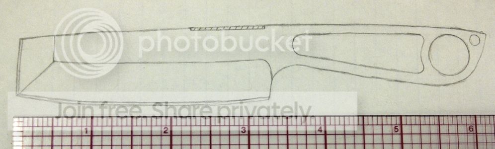

Here is a sketch of what I was trying to describe earlier.
For me this knife is all about the potential for abusive use. Chopping wire, scraping, prying (yep I said it) and whatever else one might reasonably throw at it. That is why I like 3/16" or maybe 5/32" thickness for such. All the Razels I have seen have a hollow grind for the main edge. (I tried to represent that in the sketch with the curve in the yokote.) I think that I will use a saber grind with a small secondary bevel at about 40° inclusive. Same grind for the tip edge but the secondary bevel for this would be closer to 20° inclusive. I think a "chisel grind" (one side of the blade only) would work well for this design except that the presentation side of a right handed knife would be rather dull to look at. Might be of small consequence when taking into account the less work involved with just one side beveled. I will be making my first one from 5160. I have it already in the appropriate thickness and it is a tough steel. Titanium doesn't get hard enough for a knife, IMO. The handle in this sketch is basically yours flipped upside down with the glass breaker point down so as not to dig into the hand. (Also since it was my drawing I drew full tang so as to attach scales of G-10 or rubber.) I am still experimenting with different handle shapes for myself.

If you want to get everything possible out of it as a tool, an impact feature on the handle butt would serve your balance issue and increase utility. I also think if you designed it carefully you could make it do double duty as a can opener. I'd suggest splitting the tip for nail prying, but the skeletonized handle doesn't serve well in that capacity, and it may make it a bit too much of a demolition bar, although if the notch was sharpened it could serve as a wire stripper/bone cracker if you like marrow...those are my thoughts.
1 that pointy bit on the pommel may be uncomfortable during hard use and probably not much help in breaking tempered/plasticized glass; if the glass isn't tempered or plasticized then any metal shape will work even rounded
2 if the skeletonized portion was wider than it is now (.25: instead of .125" for example) that would yeild more handle weight
3 or you could have a hollow gound into the backside of the blade making it concave to reduce weight
4 but if you give the design to a maker and specify where you want the balance point to be he can figure out the best option for you
I get a chuckle out of al the worry about "balance" in a knife. It isn't a tire spinning at 1000RPM. It is a stationary small piece of steel.
If it is a fighter or chopper, balance can be part of the design and function, but for a three ounce utility blade, balance plays almost no factor. In this case, the person deliberately wants a short handle ( too short in my opinion). That will alter the balance. Trying to add weight to "balance" a lightweight object would defeat the point of it being light weight.
Just for thought....a scalpel is totally handle heavy and horribly balanced...yet they seem to work pretty well for what they are made to do.
For a utility chisel grind, the side doesn't really matter. For food slicers, it doers. On a general use knife, the ura is on the left side for a right handed person ( as in nopyo's sketch).

If balance isn't much of a design factor, then that makes it easier. I'll try to get a better idea of handle size and pommel placement once I make a cardboard prototype.
I have made a lot of tanto knives in similar shapes. Try a 3" blade and a 3.5" handle and you will be quite pleased. The missing 1/2" of blade will never be noticed, but the added 1/2" of handle will make the knife much easier to use, as well as better looking.
