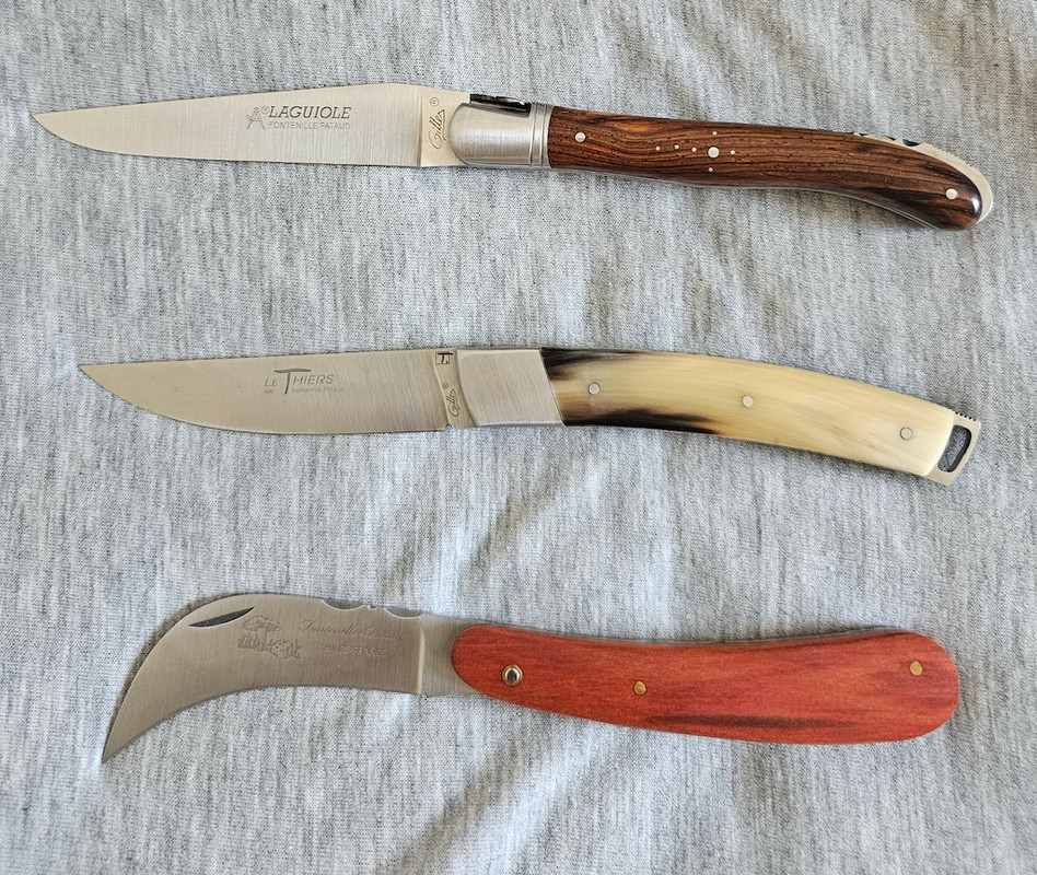

--------------Update--------------
Thanks for all of your advices, special thanks to Mk-211, FortyTwoBlades, Bill DeShivs.
Now the rusts are removed, only problems:
1. there are many "scratches" after wiping down, at the time the new knife arrived, I concerned about 2 scratches, now I don't have any concern🤣, but is there a way to polish it?
2. after applying WD-40, the it feels "greasy" every time I touch and handle it, is it safe if I touch food after handling the knife? Is there a way to remove the oil-feeling?
Here are the "new" knife, thank you all once again.

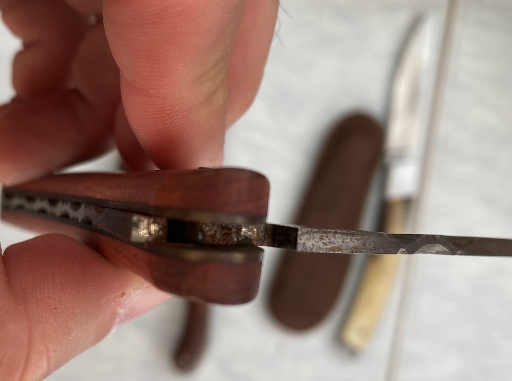

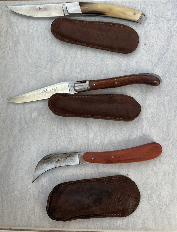

Then, I have taken it with me in 5-10 hiking activities, but at the 2-3 time hiking, it was raining, I put the knife in the sheath (originally provided by the dealer) and placed it in my hip-belt pocket. After getting back home, I found there are something like "rust" on the surface of the blade, like following image shows:
at the beginning, I thought it was because of the material of the sheath, but then I take the other 2 knives placed in same sheath (also took with me in hiking in the rain) to compare, those 2 knives have no issue. like following image shows:
Then I checked the other parts and detail of the mushroom knife, same issues:

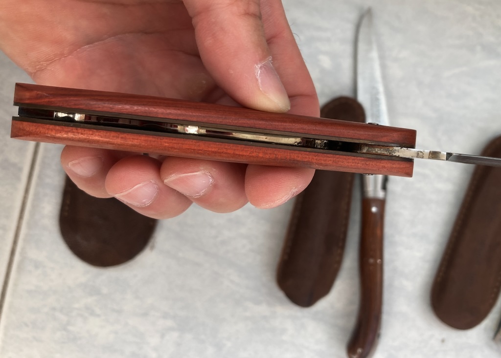

but the inside of the liner is shinning:

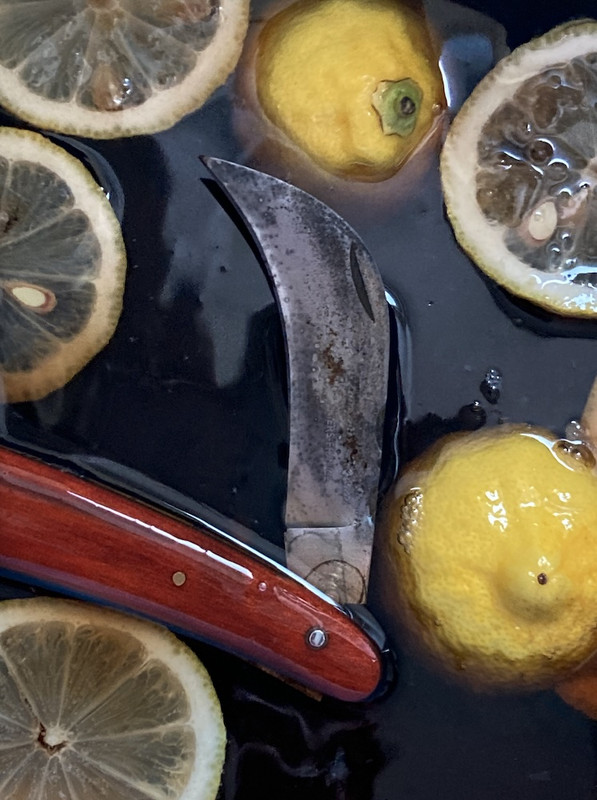

Then, I wanted to try to clean it by using: Lemon+Cola+Salt,
after 10mins, I picked the knife up from the "mixed liquor" shall I call it?
That's the result.
Then that's the result

1. Why the rest 2 knives haven't had same problem (rust after raining), maybe they used different material? or they have some coating?
I just checked that the Laguiole one, they declare use 14C28N Stainless steel blade,
but they mushroom one uses: XC75 carbon steel
if this is the reason, my fault, my cost of lacking knowledge, AND, I didn't expect this material is applied to a mushroom knife costs around EUR200.

The easiest way to remove as much as is going to be meaningful will be to use fine #0000 grade steel wool (the stuff that actually feels like wool) to buff all of the available steel surfaces, then run thin oil down into all of the mechanism interfaces and work the knife joint open and closed repeatedly, wiping off the dirty oil that weeps out of the pivot and backspring until no more crud comes out. It's a bit time-consuming but it'll get all the crud out. It will never be returned to the as-new state. Even if trying to get the original finish back you'd have to completely disassemble the knife and grind the blade down to fresh steel. Completely impractical. Instead, if you don't like the current blotchy finish, you can try to induce a more uniform forced patina using other methods. Otherwise, don't worry about it and permit it to develop its own patina with use.
Carbon steel rusts. Oil will prohibit the rusting.
Use 0000- steel wool in small pieces pushed into the blade well (the opening.) Move them around with a broken wood toothpick or skewer to dislodge as much internal rust as possible. Do this while the knife is dry. Tap the knife on a hard surface to get as much rust/wool out of it as possible. Use compressed air if you have to to blow the knife out. You can clean the blade with the steel wool also.
After you have removed all the loosened rust and pieces of steel wool, oil the knife inside and out. WD-40 is very good for this. Wipe it dry. If the knife gets wet again, dry it and reapply WD 40.
