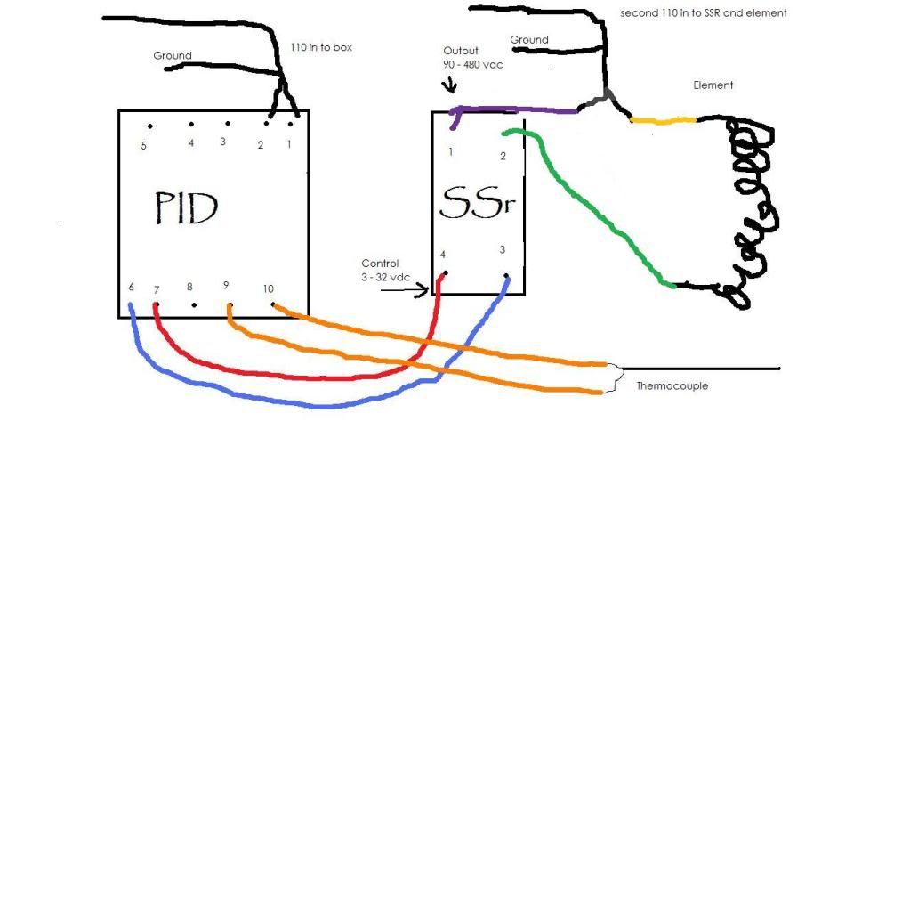

ok so here is a new diagram with a second cord added. Does this one look better?
Where do I mount the second cord so it cannot pull off the oven? also can I mount the SSR in my box.
One other thing, I have 1 of the small glass fuse holders can I use that somewhere and what size fuse would I use?
Thanks for all the help so far.
looks good to me, I think you got it.
I had a hard time putting my mind around electrical too. It was easier for me when I realized that power flows into an electrical appliance from one wire contained in the power cord and flows back out thru the other wire in the same cord.
I'm not sure what you mean abut the second cord, one cord is just for the pid controller and the other cord powers your oven and has nothing to do with the pid controller, function of the ssr, or thermocouple.
I would guess the fuse would go between your pid and ssr, don't exceed the maximum voltage of the ssr which is 32vdc. Your pid is putting out around 9 volts dc if I remember correctly to the ssr.
You can mount the ssr in the box, I would definitely use a heatsink. Both the heat from the ssr and heat from your oven at temp will be present so unless you can mount some type of heat shield between the ssr and your pid controller I would not mount them as close as your picture shows. if temp gets to high your pid will cut off and give an error message.
Another thing Omega sells connectors for your thermocouple to connect the wires. You cannot twist connect these as it will effect the temp readings.
The fuse should be 120vac and 15 amps
be careful of the fuse holder rating, the 120vc and the 12dc automotive types look the same.
put it inline with the black wire of your 120vac wall plug
If you are going to go with 2 plugs, you need to fuse both plugs.
If you want to be able to set the controller without having the elements on, you can just pop the door open and the door switch will cut that power, or you can put another switch inline with the door switch (from the pid output and the ssr input line )
this is much simpler and neater to me.

I suggest you go download the PDF instruction manual for your model a few pages down. There is a SIMPLE pictoral point to point wiring diagram using ONE cord especially since your using 120 volt for both the PID and the heating elements.
So Just run a fuse on the black wire before it goes to anything?
I am not running a door switch. I will just be reeeeeally careful :)
My PID is not an Auber. I am not sure what one to copy.
My auber, which looks EXACTLY like yours, but says Auber on the face is Model SYL-2362A2. My PID uses the exact same codes in programing 0089 for programming,0036 for PID parameters etc etc so and the wiring diagram is the same. I'd WAG that someone makes it and labels it diferently for different folks. So download, it doesn't cost you anything to download the instruction manual, and everything you will need is there from instructions to program for SSR or relay contactor(which I use) to program for the thermocouple your using (probably K) pictoral wiring diagram (same basic kind you drew up) to using it setting the Set Value (the temp you want it to cycle and keep or to hit the temp and shut off etc etc. It's a really good PID ONCE you get a grasp of the instructions!
I did not use a fuse on my ovens but I am well aware that touching the coils with a blade while the oven is on will give you a jolt. Hook it up anyway you think your capable of doing with as many safety features as possible or just do like I do and unplug it before you open the door to take you blade out. Regardless of how you do it always respect the possibility that it can hurt you. Get careless and you may pay a price just like you can driving a car or grinding a blade.
One of my ovens is 220volt oven and I have it hooked up with just one power cord and picked up the 110 for the pid using a power intended for a on/off light.
The other oven is a 110 volt oven that I use for tempering and heat treat on small blades, I prefer it hooked up using two power supply cords.
Your pid output is 3-32vdc.
Hope it works out for you.
Was reading back thru your post and you said you had a plastic box to mount equip in! OH NO! Trust me when the little bad boy comes up to temp you'll not want anything PLASTIC close to or mounted on it and that SSR will get warm to the "touch" cycling keeping temp that's why the sell heat sinks for them! lol If I was you I would temp wire 120v to the input of the PID and play with programing after reading the instructions and compare what your seeing as to what the instructions say to determine for 100% you've got the right instructions. THEY make several models some with ramp etc and those instructions will be slightly different but by playing with programing on a bench test you should be able to verify what you have. As a last ditch effort you could buy everything new you need to completely redo that oven for about $150 bucks and then you would KNOW EXACTLY what you have and still be under the grand for a new one!

You have the general idea I think from your last drawing. Like I said using two cords was the easiest way for me when I did that oven, it was my first. I have never felt the need to change it but when I got a bigger oven I wired it with only one power cord.

I think i got it, I wired it up like using two cords but I just ran jumpers from the element cord to the PID to give it power.
