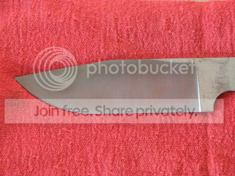

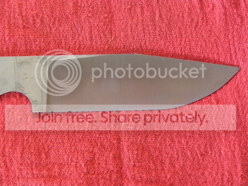

Sorry to bring this one back from the dead, but the desert summer heat has finally lifted and I'm getting back into the garage to pick up where I left off in the spring. Here are updated pics of the same blade that I worked on yesterday.
First, I tried draw filing the bevels the rest of the way in and after about an hour of not making much progress it hit me that if I'm going to make knives, I'm going to have to learn to grind better because I won't last long term filing everything.
It continued kind of like the earlier pics were going (maybe a tad better), and then towards the end I felt like I was really getting the feel of it. I'd appreciate any further advice or analysis of the updated pics. I notice that the grind line seems to go uphill, and that where the line curves from vertical to horizontal, there isn't much of a nice curve like the pros seem to get...not sure why on either count. I used a guide to keep the plunge area on track; could that have caused these characteristics?
Looks good to me too! Things will blend a little better when you do the hand sanding.:thumbup:

I spray on blue steel marking fluid and make my grind line, stay below the line. It really helps you concentrate. When you get to the finer grits its harder to make a big mistake.

You should be good with that grind if you go to hand sanding. I grind with the 2x42 too and that is about what I end up getting to before hand sanding. You'd be surprised how much that will blend when you start hand sanding. I like to go different directions when moving through grits while hand sanding, that way you know you got all of the previous grit scratches out. Also, the more flat and wide your hand sanding tool, the better. Especially when sanding the long ways. That grind looks pretty flat though. If you do end up with low spots from the grinder, you can file them out if they are not too deep. When I end up with a low spot at 2"...which is often, I use the file to even that area out. Keep it up, your grinds are looking much better now.
To me one of the biggest hurtles for a person to get over when learning to grind is trying to make a knife. The key is to decide if you want to learn to grind or to try to make a knife. The paint sticks and mild steel are great for learning to grind because you are learning to control the metal and the grinder and know that you are not trying to make a knife. It gives you the freedom to try to straighten out a grind without having to worry about where the edge is, how thick the blade is or the plunge cut. Learning the control necessary to straighten one out will give you the ability to grind one without screwing it up to start with. If you spend some time doing deliberate grinds on scrap that you have no intention of making anything out of, you will be amazed at what you can do when you try out a design on some good steel.
One other thing about grinding is that it will feel more natural to grind one side of the blade than the other. Start on the weak side first. Once you have developed some skill with your weak hand the strong hand will be much easier. If you start the other way, the weak side will be murder.

Maybe it isn't obvious so I'll say it. The spine and edge are parallel, or nearly. The only way for the grind to not reach the top near the ricasso is for the grind angle to be steeper there, so the grind has a twist in it. You may also have a hump there running top to bottom.
A thing that I learn a lot from is putting marker or dykem on the blade, and either grinding a pass, or carefully and lightly placing the blade on the belt, flat and parallel, in one spot, or placing an area of the blade I'm wondering about on the belt with the machine off and dragging it down the platen an inch.
If I need to be really exact for part of the grind (last little bit of the plunge cut, for example), I hold the blade with thumbs and fore fingers or thumbs and first two and get the other fingers on the back corners, edges of the platen/platen frame for steadiness. That is what I do if I find a top to bottom hump at the ricasso.
