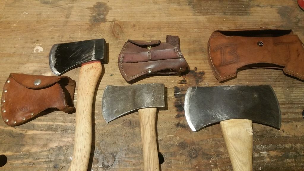

Stamp says made in USA when you zoom in. Edit: actually just USA, wonder where it's made?
I regret buying a similar Plumb broad hatchet 6 years ago, it was made in Taiwan and the heat treatment was crap.
