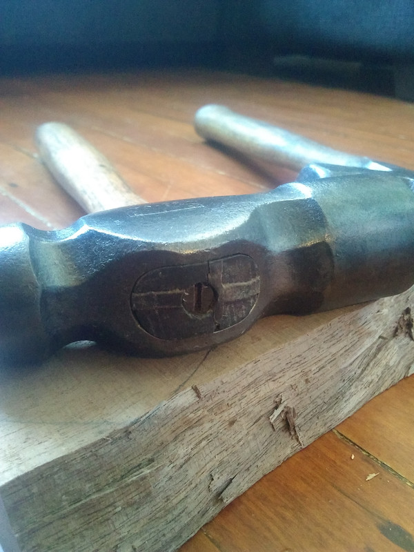

I, for one, would be quite appreciative if someone out there could figure out a way to create or reproduce those 'take-up' screws. I can see theme being very useful on hammer (oval eye) hangs.
I think for 11$ you can do better by finding distressed PLUMB tools and refurbishing them and reusing the screw. For much less I have found 16oz claw hammer for 2$ a 16 oz ball pien for 3$ and the flooring hatchet in this thread for less than double the price of two screws on e bay. The hammers are in 95% condition the hatchet has never been used.
Looks like one could be made by cutting off a wood screw/lag bolt. Then file/cut the slot for a screwdriver. I don't know how the taper would match to original and how effective the homemade would be. Might be more bother than it's worth.
The Plumb screws are tapered over their entire length where wood screws and lag bolts are tapered for about 2 or 3 threads then parallel for the remainder of the length.This does not really address your post, but...

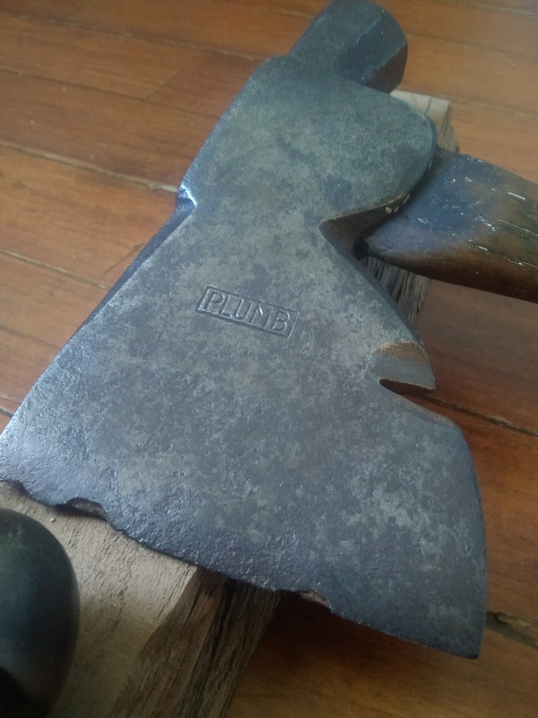

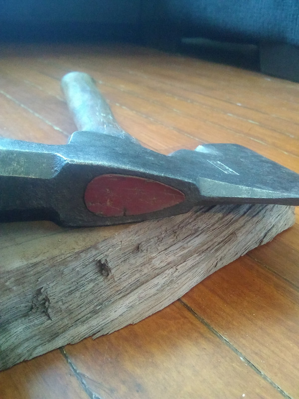

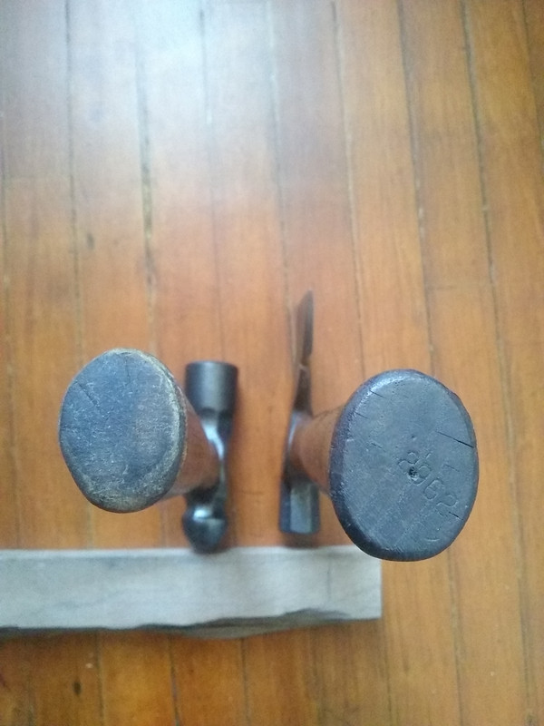

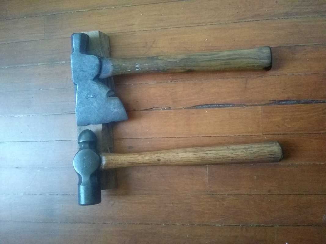

I'll contribute my pair of Plumbs.
