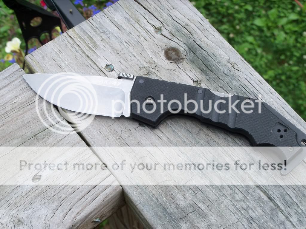

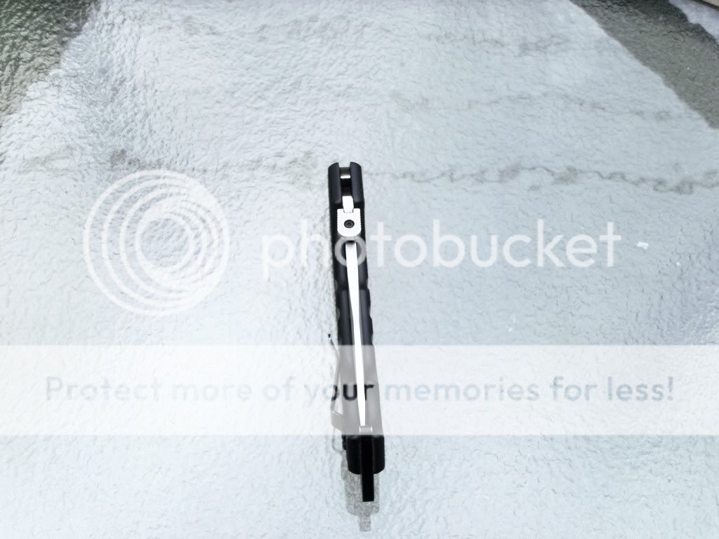

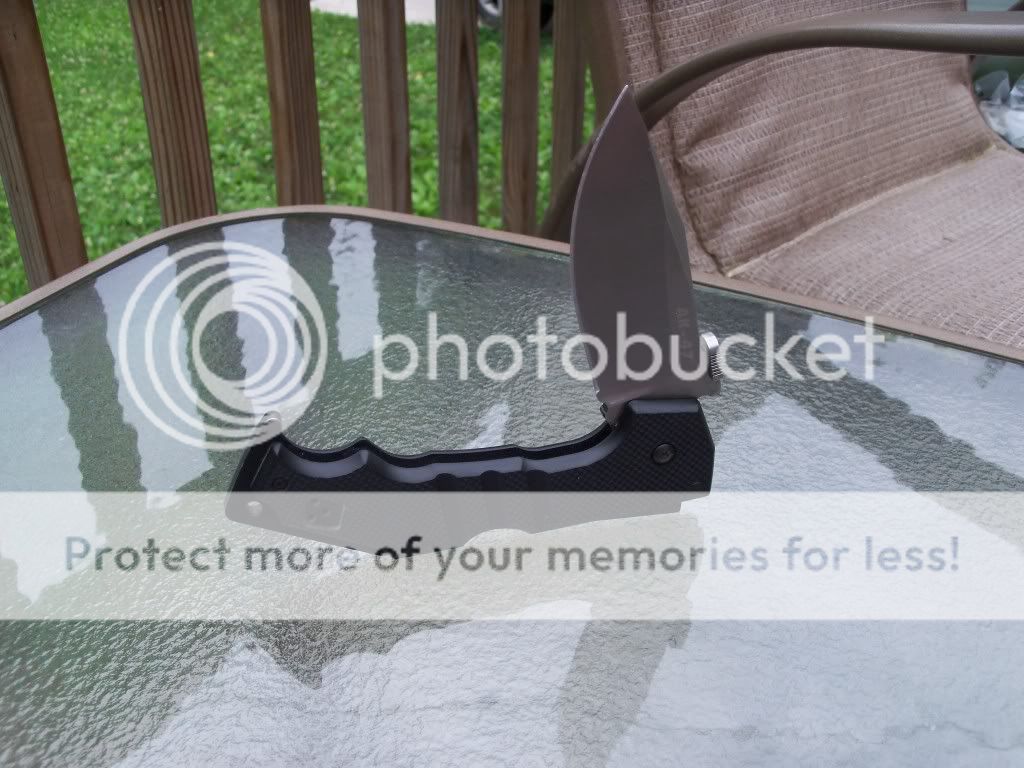

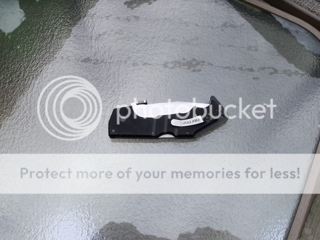

Just got this FFBM Friday and wanted to try this ever since I saw Soup Mongers original thread on his FFBM. I used Kuttit paint stripper to take the coating off the spine. I masked off the spine and handles with tape and applied a small amount of the stripper with a small artist brush, it worked. Then polished it up with 220, 320, 400, 600 grit sand paper. It's not as good as Soup's but it'll do.

Did you round off the spine?... or is that a trick of the light?

Thanks. It's no trick, the spine was rounded off from the factory, I thought that is how all FFBMs were.
