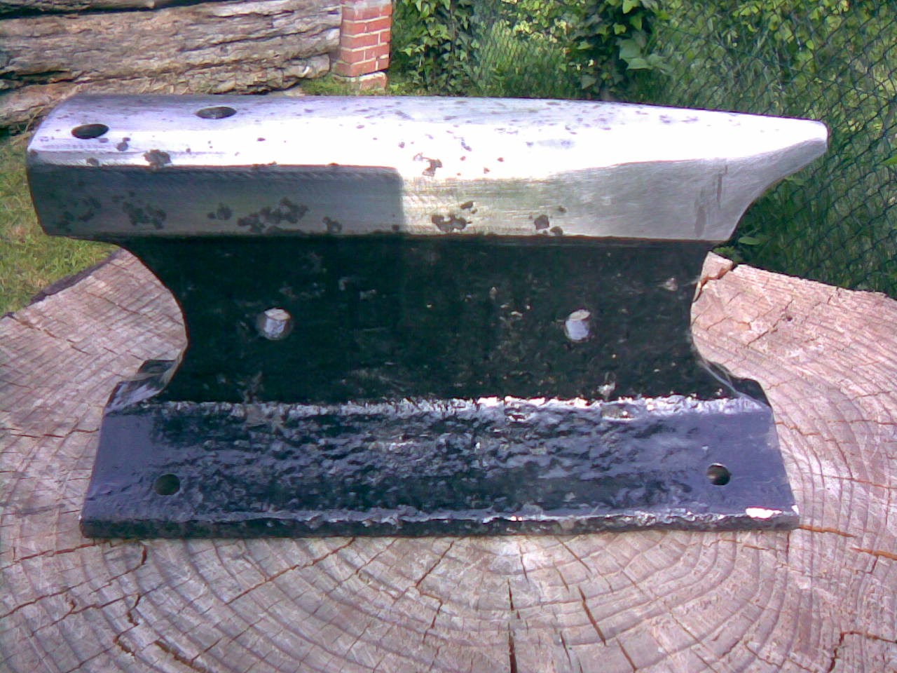

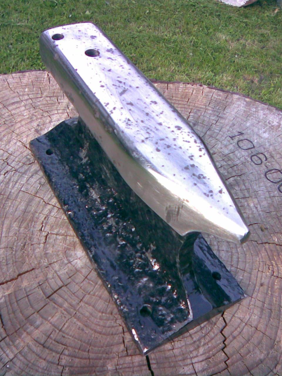

this is mi little RR anvil. too light to forging but good for pins and other light works. I'm looking for a 50-60 kg post anvil.
How did you shape that? I have a similar piece just as cut, square on both ends and I'd love to mod it to what you have.
I don't have pictures atm but I use the top of an old craftsman tablesaw which died. I don't forge blades, but I do use it from time to time for soft metals and such.

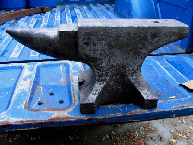

Then, a month later, I put an ad in the local online buy/sell that I was looking for an anvil. A guy contacted me a few days later and said he was getting out of knifemaking and had one for $25.00. Needless to say, 20 minutes later I was driving home with this
with an angle grinder and a lot of time. the final result seems good to me but I know I'm not objective. :)
Teknition, your RR anvil is unbelievable!!!!!!! please don't tell me you did it by hand.

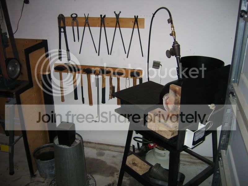

Mine is a piece of 1045... 4x4x14... burried in a chicken feeder... lol
I also use a few other anvils... that is my hot cutter on the far right...

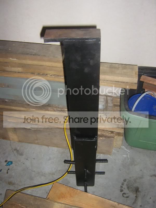

I guess this one will qualify as homebuilt, 22# of lead poured into the rectangular
tube, top is 3/8" thick x 2 1/2" 440c barstock that I drew back to mid 50's Rc, been
doing pins on it for about 4 years no problems. Sometimes the 125# Trenton below
it sees use.
Ken.

I keep thinking about it and there is something I have to say. Regarding IG's upside down RR track anvil....I love ya bro and I mean no disrespect..., but I have forged on that upside down chunk of rail and...well....it sucks!:rolleyes:
There...I said it.;):p Please understand I do not chide George for his anvil...I applaud him for trying something new. However I think it would work much better if it was just fliped over. IG, don't be mad:(....I'll buy you a cheap beer!:thumbup::D
