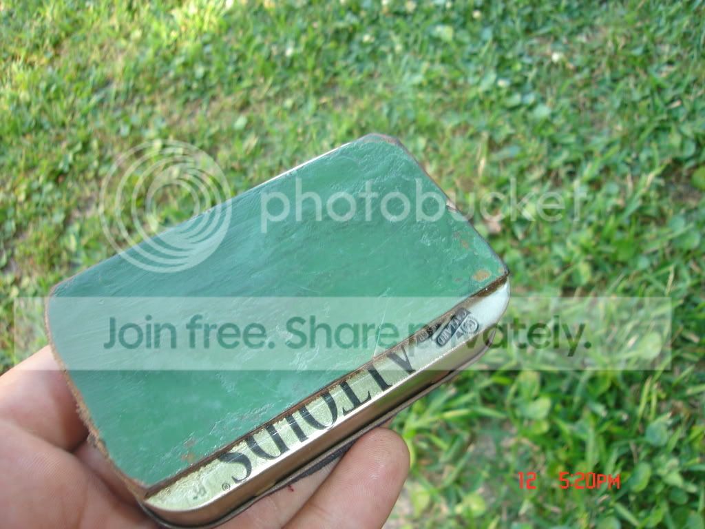

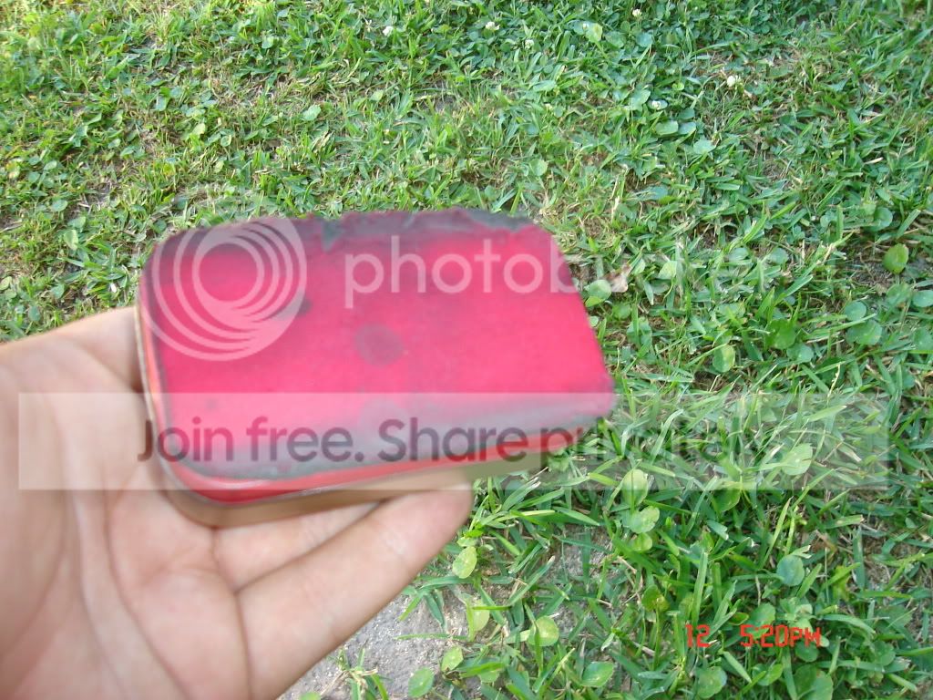

get an altoids tin cut a piece of mas pad to fit the top and gule it in place... on the bottom of the tin glue some leather.. precut wet dry to size and store in the case.. lay the wetdry over the top of the case and close the lid on overhanging ends... you can resharpen a convex edge with ease. flip it over and you can strop to maintain.

I gave the altoid tin thing a try, and it didn't work for me. The lid of the tin is too flexible, so it wouldn't really give me a flat surface upon which to strop. There was always some concavity to the glued-on mousepad that annoyed me. Just my experience. I've also tried the paint stick strop like in the KSF videos, but they just never seemed to pack away right because of their length.

Brilliant. I love it. I might have to make myself a regular altoids one and one of these.
