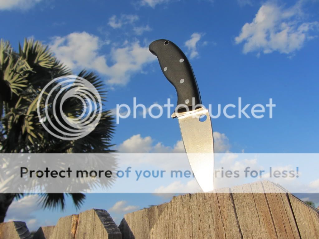

Here is the Elmax mule I had sent out to Blackcatt. He did a great job with the black g10 and they kydex sheath.

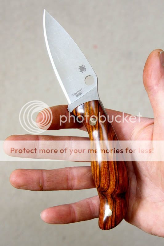

xavierdoc--------what degree bevels are on your m390 ironwood? looks like a crazy slicer!

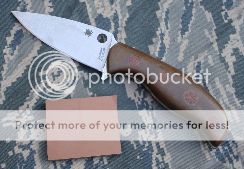

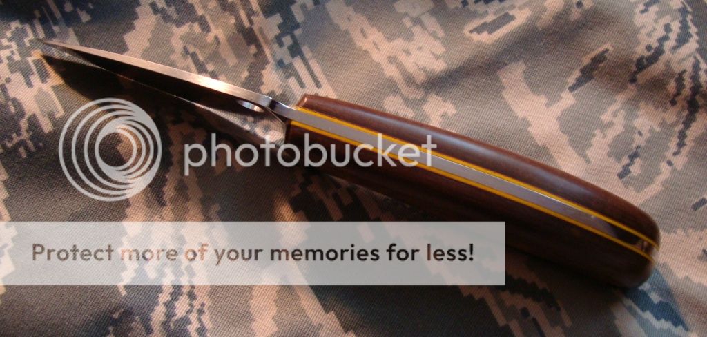

This is my Mule in CTS B75P. The handles are butterscotch paper micarta with yellow fiber spacers and micarta pins, all held together with two-ton epoxy.
There are some features I can describe as halos around the holes. The micarta was 3/8", a bit thick, so I ground some away and the halos are not as noticeable, and they smoothed out nicely.
The outside color of the micarta was nothing like the color that resulted when ground, and the website stated as much, but I would've preferred to use something else. But, I used what I had and it came out all right.
I used the fiber spacers because it seems that the sides of the handle are not quite flat. My M390 Mule was the same way, and it left gaps at the front of the handle. I took that one apart to live another day. With this one, I epoxied the fiber spacers and handles on and clamped them down very tightly once the micarta pins were through, hoping that the fiber would essentially fill-in any gap.

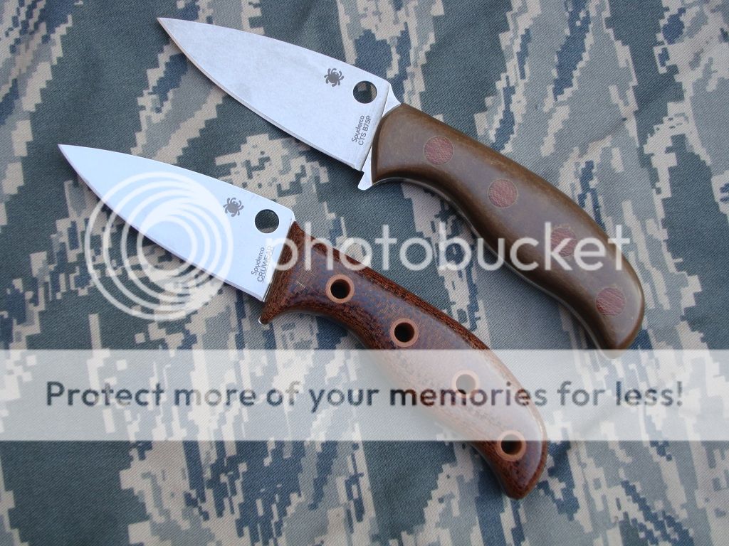

A family pic, with my Cruwear Mule in barbwire/burlap micarta and micarta tube. The M390 wasn't dressed appropriately for this environment...

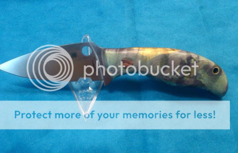

Here's the first one I made, Redwood Burl on my S90V Mule with mosaic pins:
