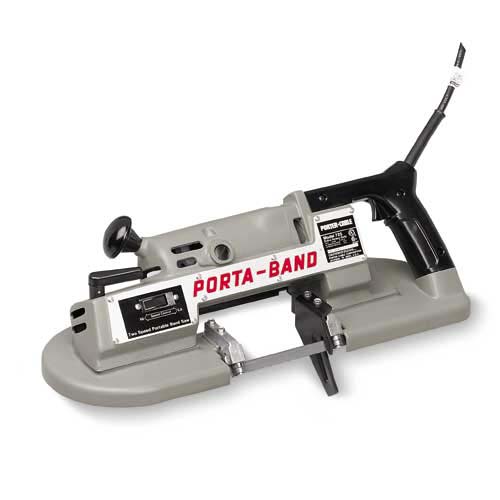

Have a look and see if your dad has one of these

it'll munch right through your A2.
