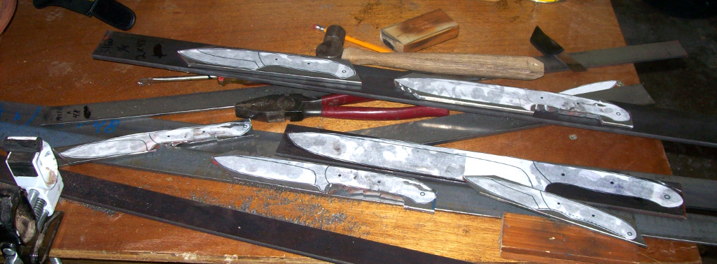

If you use the right blade and a decent sawzall, you can get good results. I sawed all of these blanks out of 1/8" and 3/16" 1084 in less then an hour and I'm pretty sure I was still on my first blade when I finished.
That being said, a sawzall can be very dangerous if you don't know what you are doing. It takes practice to use one safely and effectively. CLAMP YOUR WORK DOWN and use a slower speed. My sawzall has 6 speed settings and I usually use the 2nd or 3rd lowest. I use the 4" version of the DS0414BF (on this page: http://www.diablotools.com/recip-metal.html) but only because I can get them locally. They run about ~$3 ea. last time I looked.
One note, while this works well on the 1084, I tried cutting some 1/4" 5160 and couldn't cut it.
