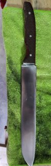

Good Afternoon Everyone,
I am new to making knives and absolutely love it. I know there is a ridiculous amount of information to learn, and would love some tips and tricks. I am learning the freehand grinding techniques and primarily working with O1 (old files) and 1095 steel. My question here is the process right before heat treating. Thoughts or tips on a process for getting the scale off the blade after normalizing and heat treating both. Something to make it easier if that exists. I tried cleaning up the blank and wiping it down with mineral oil right before heat treating (after normalizing three times) and the scale from the oil seemed to come off quicker than any other time I have made a knife. This is probably my 5th knife or so.
An old file (O1)
Single burner forger for heating
Peanut oil for quenching
This thing is 14" long with a 9.5" blade roughly.
I assume there might be some detail that I missed, and will provide additional detail if needed or asked. In addition, open season on feedback of the knife. Good or bad. That is how I will learn
Thanks
New to all of this, so there is most likely a better way to post the picture of the knife. I might figure that out eventually
For future knives
A couple things I see:
The step down from the spine is unnecessary and not a good idea. The spine should go straight onto the handle tang.
Unless you have six or seven fingers, there is no need for the extra bumps in the handle. One simple and not large palm swell is all you need or want.
The handle also looks excessively long. Look at some pictures of knives made by the major makers for some ideas of a proper handle shape.
The overall knife is quite "stiff" looking. A slight drop to the tip would soften that a lot. By dropping the point about 1/4" more and making the curve from the spine to the tip gradual instead of angular the blade will have more "flow".
For future knives
Good to know. Thank you very much Stacy. I will correct that in the future. I will also adjust the handle design. I am guilty of trying to add a "cool factor" but probably sacrificed something. Thank you for your input

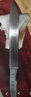

Oh, that is great advice, and I didnt know that. That changes a lot as I was misinformed. Then it wasn't O1. It was an old Nicholson file that I made that knife from. What kind of steel is that usually? It seems to have hardened well as the file does skate across it and after the tempering it came out a golden straw color on 100% of the knife that cleaned up pretty well with just a scotch brite belt.SmartSelect_20210117-134647_Gallery.jpg
