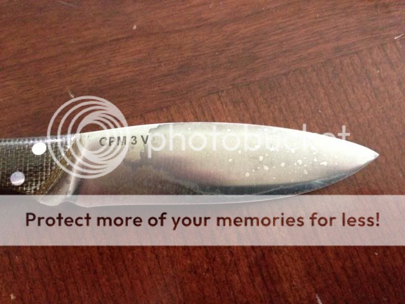

Very cool, knife chop, thanks for putting the pics up.
Have you put a patina on 1095? Is 3v any more difficult?
I forgot to mention that the knife isn't mine. I took it straight from this thread. http://www.bladeforums.com/forums/showthread.php/1212683-Does-3V-patina
I'd say 3v will patina but it will take longer than 1095. Guy or Ellie can correct me if I'm wrong but I've read somewhere that their HT protocol for 3V is similar to Dan Keffler's which increases corrosion resistance without sacrificing toughness and edge holding.
I tried everything to get a patina on a 3V blade and it was never visible. A2 and 1095 patina quite easily.
I've had 3v change color slightly in some spots after cutting up a bunch of onions. When I cleaned the blade, there wasn't much of it left, and it was barely noticeable.
Was also very easy to polish out. I don't really consider putting a patina on 3v because I don't really think one will take.
