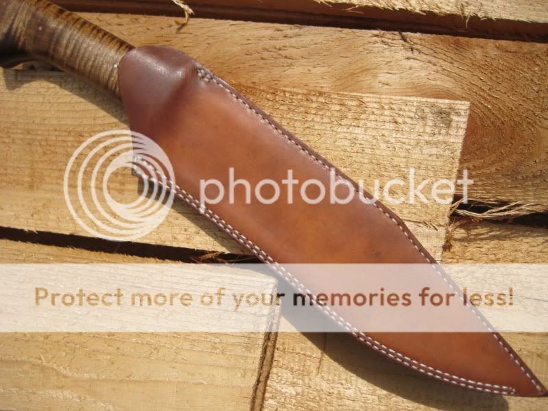

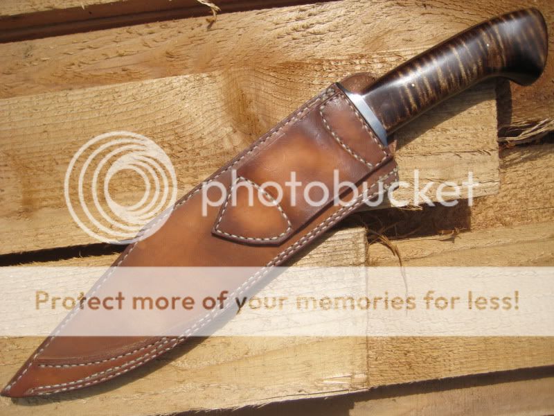

I bought this knife a while ago, and it came with a sheath that didn't seem much good to me.
So I made one.
My skills are improving, but are still far short of what I've seen around here.
But I enjoy working with leather, so it's all good.

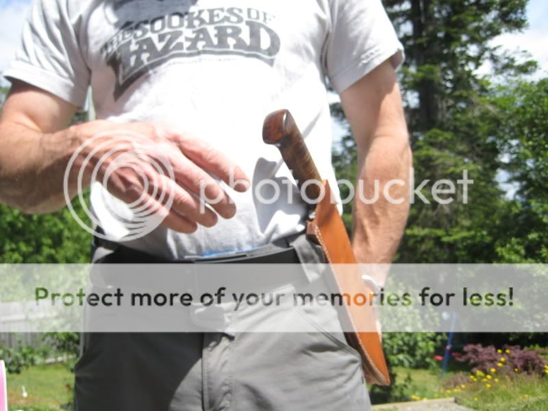

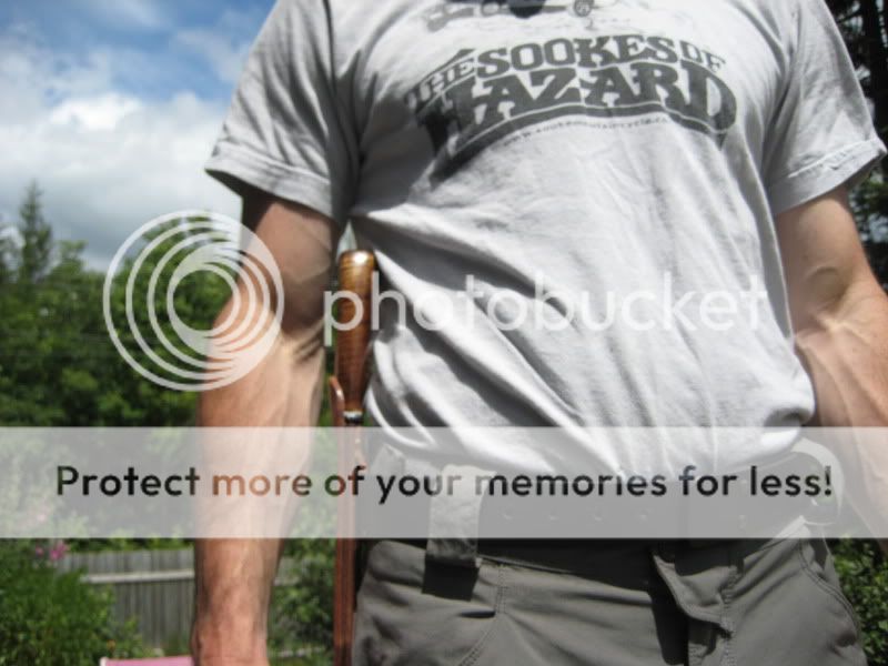

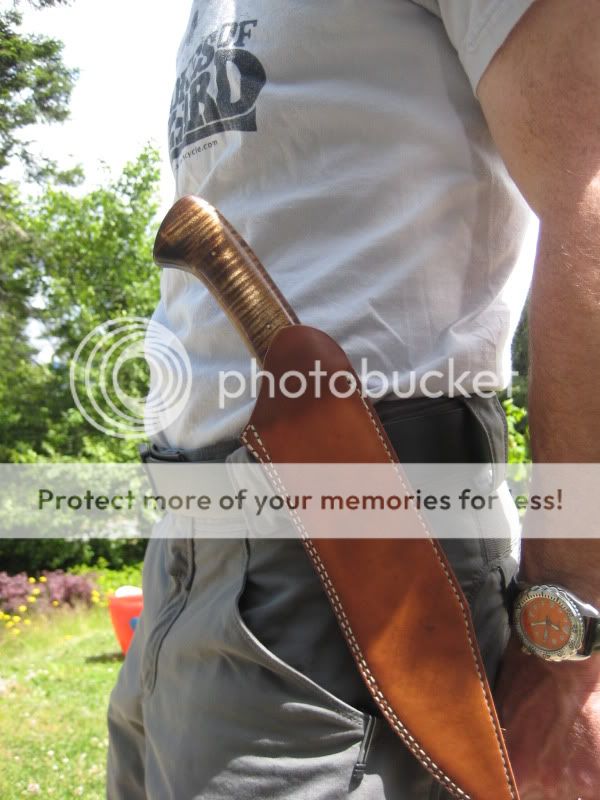

The belt loop was designed for cross draw or regular.
Really nice work on the sheath Lorien, and a terrific knife by Terry. What's the wood?

Thats a Terry Primos bowie? Thats a keeper, Rare nowadays. Nice work on the sheath, it goes very well with this knife.
You did a FINE job.....great looking sheath and looks hell-for-stout.....comfortable, too. :cool:
That came out great! Looks very functional and well put together. Bravo.

Wow, nice work Lorien, that's easily the best I've seen from you to date. Great shape and stitching. Very nice work!

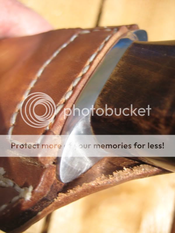

Great job, looks like you're about ready to start selling them! :D Is there a drain hole near the tip, where there's no stitching? I'd maybe bevel the edge of the flap that shows some wear from the guard<?> but that's just being nit picky.

All I see when I look at the sheath are my mistakes. It's a burly sheath, but I think I need to step it up a notch in the f&f dept. Once I have a little more faith in my skill and knowledge, maybe I'll get some really nice leather.

ps. Jose, I just saw your post, and you're right it is a drain hole. Haven't tested it yet, but it should work ok. Not that I'm going to let this knife get exposed to much gnarl, after reading Bruce's post!

If you make the loop a little bigger the knife will still stay put but it will pivot and free float you can also tip or cant it to sit down or just ride at the angle you want it to.

Joe, a lot of the design planning here had a ton to do with the things you've said about carrying a bowie. I take it all to heart, but now that you mention the pivot, I realize I hadn't paid enough attention. You've spoken of that pivot previously, and I didn't address that well enough.
Won't make the mistake of paying no heed to the words of Joe Paranee!
This sheath is not the greatest for sitting down. The belt loop is too tight to allow the tip of the sheath to swing in being you when you go 90 degrees. It might loosen up a little over time, but still, next high ridin big sheath I make is gonna pivot, g'all dang it!

I have carried big knives for a long time and I have experimented alot
