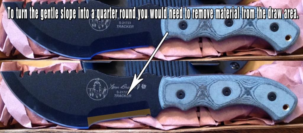

Specifically he was not happy with the quarter round portion of the knife - the transition between the hollow ground draw knife portion and the convex front portion of the blade. Regardless of whether or not I liked the regrind, the customer didn't.
So now I am trying to figure out an artful way to make the transition between the hollow ground draw portion of the knife and the convex portion. I think I have figured out what some of the technical problems are by looking at other examples of the knife. I am certainly open to suggestions and ideas.

Notice on this knife that the quarter round area isn't really a quarter round at all, it is a gentle slope sort of working it's way up to the front portion of the knife.

Without reducing the height of the draw portion of the knife, I will not be able to turn the gentle slope on the stock model into a quarter round. It may be my own bias, but I have not found the quarter round feature of the knife to be useful anyway, but the customer is always right. Indeed, the original version of the knife doesn't have a quarter round. My favorite variant, the M-18, doesn't have a quarter round either.
So anyway, that is where I am at with this particular problem. Without investing in a mill, I won't be able to make the hollow grind turn a corner. Even if I had a narrow wheel, I'm not sure I would be able to grind that corner perfectly anyway. In my opinion, the knife performs better with a full height convex grind up front with a hollow ground portion towards the handle. There really isn't a point, in my opinion, of stripping the paint off of the existing TOPS grind lines and putting a little sharper edge on the blade. In my opinion the edge geometry is what will make a difference in performance.

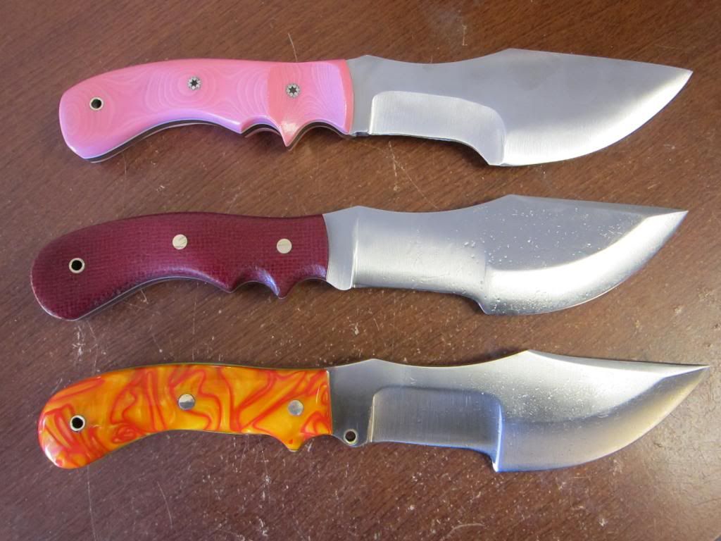

And I see where you are coming from. Regrinding someone else's knife could be risky. But I have to say I admire your strength of character in making it right with the customer. That says a lot.

If I was going to make my own version exactly to my own tastes I would do the grinds the same, make the draw portion only 2 inches wide and make the whole blade about 3/4" longer. I would make the handle to my tastes but taper the tang. If I ever do make a run of those I'm not selling any of them unless someone holds one in their hand first. That may have been my problem in the first place. I made the assumption that the guy had handled Dwayne's. I won't make that mistake again.

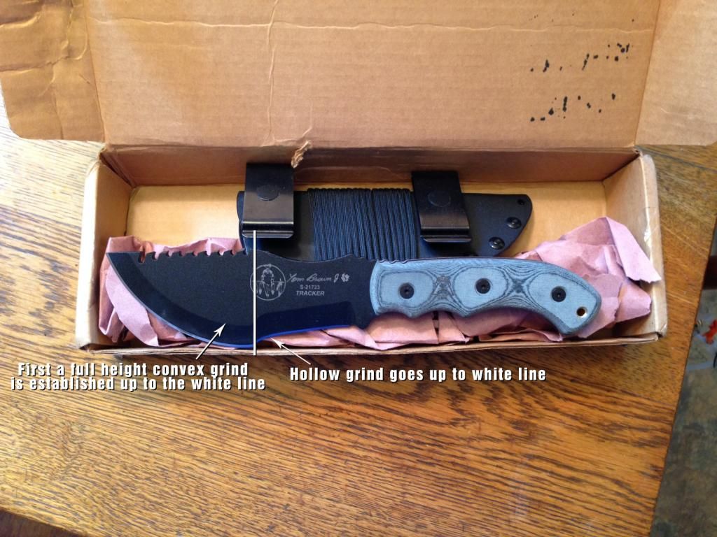

Here is what the TOPS model would look like with a true quarter round.

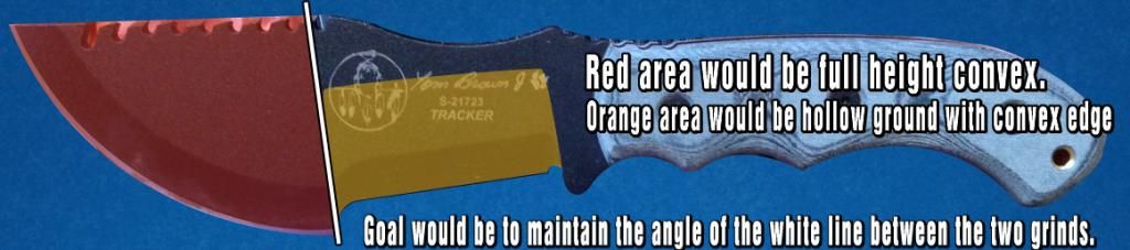

After establishing a true quarter round, the next step would be to grind a full height convex grind in the front, followed by a hollow grind in the draw area. I would try to maintain a line perpendicular to the draw portion of the blade as the separation between the 2 grinds.
One concern I would have is that by the time you remove enough metal from the draw area to establish a quarter round, you would have a VERY thick edge. In order to make that edge nice and sharp again, the hollow grind would have to be fairly deep. I worry that the hollow grind would feel weird, given that the blade is like 1/4" thick.
The other thing I would worry about with this grind would be the vertical line. Whoever was getting that knife would have to understand that the line would be there and that the hollow grind would NOT turn the corner. It would look a lot like the BRKT version.
Finally, there is a LOT going on with a knife after regrinding it like that. If you were to take calipers out and measure every grind line and every little spot, you are going to find flaws. If I had to guess I'd say the production models are done with a ball mill and NOT by hand.

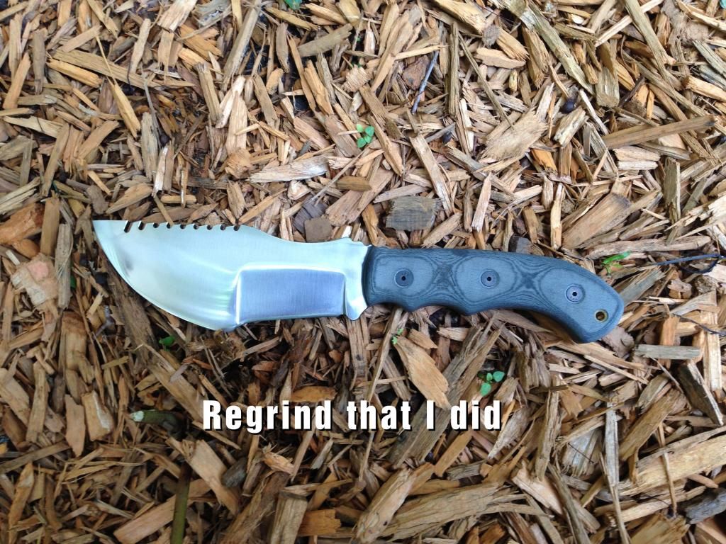

1st generation TOPS Tracker that I reground mostly with water stones. I pulled back the draw knife edge and formed a quarter rounder. The transition slopes upward and required hand tuning with a slip stone to get it right. The draw knife edge required a decent amount of metal removed to cut the gentle slope in to an L. Once the L was formed I had shape into a J by rounding and angling the corner. Hope that makes sense. It's by no means a large quarter rounder (like Dave's WSK) but it works really well for it's intended purpose.
Before:
After:
Another thought that comes to mind is, you really have to look at it like three edges not two. First is the Draw knife, then a 3/8 or longer curved cutting edge (the quarter rounder). The QR starts just above the draw knife and ends below the hatchet. It also blends the two larger edges together. Then you have the hatchet edge.
Sounds obvious, but if you look at it like blending just two edges, it will be an abrupt transition. All three edges require their own work and angles.
It is that third edge that you are describing that is problematic. That has been my dilemma with this knife from day 1. Making that draw portion turn the corner is a real bitch with my current tooling. Plus, if you full height convex grind the front portion of the knife, there would still be a bit of a vertical line between the draw portion and the axe portion.
One solution to that would be to keep a partial height convex up front in order to have a line to grind to. When I have played with these knives before the grind that I thought worked the best was the full height convex in front with a hollow ground draw portion in back. In my opinion only, if you are going to go to the trouble of regrinding the TOPS, I wouldn't compromise on having the full height convex up front with a hollow grind in the draw area. I haven't figured out a way to have the best grind combo (in my opinion) with a hollow grind that turns the corner and a true quarter round. The Bark River version of the tracker performed the best in my hands anyway, so for me it is easy to compromise on the desire to have a third edge. Mind you, the Bark River in the photo above doesn't have a full height convex, but I've played with one that did. It was bombass.
