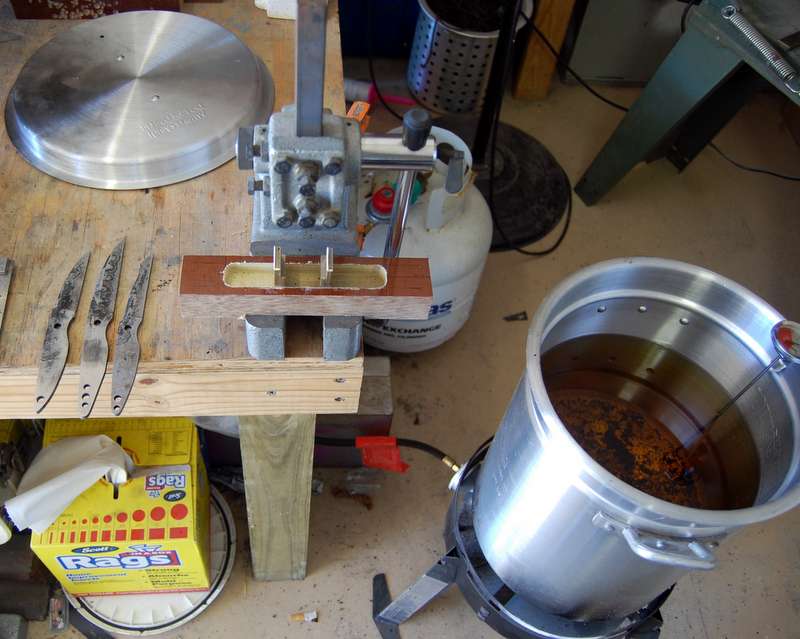

Hey Guys I really appretiate the feed back, I HT'ed all three blades, first thing this morning I took them to 1500 degrees then shut down the oven and crack the door slightly. I then went and did some thing else productive like building a jig to help me straighten my blades.
I then HT'ed one blade at a time bringing it to 1500 and holding until non mag, then vey quickly straight in the 120 degree oil.

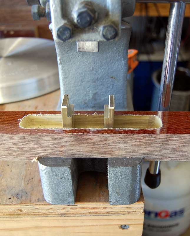

I very quickly got to straighting some minor warping, funny how your eyes play tricks on you but the surface plate never lies.
Success is great if you take the time to pursue it!;)

Simple jig from micarta and brass

I also currently use a forge and a pair of tongs. I used to have an evenheat and made a basket out of chicken wire in the quench tank, I would snip the heat treating foil and let the blade fall into the basket then I would raise and lower the basket vertically until the blade was cool.

Great to hear SAR: I know 1500 would do it. Great looking setup. I can not let me wife see that setup, she may want you to put on a turkey to fryer. Have a good one. Thanks for showing it to all of us. :):thumbup::D
