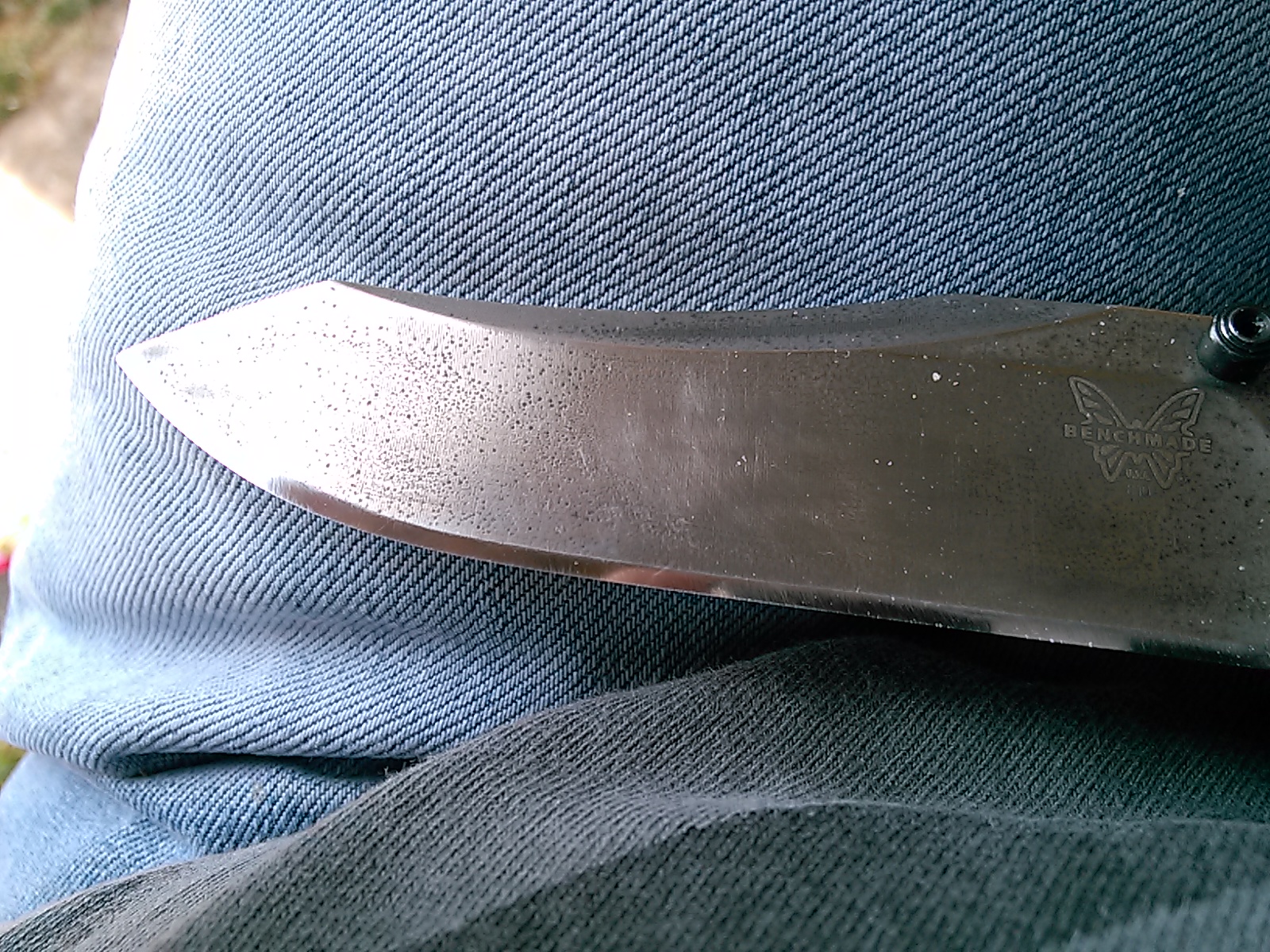

I absolutely adore my 810. As you can probably tell, I use the thing every day. I don't baby it.
A while back I made the mistake of lending it to a coworker and he snapped the very tip off. I have it sharpened at about 25° inclusive. The knife is still very sharp but the chips are bugging me enough to address them. I don't know how they happened, I haven't paid close attention. I just strop and go most of the time.
I was thinking about running the entire edge 90° against my Norton SiC stone to remove the chips, then use the EP to restore the edge back to its initial angle. Does that sound like a plan, or would you recommend a different procedure?
Thanks guys.

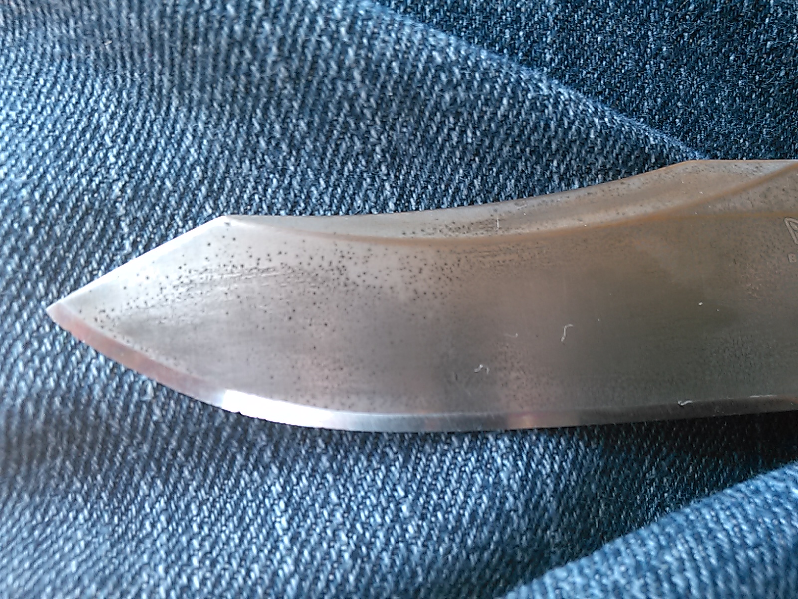

Okay, I ran the apex over my stone until the chips were gone. I then sharpened it at 25° then gave it a 30° microbevel. It's cutting like a champ again and doesn't get hung up on annoying chips. :)
Thanks for the advice guys.
Holy sweet baby Jesus that looks awesome. :thumbup::eek:;):cool:
My contego needs a new edge but it's part serrated so it'll never look that nice IMHO.
Great job man! turned out sweet and you are right, those chips would get annoying! most of my kitchen knives are rough shape, with the exception of me keeping a few razor sharp. But my EDC is always arm hair shaving on a day to day basis, with NO CHIPS :mad: hehe great job! :thumbup:
Lookin good. Your contego sure is getting some pampering recently. I bet the ol girl feels like a million bucks again.
