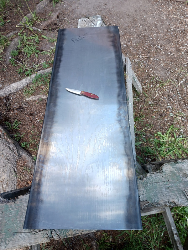

This is .196" thick, and feels like a Beast.
How much thicker do You want?
I can't wait till I get my hands on something less than .090" thick.

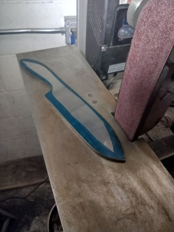

Can anyone comment on how how ProCut grinds post heat treat?
At nearly 64 HRC, I'm wondering how many extra belts I'll need.
