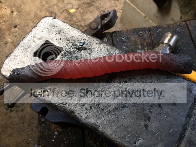

I cleaned it up on the grinder and then made sure it was fluxed and good and hot before I (hopefully) fixed the welds. I saw no bad spots when I was done. I then brushed it, fluxed it, heated it, and twisted it three times until we got to this point:

You have some sacrificial metal on any billet. You have to be a mench and cut it off. Twist has a good inch or more waste on each end.
The trick to getting the ends ( or any resistant area) to twist evenly/fully is having a friend hold a torch with a large flame on the trouble spot to keep it slightly hotter than the rest. As the main part cools to red and resists twisting, work the trouble spots with the torch and twist them tight. You can get within an inch of the end that way.

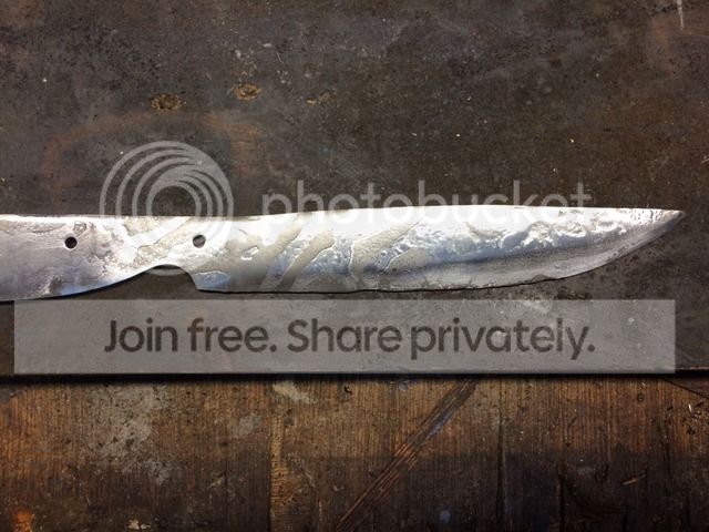

Once I smoothed this out on the grinder, it ended up quite a bit smaller than in this picture. Since I used the last bits of 1095 and 15N20 that I had on this, I will most likely not attempt another layer damascus hammering it by hand.

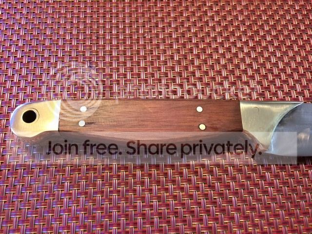

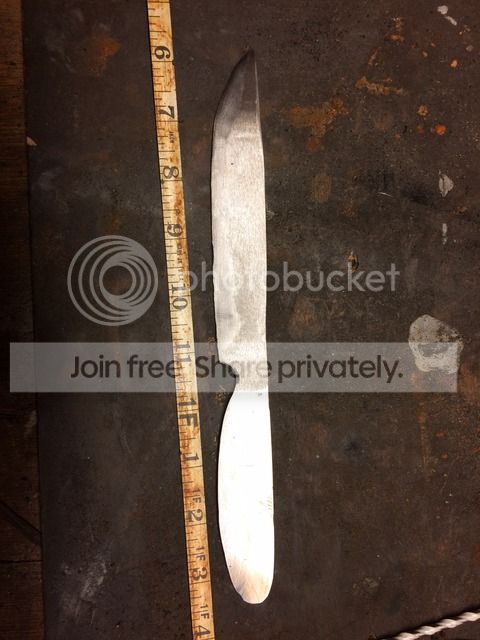

Here it is as of right now. It has not been heat treated. I can't decide what to do about the handle.
PS: I am still working on the assigned knife, only with a bar of 1084.
Take some of the belly out of the handle and put in first and third/fourth finger choils.
Looking good. I want to offer a suggestion, and please only take it as a suggestion as this is a matter of opinion or preference. I struggled a bit when I first started, shaping handles in an ergonomic way. I think in straight lines, and a lot of my early handles had similar profile as yours. What I found was that a large swell in the center, depth wise, really wasn't conductive to a good normal grip, again, in my opinion. I just sketched this as an example. The top being similar to your design, the middle replacing the swell with a choil, and the bottom moving that choil to the index finger.
Something like a combination of the second and third one.

I did a mock-up of the handle in wood to see what it would feel like in the designs you suggested. As I suspected, it made the handle feel like nothing in my hand. I decided to go ahead and drill holes for a handle and then heat treat it. This is what I ended up with:

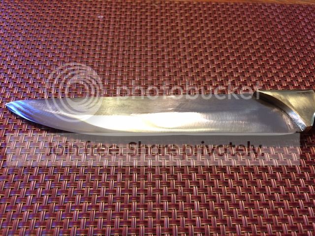

This is after heat treat and after sanding:

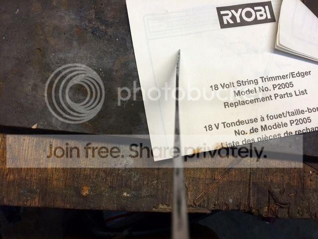

Not only is the blade very very thin, but it has a built in right turn:

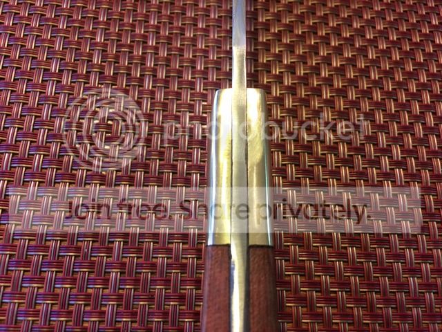

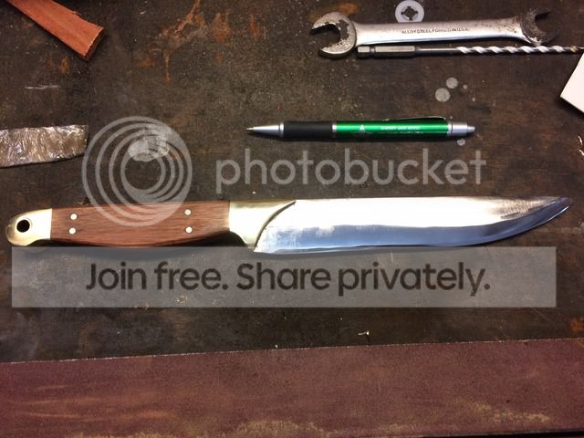

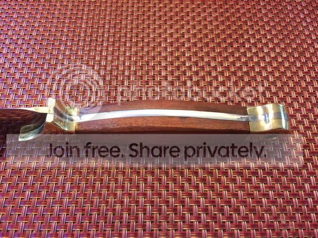

Here is my completed homework project. Note that this is not the damascus blade, but it is made from 1084 steel:
Not bad.
What the handle needs is some rounding. The basic cross section is very squared off. The corners should be rounded into slightly curved sides, and the bottom should be slightly narrower than the top. The overall cross section should be somewhat egg shaped.
