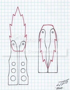

I have yet to make a bali, but here's an idea I had while reading this:
I hope it helps!
Hmmm... that is interesting. I'll try mocking it up (probably this weekend) and see how it works.
At the moment I'm working on another idea I had. I went back to nature for the idea, and one came... so I spent a little time yesterday cutting out the parts I need for it. If it works out, the project would go back to being a fixed blade, but the all-thread tang would be gone. Basically, the idea is to have two small smooth-edged "leaves" become the guard, and integrating them into a tapered tang that is sculpturally integrated with the blade. I'll draw out what I'm thinking and post a picture if I get the time. I've been awfully busy at work this week.

As you may recall, my original idea was to use a welded on piece of all-thread as the tang. When I was advised that the way I'd done it would yield a very weak knife, I decided I had to change course. I considered the balisong approach, but hit s snag there too. Someone offered up a balisong handle design that solved the problem, but was too clunky and awkwar feeling in the hand.
I decided to attach an extension to the ricasso. It took three attempts, but I finally came up with one that seemed to work.
