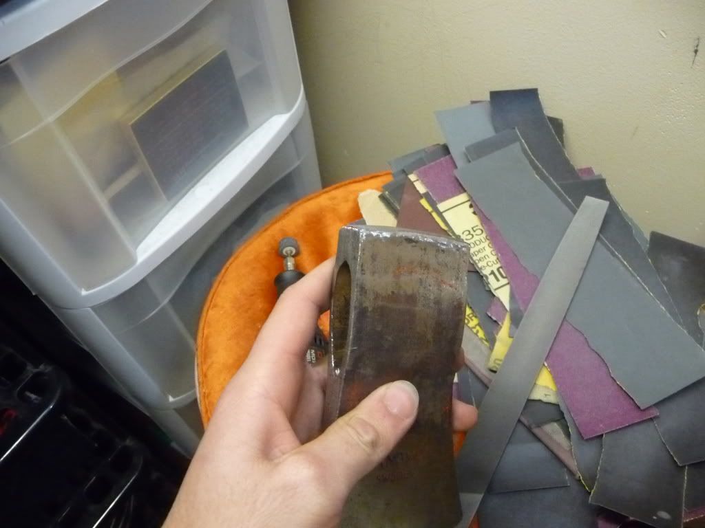

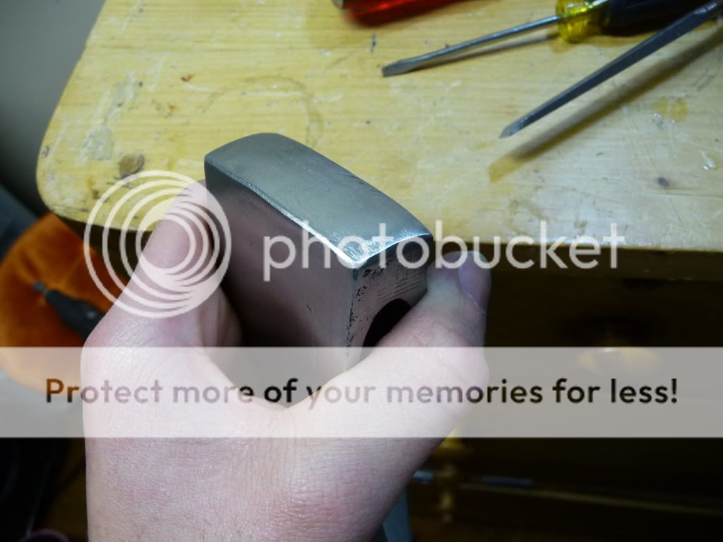

The first order of business for me was to fix the badly damaged poll as best I could. It was pretty badly mushroomed over from being pounded on with a hammer - something I've already convincing my grandfather to not do after I get this back to him. As I'm without any stationary tools, I used a grinding wheel attachment on my dremel to do most of the work - it's a great, significantly cheaper alternative to a grinder or belt sander so long as you're wary of it's ability to mess with the temper if you go crazy with it. However, I wasn't anywhere near the cutting edge and even then, I only did small, quick strokes and kept feeling the metal to ensure it stayed cool. Here it is with the back end ground to shape. In the back, you can see my tools: the dremel, a nicholson file and used sandpaper from convex sharpening that I keep around for these sort of occasions:
I then moved on to removing the paint and rust. My original plan was to strip it, but I found the pitting and grind marks underneath to be off-putting. Soooo, out came the dremel again, accompanied by a file. After I did some light grinding, I then spent A LOT of time using 100grit paper to remove the grind marks that I made. Note the insanely darkened hand:
I then fixed up the poll some more with the sandpaper then chamfered the edges with the file:

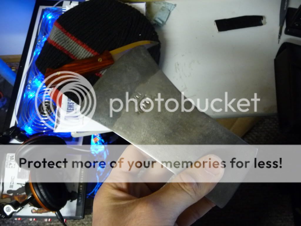

I then moved on to 220 grit sandpaper and after some sanding, found something QUITE peculiar: a hamon line! It's exactly where I can feel the sandpaper's "bite" deminish so it's clearly the transition area between hard and soft. Here's some pictures - it's somewhat faint on the "0.6/ 1 1/4" side, but quite visible on the "sandvik" side:
I then took my nicholson file that I know quite well and tested the poll and edge. The file bit hard into the poll but not very aggressively into the the edge - it skidded ever so slightly unless a decent pressure was used. From my experience using this file on axes/blades with known hardness, I'd estimate that the poll is in the low-mid 40s and the edge to be about 57-58 hrc. To double check, I then tested the file on my GB Scandi (which is known to be 57-58) and the edge on this hatchet definitely feels similar (perhaps even just a wee bit harder). I'm guessing it's a single steel deferentially HT'd and not a welded bit, but I don't know my axes well enough to say for certain:
