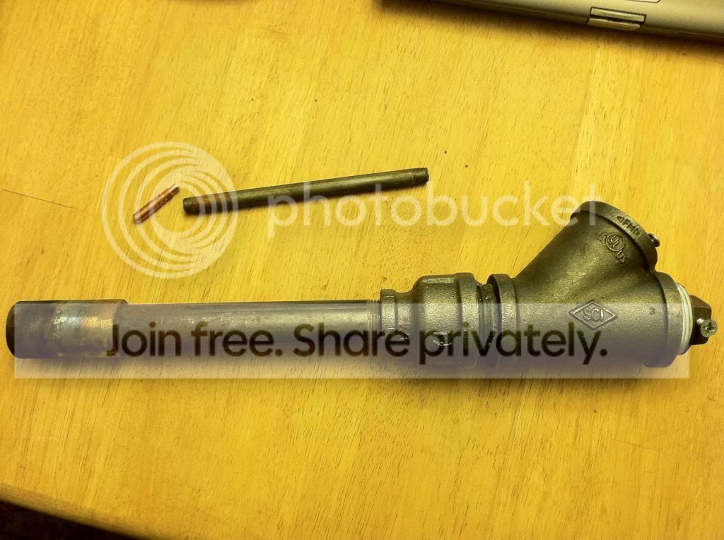

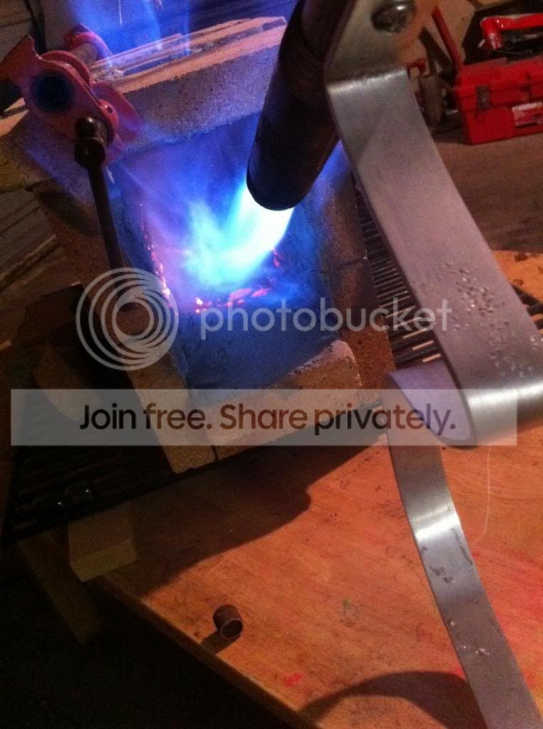

I built a propane forge that works pretty well on 3/16" thick 1095 steel, but its having a hard time heating up a long (takes up the full 19" length of my furnace) 1/4" thick 5160 blade. I decided to take a small mapp gas burner and throw some extra heat in, and it actually worked great. Gave it that little extra boost it needed to get it to non magnetic. Heres my problems.... First, how do I get it hotter as is? I have it vented in several places, should I close up the venting a little more? I played around some, but it didn't seem to make a difference. Secondly, when I used the mapp gas, it seemed to heat up one area of the blade a little more, causing some warpage. Its VERY slight, but I can see it. I had it in the oven tempering, and while still hot I tried bending it back. No way this stuff is budging! I am a fairly big guy, and I put a lot into trying to get it to bend back a little. It flexed quite a bit, but went right back to where it was. Do I need to get it hotter? I don't want to go too hot, as I am trying to keep the steel in the RC 58 to 60 range. Any suggestions? Thanks for reading.

When you put a piece of pipe in it, should the flame go into the pipe as well, or do you just let the heat build up around it? Otherwise, wouldn't the pipe insulate the blade from the flame and make it take longer to heat? As far as the burner, when I try to put it right up to the forge (I mean so the tip is literally right up to but not into it) it seems like the flame wants to sputter like its not getting enough oxygen. Does this mean I need more air (bigger holes) up by the nozzle? I think this may be why its not getting hot enough. The holes I made are (8) 1/4" holes in a piece of 3/4" sch 40 pipe. Should I make them bigger? I just don't want to screw it up and have to start over again. Also, I am using a .030" mig tip for the nozzle. Should I go bigger if I open up the air vent holes? Sorry for so many questions. Still learning.
Questions are good! You can't have too many. Let's see a picture of your burner design.
Sounds like a venturi type burner. If you aren't getting enough air then your design is suspect. Ideally you should HAVE to choke back the burner some or adjust the regulator lower.
Here's a link to Zoeller's how to on building a sidearm burner.
The stainless flare at the end doesn't HAVE to be stainless, but it will extend the life of the flare some. Without getting too technical, you can also "flare" where the burner enters the forge chamber to act as the flare...
What PSI regulator are you using? And what is it set at?

I don't think your burner is cutting it. A 1/4" hole has an area of .05 sq inches 8 of em is .4. The id of a 1" bell reducer is 1.5" for 1.75sq inches. Plus sucking through a funnel at the far end gives it some velocity. It takes a LOT of air to really cook. Sounds like you tried to copy a small propane burner. Won't work in a bigger forge (19") Your sputtering is O2 starvation. I highly doubt that more holes will work.
That burner you gave the link for is almost identical to mine. I have a 1" pipe slipped over 3/4" for the nozzle. Same length. Only difference is he uses a #57 drill, which is 50% larger then my .030" mig tip. Also, his design draws air in from behind the propane comes in, and mine has the holes drilled immediately after the propane. Maybe this is the problem. Heres a pic of my burner turned all the way up. Also a couple of pics of my forge. It shoots out a nice blue flame a good 30". Is this sub-par? And as far as where I position it in the forge, if I put it any closer, thats when it starts to sputter, like its going to blow out. Where its positioned now, it runs a very consistent flame, with no change in performance. OK Guys, now you have some pics. Tell me whats wrong. Please be kind!

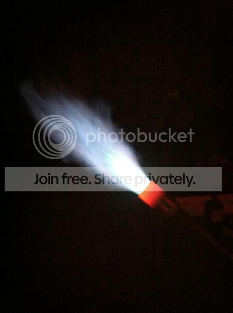

In the last pic, it was only running for about 30 seconds when I took the pic. Normally after a few minutes the whole inside is glowing.

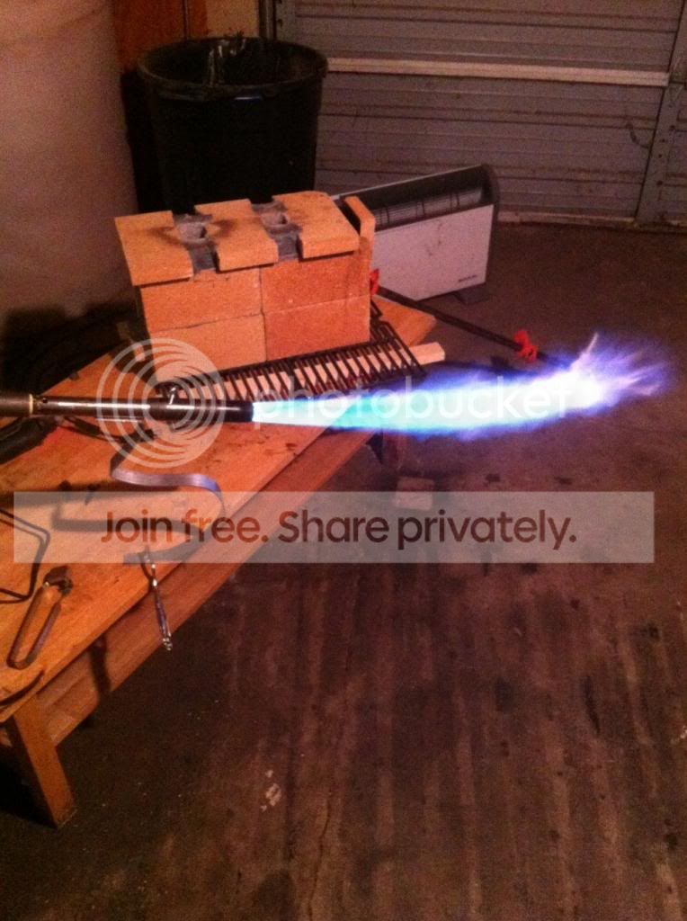

Here's this burner running. No extra air and the little forge could likely melt if we wanted it to......
It's an 1-1/4" fitting, I used a reducing coupling and a 6" 1/8" nipple so I could get the venturi to draw air in properly.

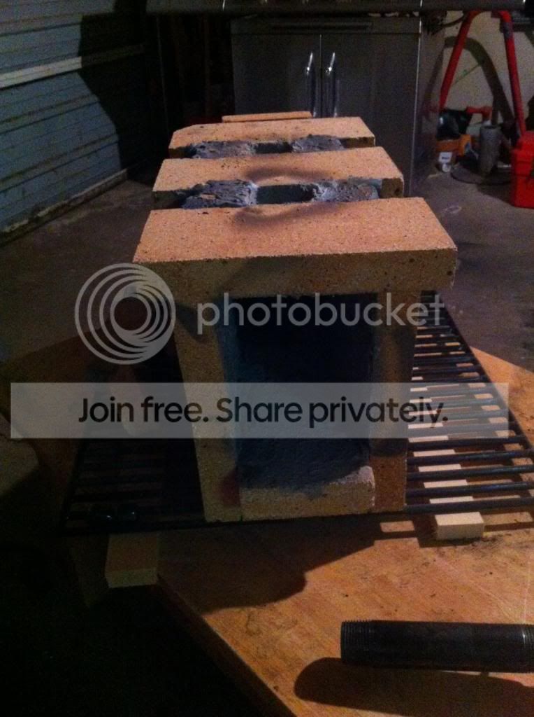

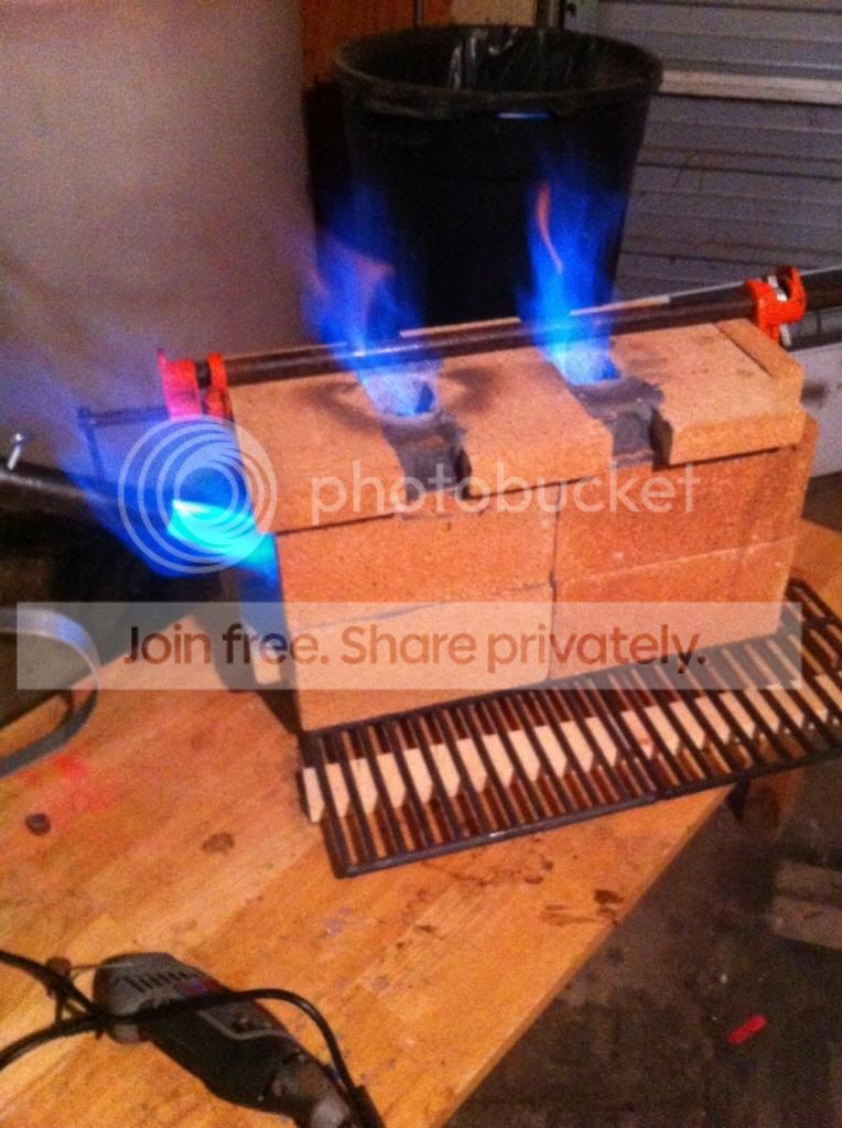

A couple things on your forge. Solid fire bricks soak up heat. The take awhile to come up to temp. So you would have to run your forge for fifteen, twenty, forty minutes to get it heated inside evenly.....
Then, the way you have it open with the burner in front, will basically never work right. :(
Your burner isn't getting enough air. When you say yours is like a Reil burner, it really isn't. :o No worries, easy to fix. :thumbup::thumbup:
http://ronreil.abana.org/design1.shtml
!-1/4" fitting, bushed to 3/4", add an 8" nipple and a 1" flare tube. I use 1" stainless that I ream on the pipe threader at work to a zeroish bevel.
If you have a regulator that runs up to 15PSI you should be fine. This one is a .030 tip running around 7PSI if I recall.

You flip your forge on it's side. Put the burner in the back "vent" hole that was on top, plug the second, line it with 1" Inswool and a light coat if refractory with an IR reflective coating you'd be ok. Honestly, get a freon tank from an HVAC company and line it with Inswool etc and you'd be set to start and then after using it you'll have a better idea of what you want.
Ya, you need the bell reducer on the end and the big opening to get enough air in there. He is also right on the hard bricks, they last for ever, but, take a long time to heat up, do not insulate as well as soft brick or Kaowool Another source for forge bodies is propane companies. They often have old propane bottles that can't be filled. I just got one for free from the place I get my propane. If the valve isn't out remove it, fill it with water and cut the top off with a grinder. I am going to use the one I have for a vertical forge.
