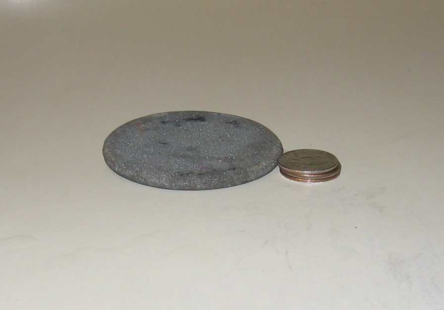

This is an old Norton round stone which I've owned for 40 years. It started out about 11/16" thick. It spent a couple decades in my tool bags and saw frequent use. I've worn it down to less than 1/4" but I've never broken it. It still has about half and half of the 2 grits. Now this slim light stone stays in my backpack for touch up on the trail. Before using it I always eyeball the surface and concentrate the work on any high spots. This keeps the stone level. I don't know of any other option for a great light weight stone like this except wearing one down. Get started now and you'll have one in 40 years. :D
Hahaha--I do have some plans of eventually releasing a single-grit Arctic Fox puck in a slim build about 1/2" thick, but nothing quite that slim and not in a dual grit! Hard to do dual grit that skinny without making it oversized and then cutting it down to dimension because of the tension caused between the grits different shrinkage rates during firing--they'd all crack if you tried to make them that thin out of the mold.
